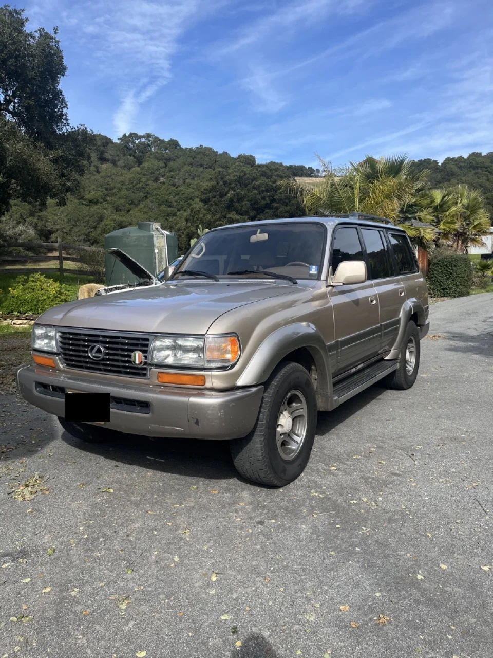

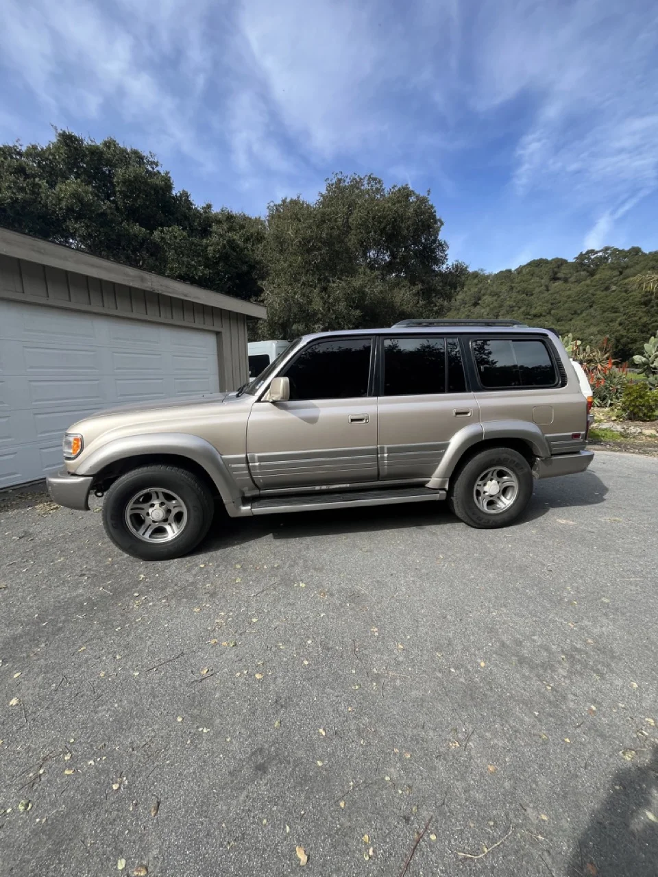

Hey Y'all -
First time posting here.
I am at best an amateur mechanic. Currently mostly-rebuilding a gm 2.8 V6 in an 89 Isuzu Trooper. Wife and I decided to pick up a bigger rig that we can keep as our family grows so we pulled the trigger on this 1997 LX 450. She has 180k miles has a new-ish radiator, had an ECU replaced about 50k miles ago (due to some wire fire on the PCV i think?) and has been a 1 Family vehicle for its life although CarFax says it was an auction vehicle at 56k miles from a Corporate Fleet in 2001 - not sure if that was some tax maneuvering though bc it doesn't show as a seperate owner... Also the valve cover seals have been replaced twice, most recent one in 2019 i believe 10k-ish miles ago. Grandma passed down to daughter, daughter to son, son to me. It seems like its sat quite a bit - as its only been driven 17k miles in 7 years. I paid 10k which was less than asking and seems like a good deal, assuming nothing blows up on me in the immediate future.
There werent a ton of records with the car so I have been trying to track them down. Immediately finding out if a Timing Belt has been done is on my radar. What else should I be looking for? Fluids look good to the naked eye, definitely some signs of a leak at some point - I am guessing the valve covers just never cleaned up off of the skid plate. No weird sounds that I am aware of, mostly just electrical gremlins (sunroof, slow window motors, N + D lights not working, antannae not moving, rear Drivers side door not responding to lock button) and and a squeaking passenger side rear bearing I believe (static bounce test on the rear of the truck didnt bring any squeaks). Tranny fluid is clean and no signs of water or particulate. PO says oil was changed every 10k miles.
Would love to hear thoughts and or questions I should ask myself. Looking to own this thing for a long time and would love to do a lot of it myself!
Thanks for your time! I will get some more detail shots soon!

Don't be afraid of it. Mechanically it's relativly simple; big heavy duty parts. Most fastners are easy to get to.
There are a few difficult to source parts but nothing too serious.
Please download the factory service manuals, mechanical and wiring. The crew here can help you ( and me too) through the rest.
If you can swing a wrench and follow the manual you can work on it.

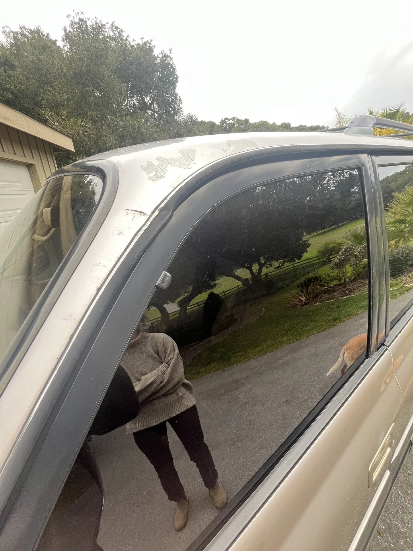

Well, I've got the first unfortunate news. We've been having a lot of rain in the central coast of CA (really the whole coast) and last nights deluge proved that we have a roof leak somewhere on the vehicle. I read other's saying it was their windshield in the past.

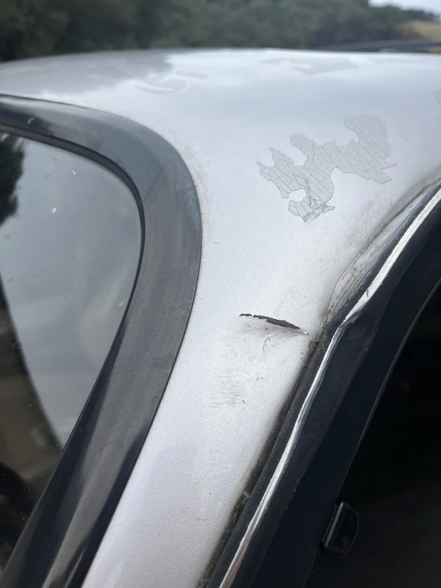

The gutter on the driver's side has a small dent in it from a previous accident and it is a bit bent. Doesn't seem to be from the sunroof. I would be content to say its the gutter but tests have been inconclusive so far and also the passenger side is wet, albeit not nearly as wet as the driver side. Both are soaked mostly on the exterior sides of the floormat, but the driver is by far the worst.
Guess some of the price I negotiated down will be going to some fixes real soon!

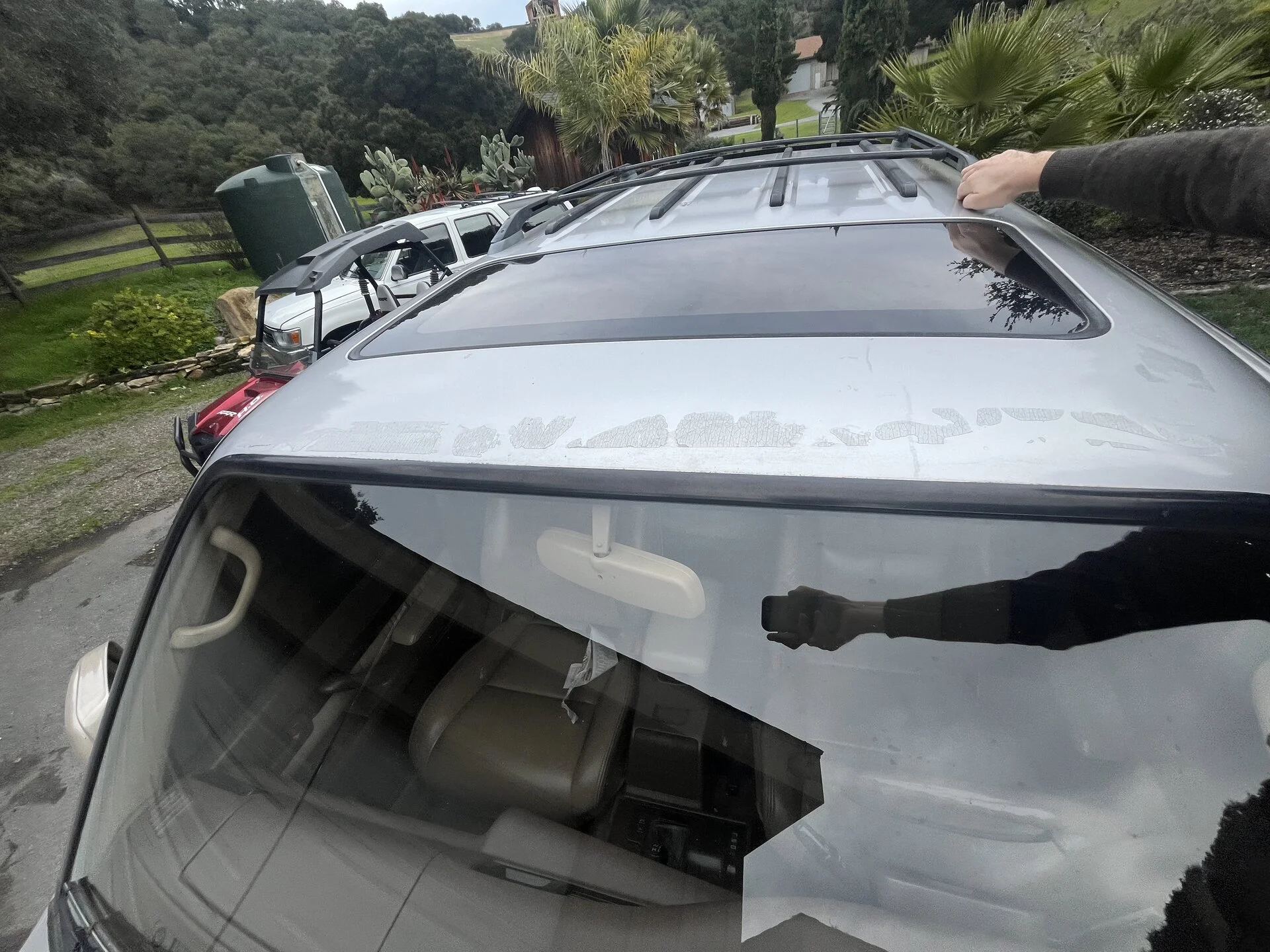

Here some shots of the windshield and gutter. To my eyes, the coping looks quite good on the windshield. Definitely not psyched on the dent on the a pillar. Luckily it isnt worse but itll need some attention. Any recs there?

Odd looking residue around the sun roof. Like duct tape that was there and removed?
A couple of leading causes for wet front floor mats are:
- non-Toyota method for windshield replacement. It's a whole thing with method and adhesive that is different from the usual.
- plugged drains underneath the sun roof. Tubes go down the A-pillar and can get plugged with dust turned to mud. The roof was not made to be water tight, but to drain any water that came in. That was >25 years ago. Weed whacker line can clean these out.
I used Shin Etsu "40 series" grease around the sunroof seal. Open the roof partially. Rub the silicone grease on the seal and the frame. Close the roof and rub some more on top of the seam where the slider and roof meet. Held through a few inches of rain here for the past 5 months. Not a "root cause" solution but cheap and easy.
Others have installed a very large flex magnetic sheet over the whole sunroof to block water. Some have tried a large "rubber band" style gasket-helper to fill in the gap with mixed results. I don't have a part number for this.
Spousal unit arms crossed in the reflection is not a good look.🙄 Been there, got that look. Best of luck.

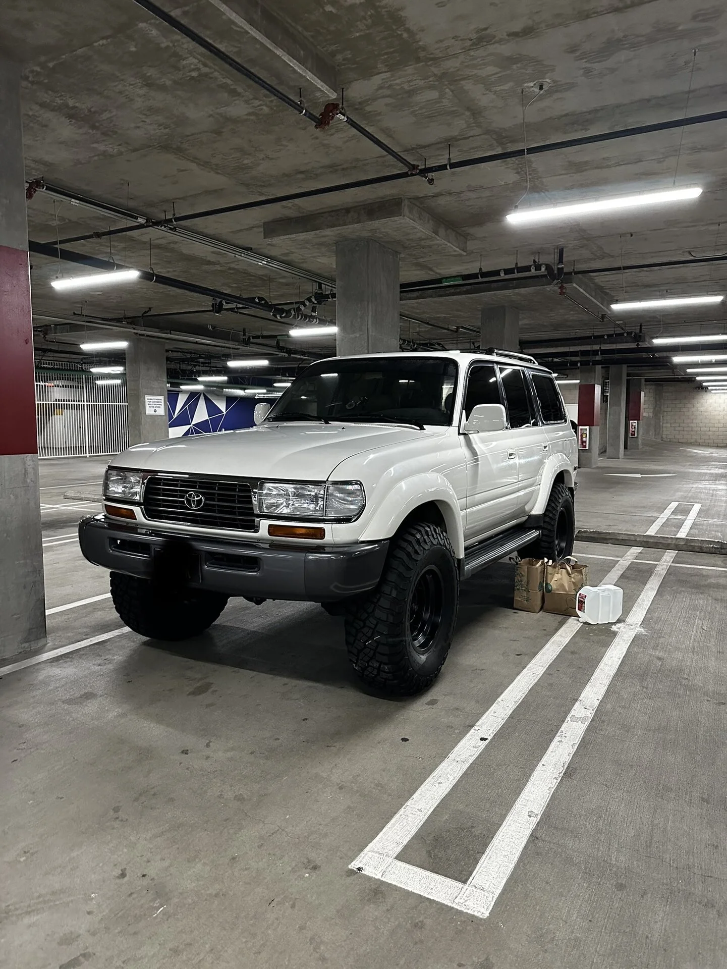

Nice sharp looking rig. Do you mind sharing what you have for the tires and rims on your rig?

37s and KMC Terras.
That windshield def isn’t original. There may be rust underneath the seal.
Good looking truck. No timing belt on that one.

Ha! Was wondering if anyone would catch that.
Unfortunately the roof does not open, only tilts, which is another problem I would like to fix. I figured it was just the motor but upon researching seems like a lot of folks show clogged "pipes" from the grease hardening? Wondering if that's the consensus problem here.
Was also wondering if it is possible to manually open the sunroof. Saw some similar year other lexus models with very similar sunroofs able to hand crank the roof open, which I gave a go but found that it did not exactly line up. Looking for pointers here. Would love to clean these gutters to determine if it is the problem behind the leak (I am guessing it is).
Regarding the duct tape residue - that's my guess as well. Was wondering if someone put some sort of aftermarket wind-deflector. Need to clean that up for sure.
