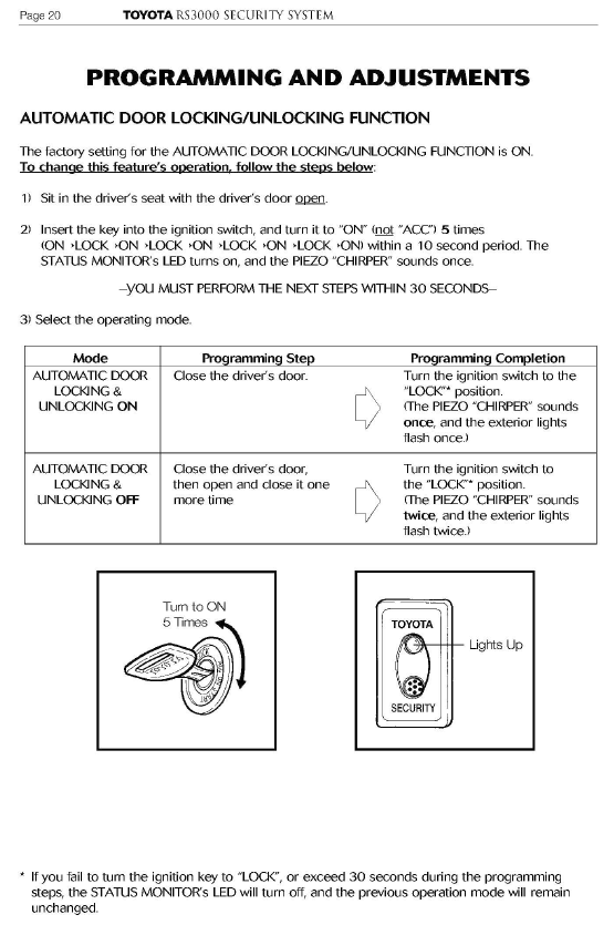

The factory preset of the RS3000 alarm is to auto lock the doors when all doors are closed and the ignition is switched to ON. Page 20 of the RS3000 manual tells you how to disable this feature. You can download the manual from the resources section.
I assume you mean something different is happening??
