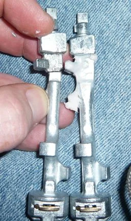

In a nutshell I drilled into each end inserted a roll pin in, then metal epoxied it all together.
Waited a day gave it a light filing then threw it back in and it lasted the six weeks it took to get just the rod from the United Kingdom.
I still have it in the back of the Landcruiser and I can have the whole assy changed in about 25 minutes.
If i find where I put it in the landcruiser I will post a pic of the repaired rod.

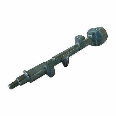

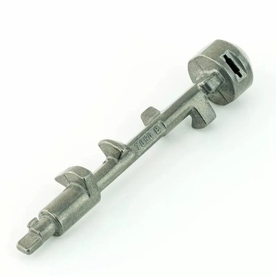

Ignition rod broke on the 1999 Land cruiser. Having trouble locating the part number says 7850 B, which of course the dealer says partial part and has to sell the while cylinder. Anyone know where I can purchase?
Just ordered one.....because you KNOW at some point you're going to need it.

Is a new part an improved part?
Yes, several ppl have reported the new part to be much stronger. Mine was changed a few years ago, before I bought the truck a few it has been solid so far!
