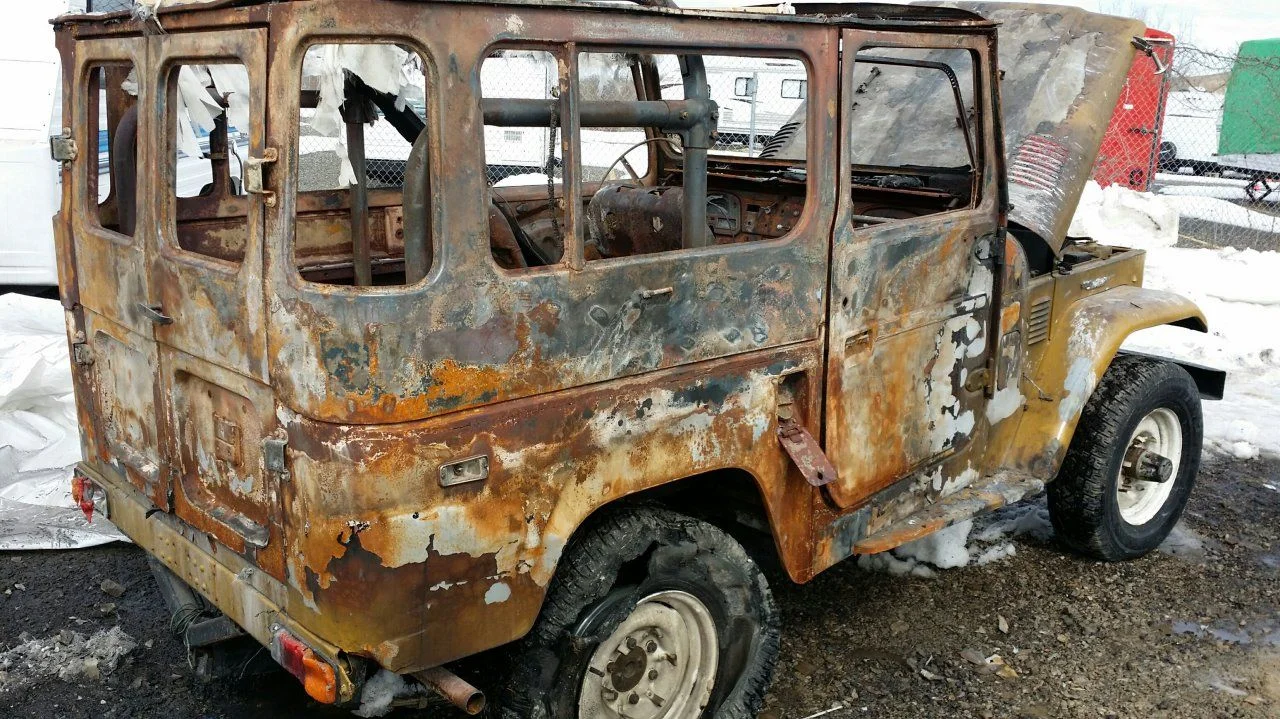

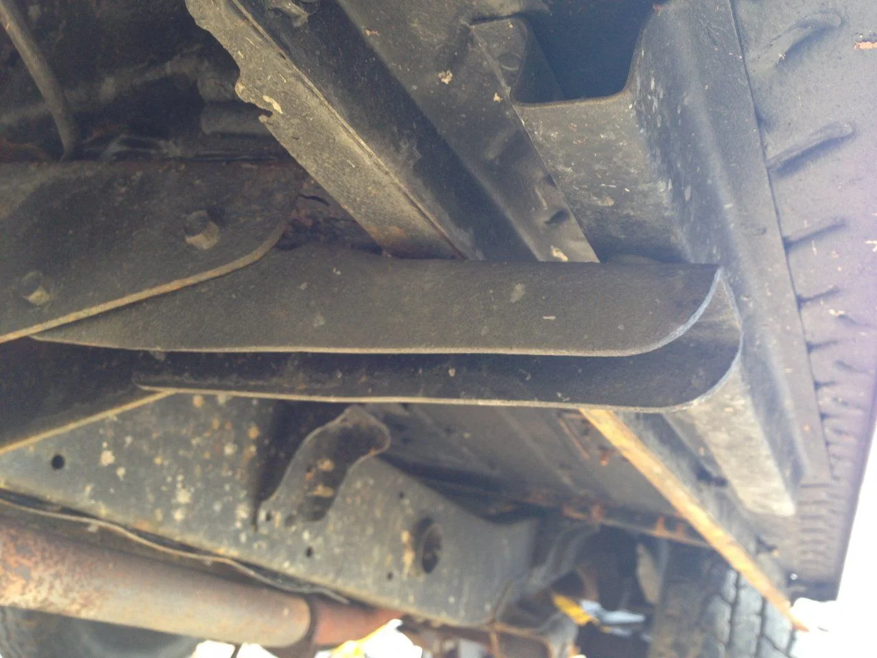

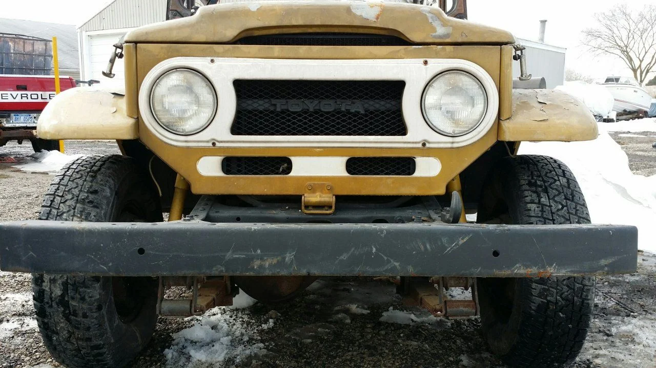

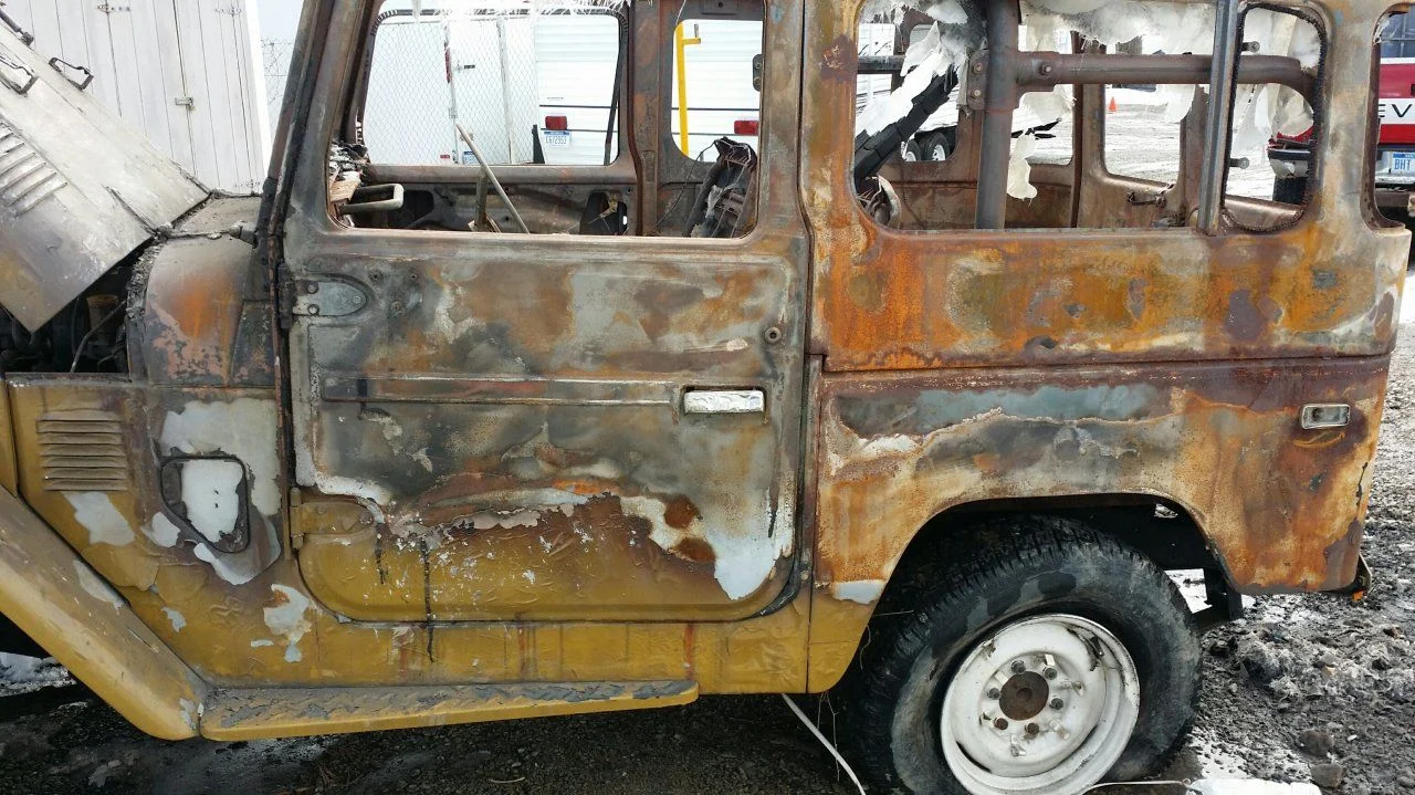

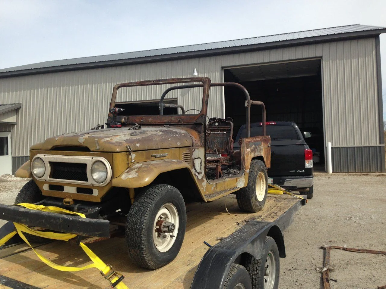

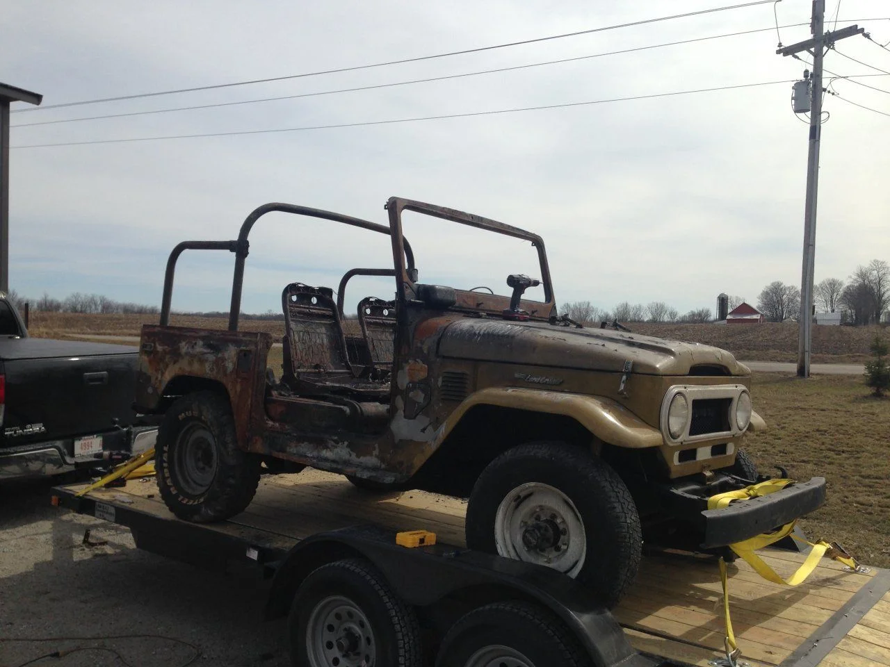

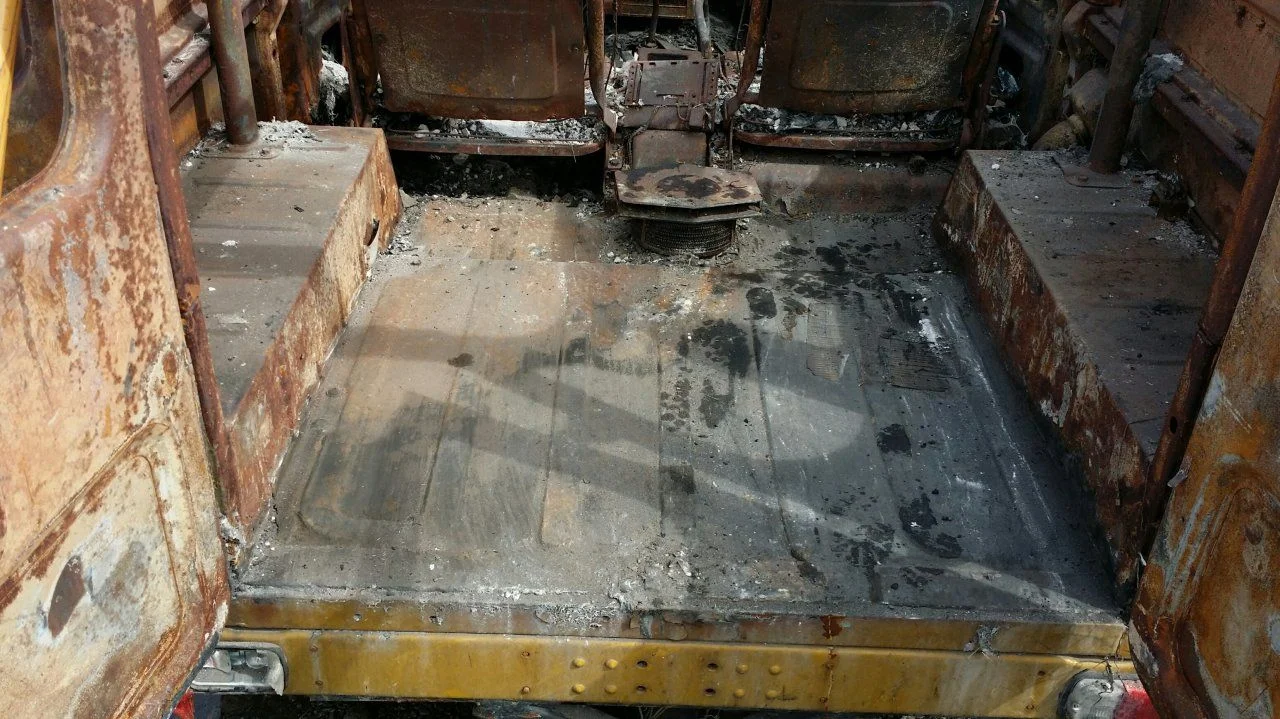

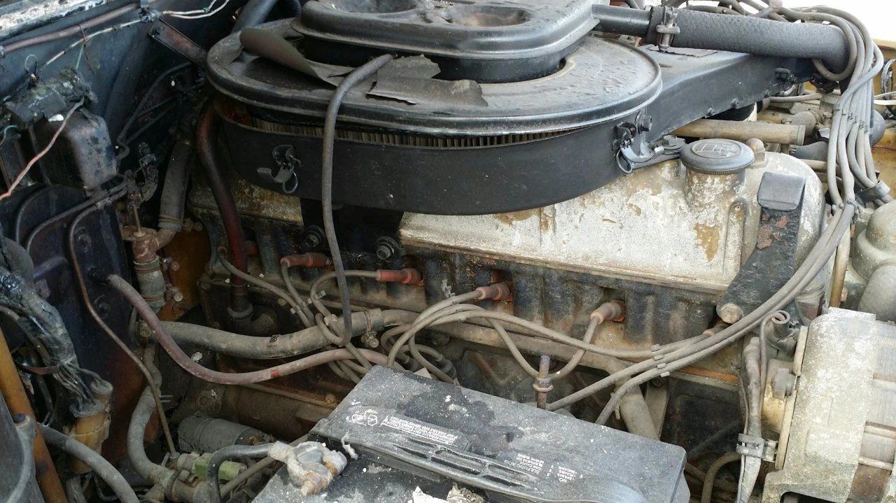

I found a FJ40 for sale on craigslist. The guy said it was in a barn fire and needed a few things. It turned out that is needed a lot more than just a few things! Like many of you I do not like to see these rigs getting parted out. I see the potential in all of them regardless of their condition. This is the start of my project and in a month or 2 you will all be surprised at the transformation.
First photos from when I went to see it.

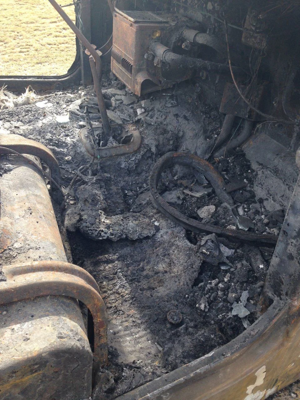

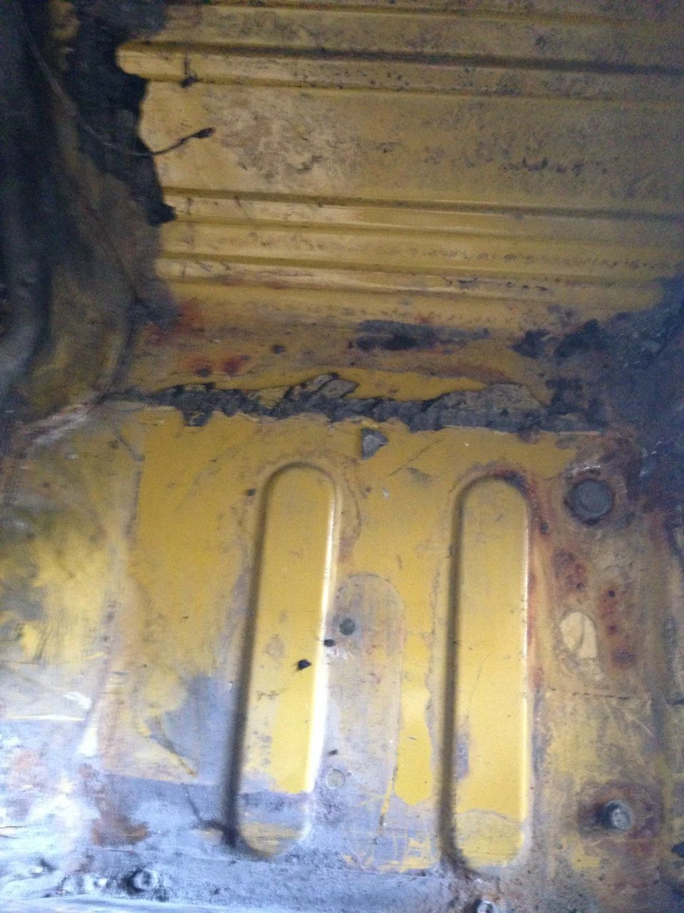

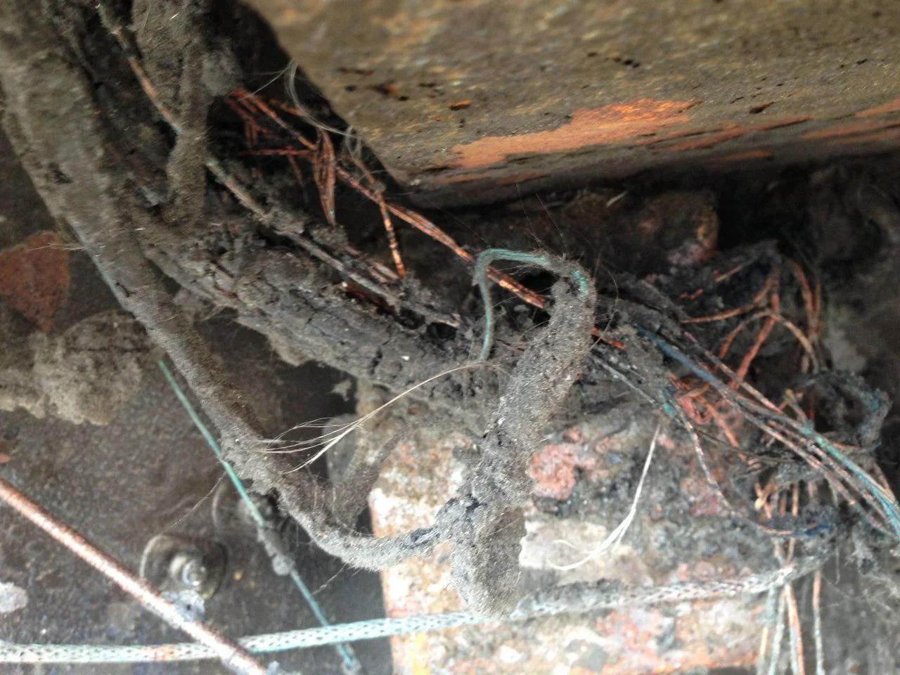

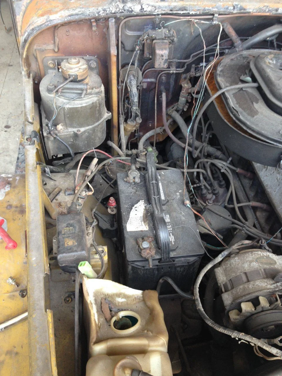

I was told the barn burned and the FJ40 was inside of it. After a closer inspection I realized why the barn burned. It was this FJ40 that must have had an electrical fire and burned the barn. It didn't really make a difference because at this point I was going to take on the project regardless of the reason it looks so bad. Anyone else would have probably parted it out and moved on.
After cleaning it up a bit I noticed that the tub had the rear quarter panels replaced before and some poor body work so at this point I was too far in to stop.

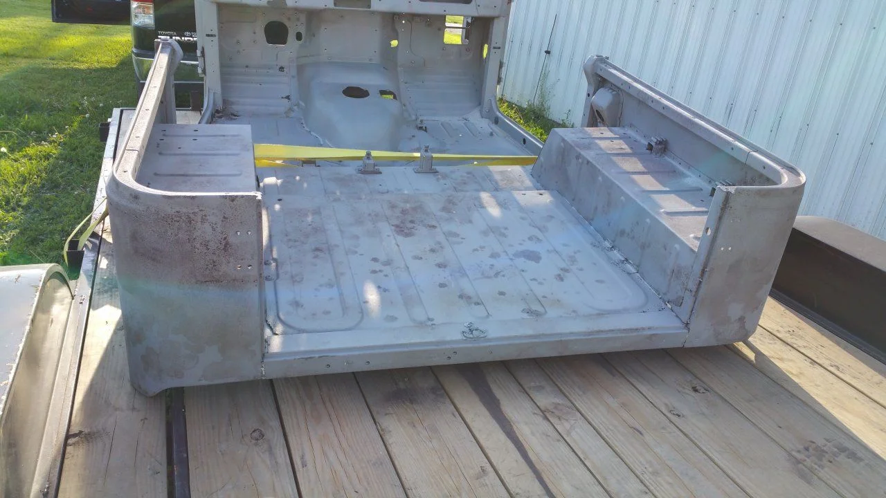

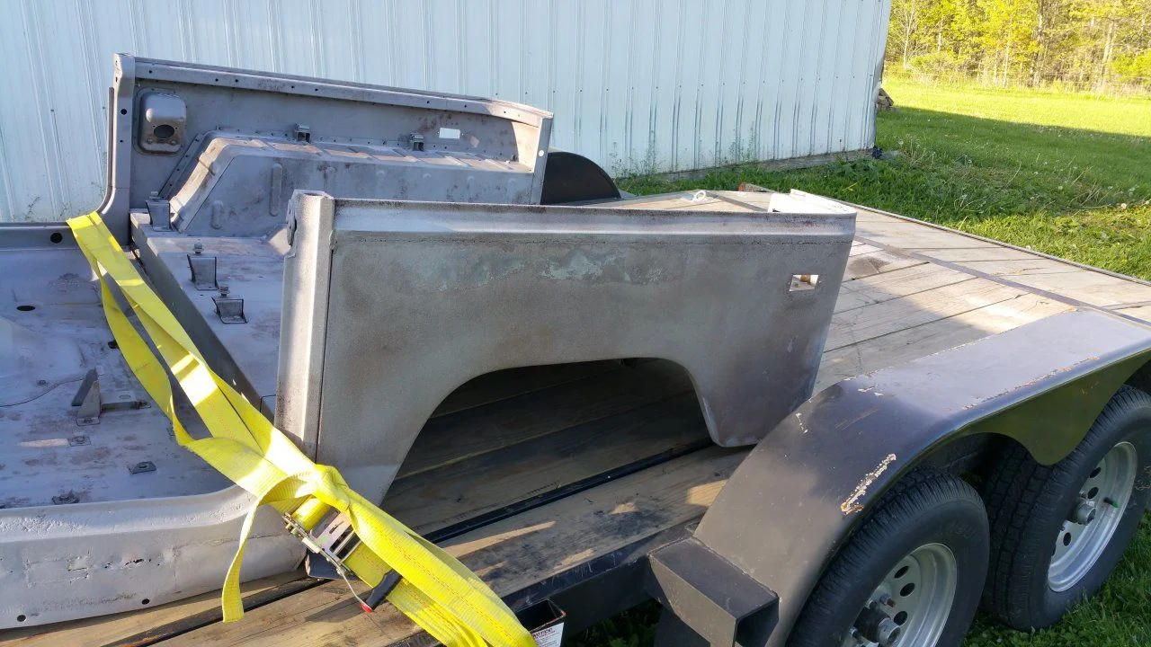

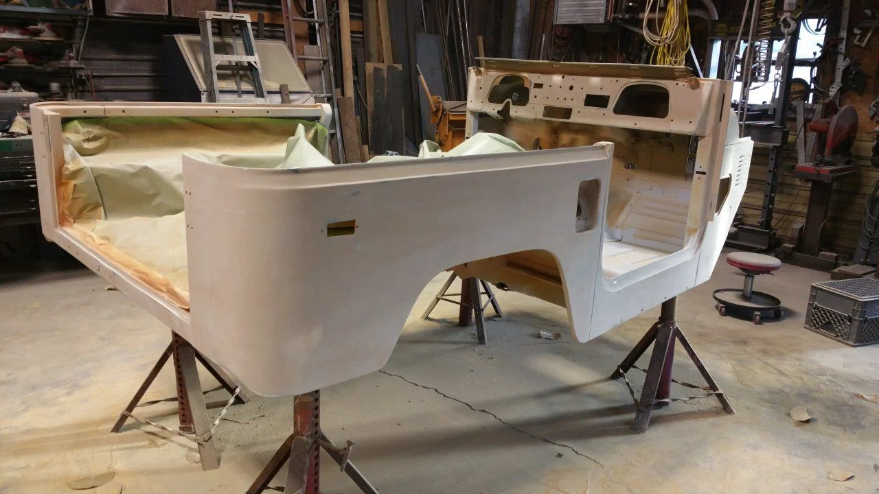

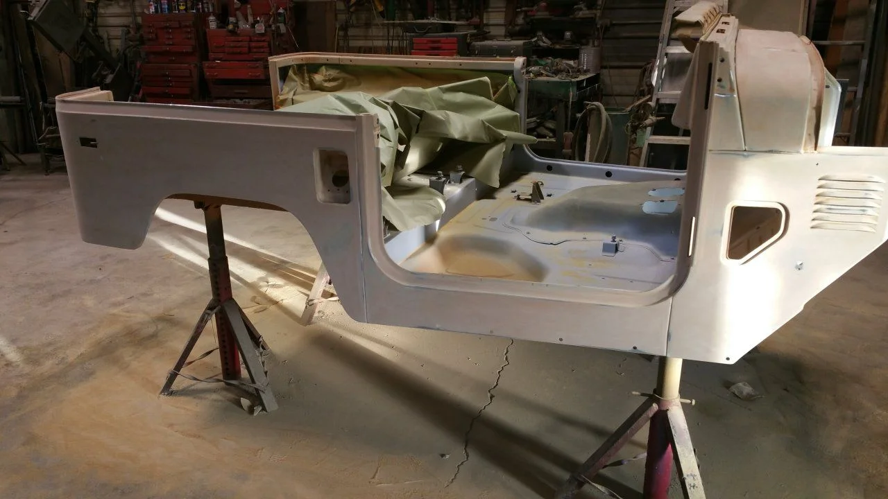

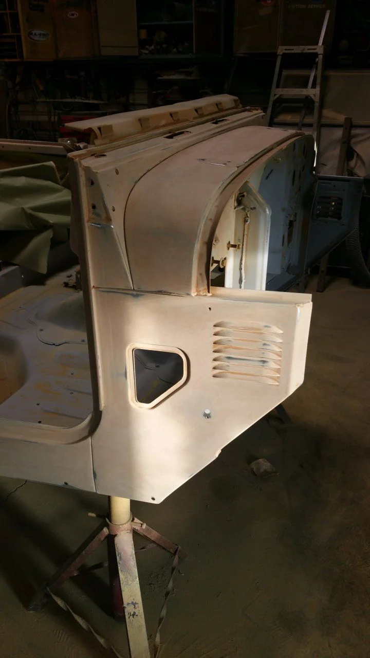

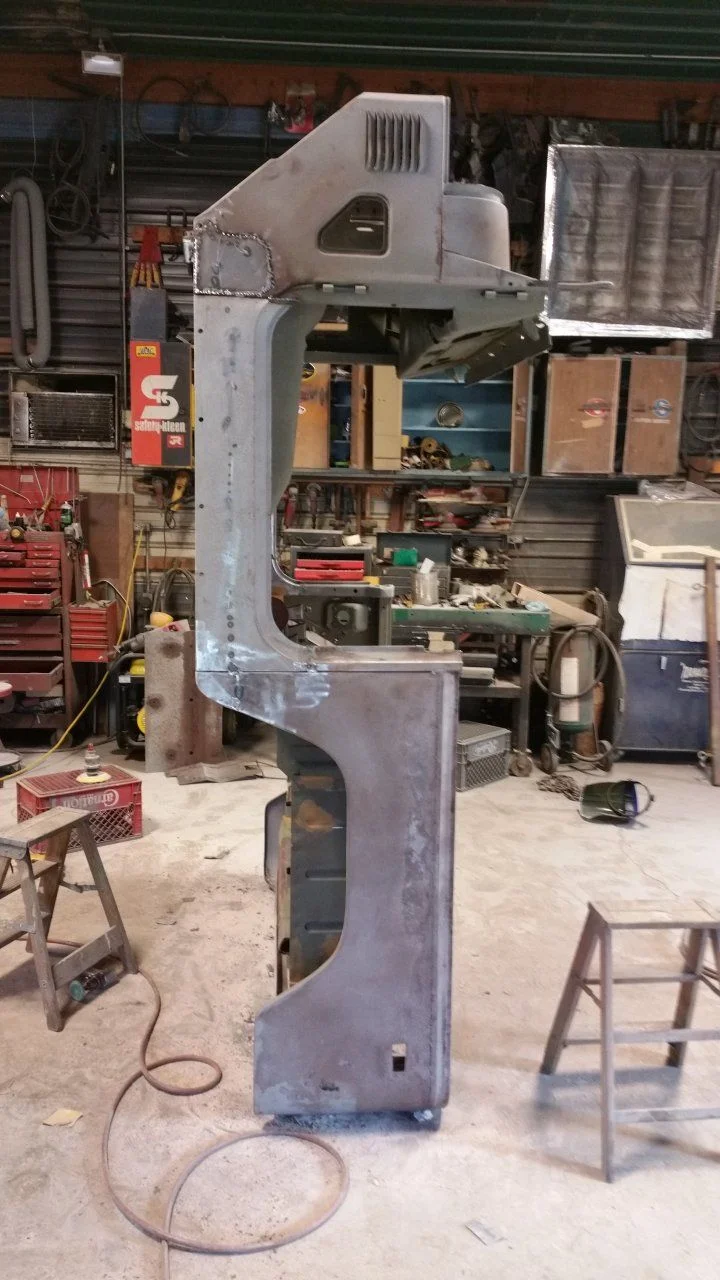

Body off and sand blasted. Now I can start to see what needs repaired. The rocker panels are shot. The quarter panels had been replaced before, however were not welded on correctly. There are also a few small rust spots in the floor of the tub. The good news is now my wife can see some potential as well and no longer thinks I am crazy.

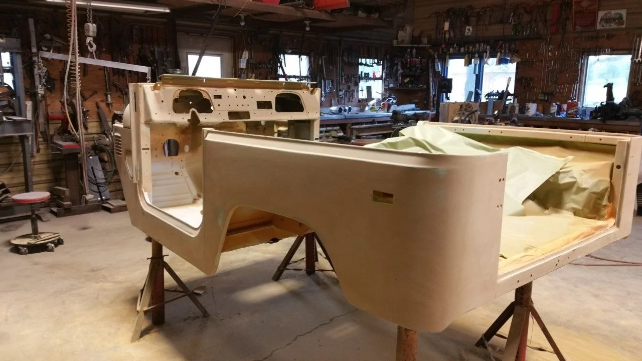

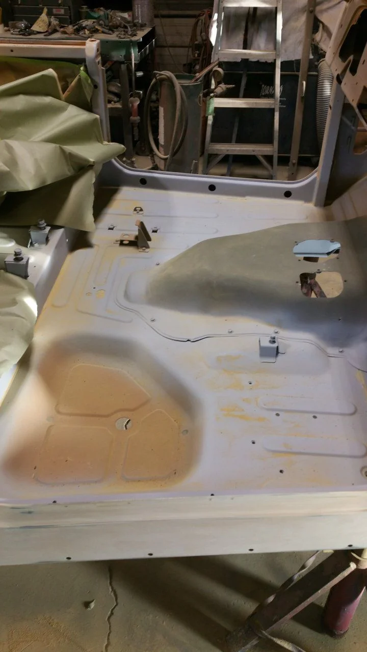

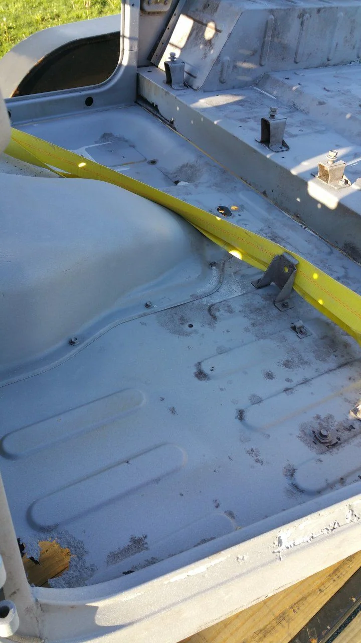

The few rust spots are now cut out and replaced. I also had a set of new old stock factory rocker panels hanging in the garage that I used. They were neat because they were the inner and outer panels as well as the b pillar all in one piece. Those are welded in and the body is in its first of a few primer coats now.
Tub metal work is complete and I have the first coat of primer on it. A few more coats of primer and I will be ready for paint. Hopefully I will have the tub pained in the next few weeks.
