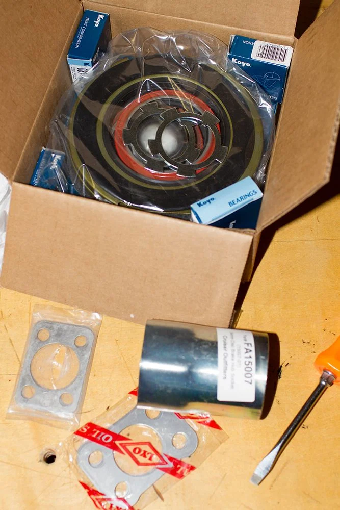

Cool - my own custom seal tool - can you autograph it :)! Ordered the socket and complete kit (Koyo's) from Kurt today. Nice guy and always helpful. Thanks and drive safe.
knuckle kit from Kurt - FA7590KWB

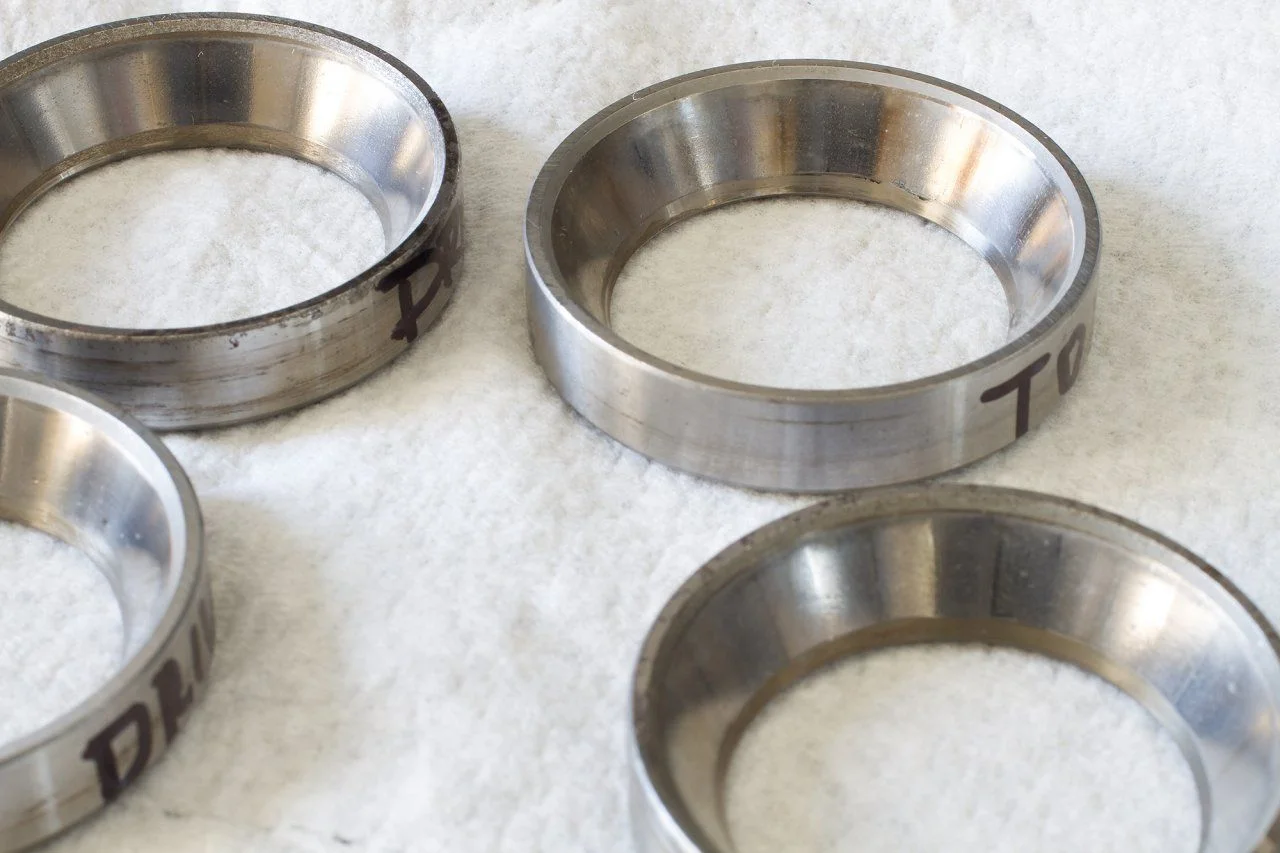

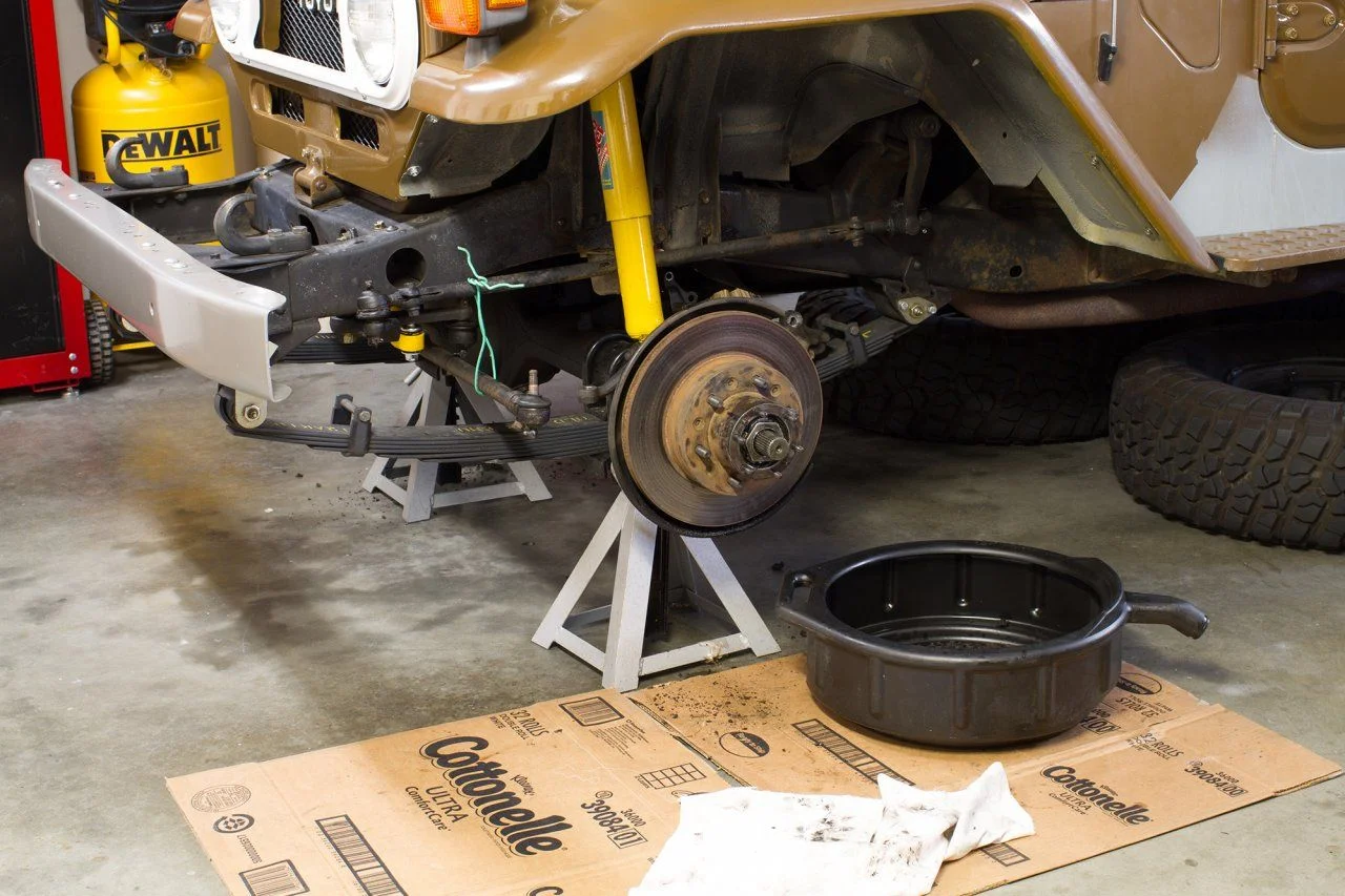

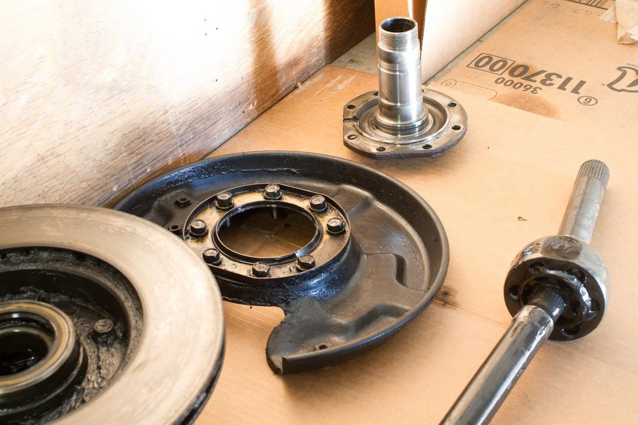

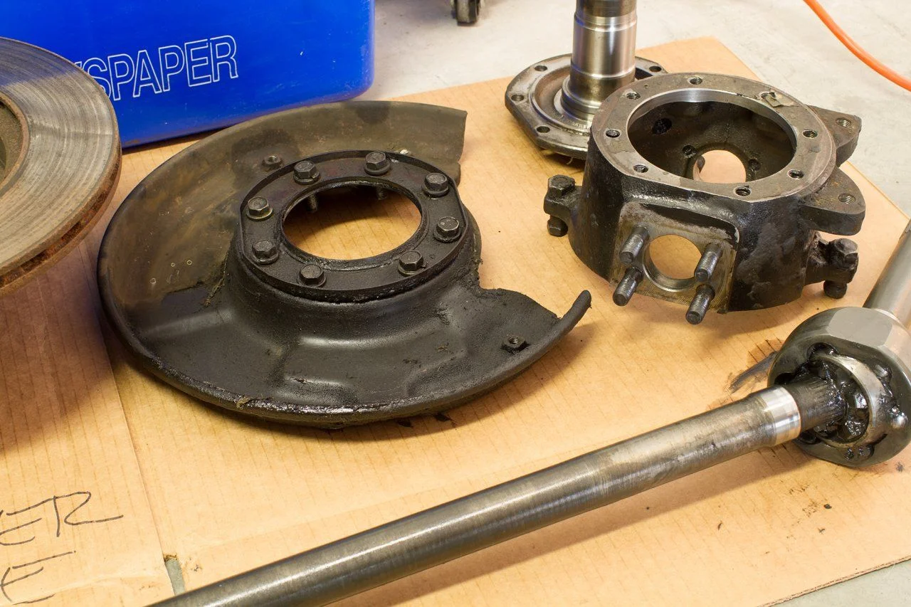

Got going with tearing things down and getting grease everywhere. One thing I noticed on the passenger-side (the side with the bad leak) is a definite worn spot is the bearing action when the wheels hit the straight ahead area – things are smoother on the driver’s side. Makes me happy cause it looks like the knuckle job/new bearings may improve handling on the road.
This is something miker and kiwidog told me about early on with my original steering problems.
When you remove the trunnions and get a look at the bearing races, I think you will be amazed to see what kind of wear pattern you find! When I did this same job many years ago, I had pretty deep grooves in the race where each bearing roller was located...no wonder it liked going straight but fought me on the turns....:doh:
PS: keep track of the shims on the top and the bottom trunnion...odds are you can just put new ones in of the same thickness and come out pretty well centered at the end of the job.
Cheers!

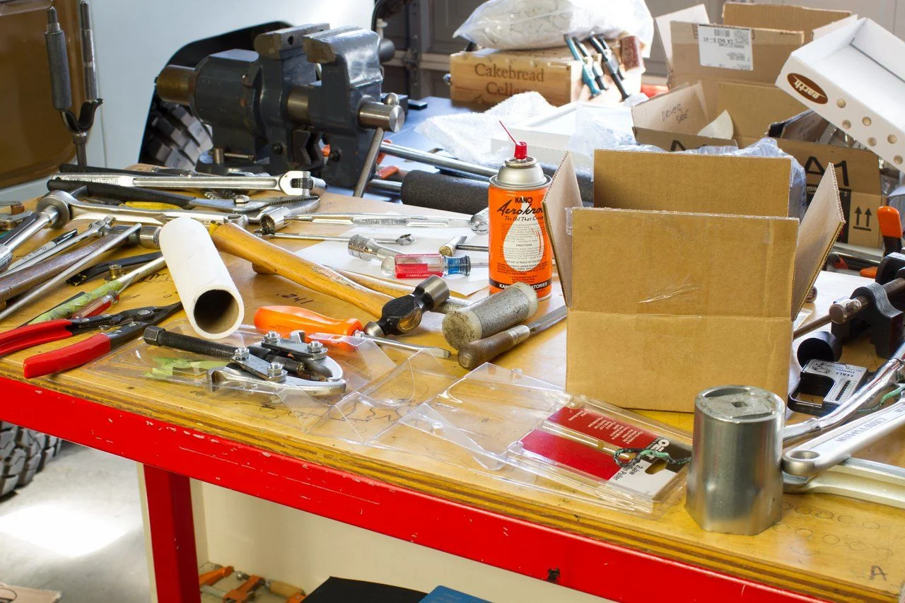

Those are still the old races... good point Eddy, I should have taken a few shots of the big grease/rag filled shopping bags (that the local Shell station is now the proud owner of). Plus my tools are getting all dirty... :)
Hard to photograph these and show the wear. Two on the right are the really leaky side, with the big flat spot in the action. Maybe not bad considering how old they are?
Oh yes! those races are definitely ready for the round file(trash bin). It's no wonder you were having some steering issues :doh: I hope you are going to install Marlin's inner seals in the knuckles. They are really the best out there. Have had mine for a long time and not a drip in sight!
