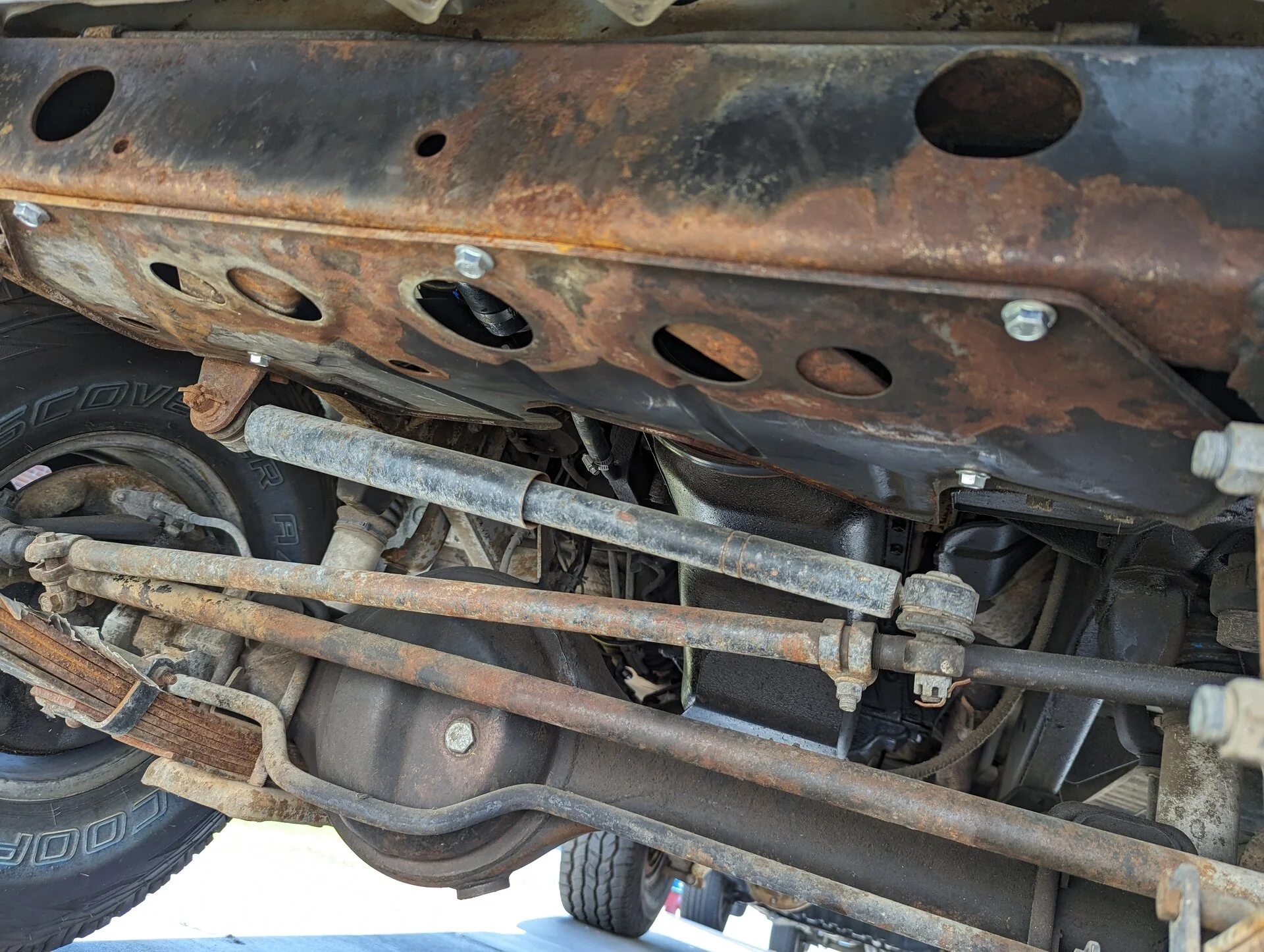

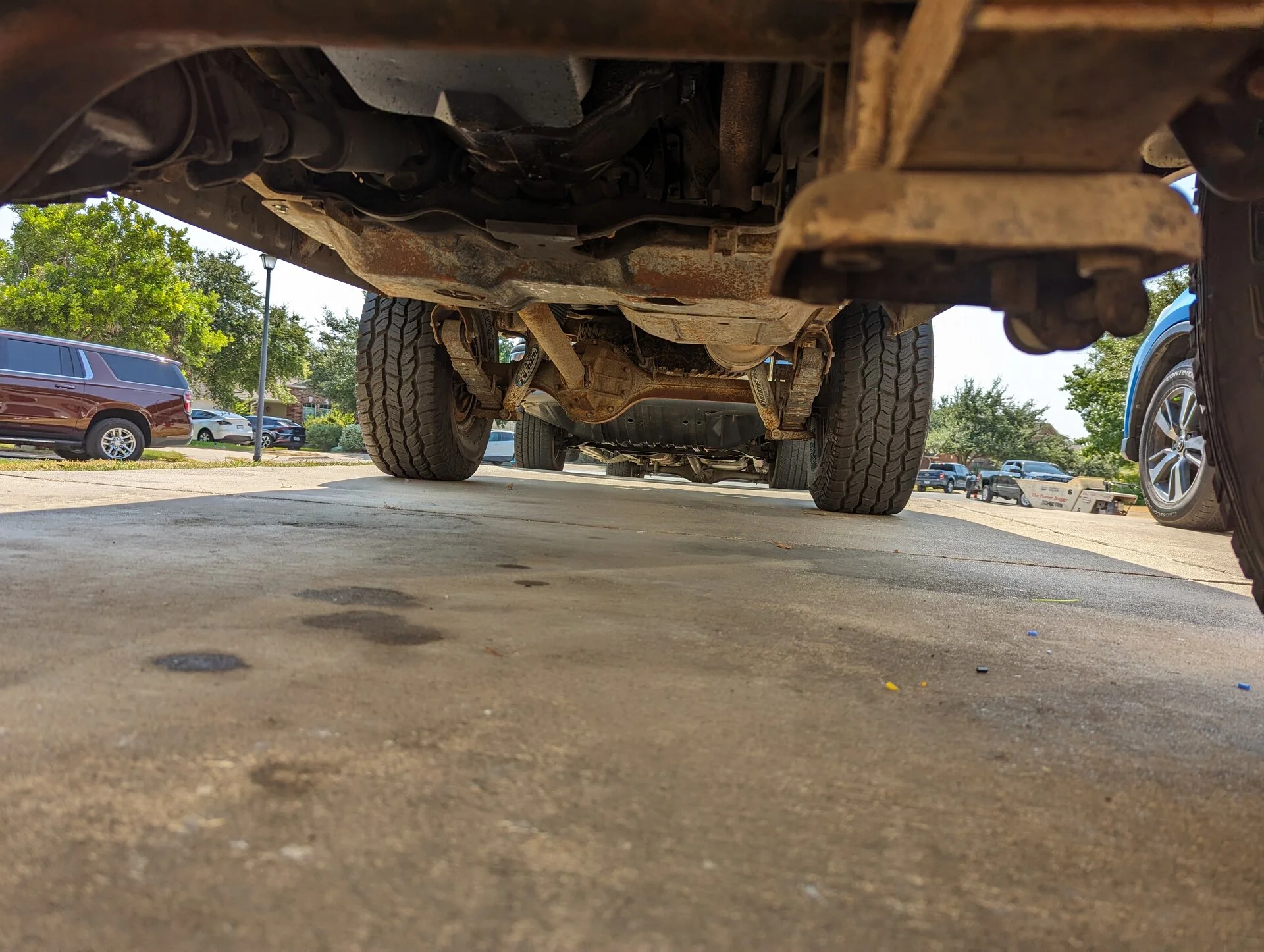

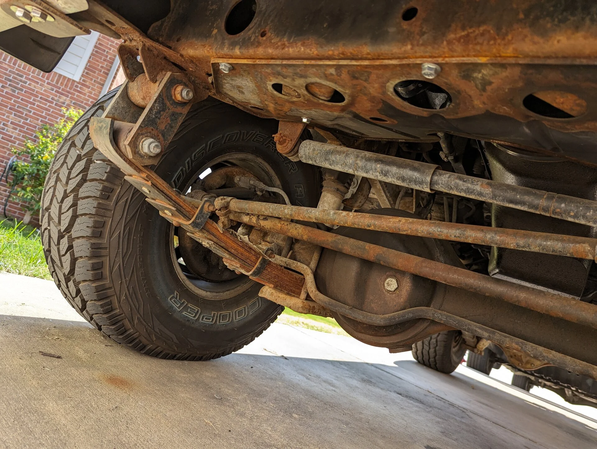

Pic cruiser to see lift to ID height, plus it's a pic of a cruiser.

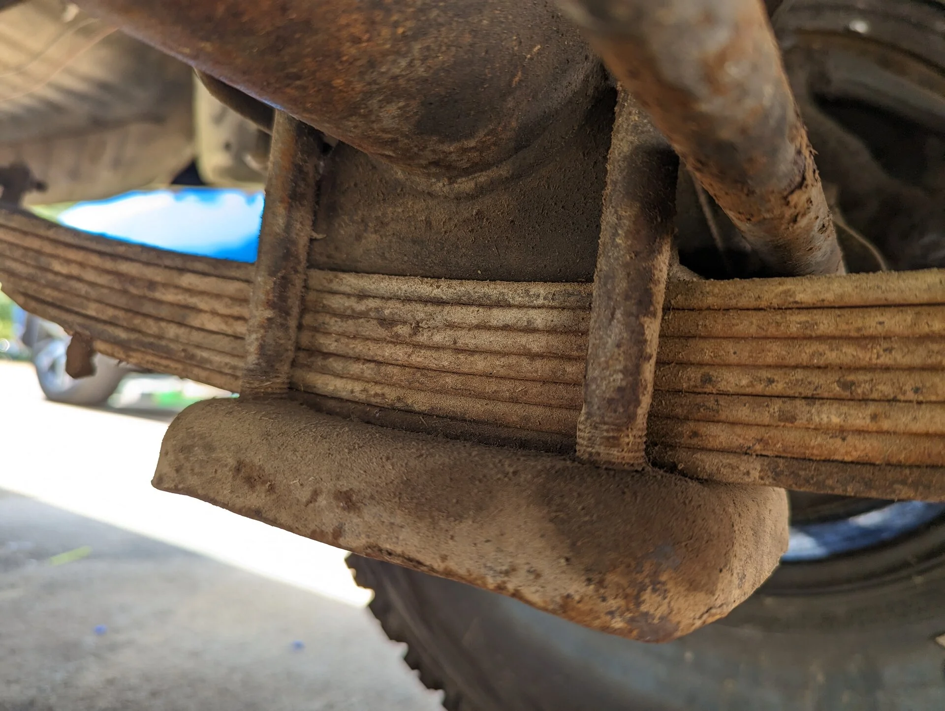

how about some actual good pictures of your suspension

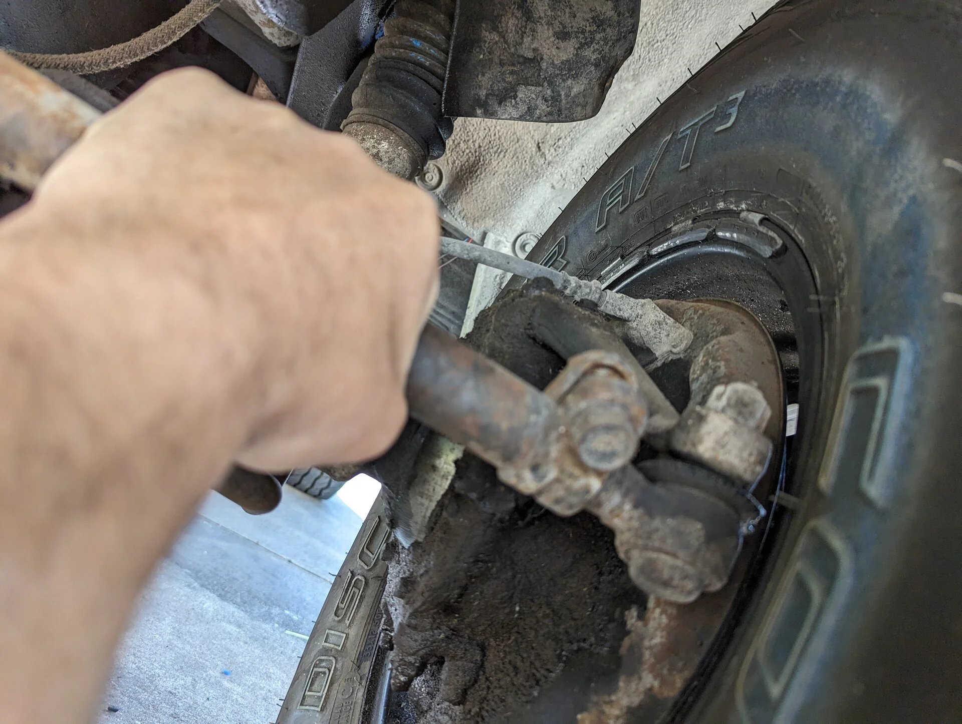

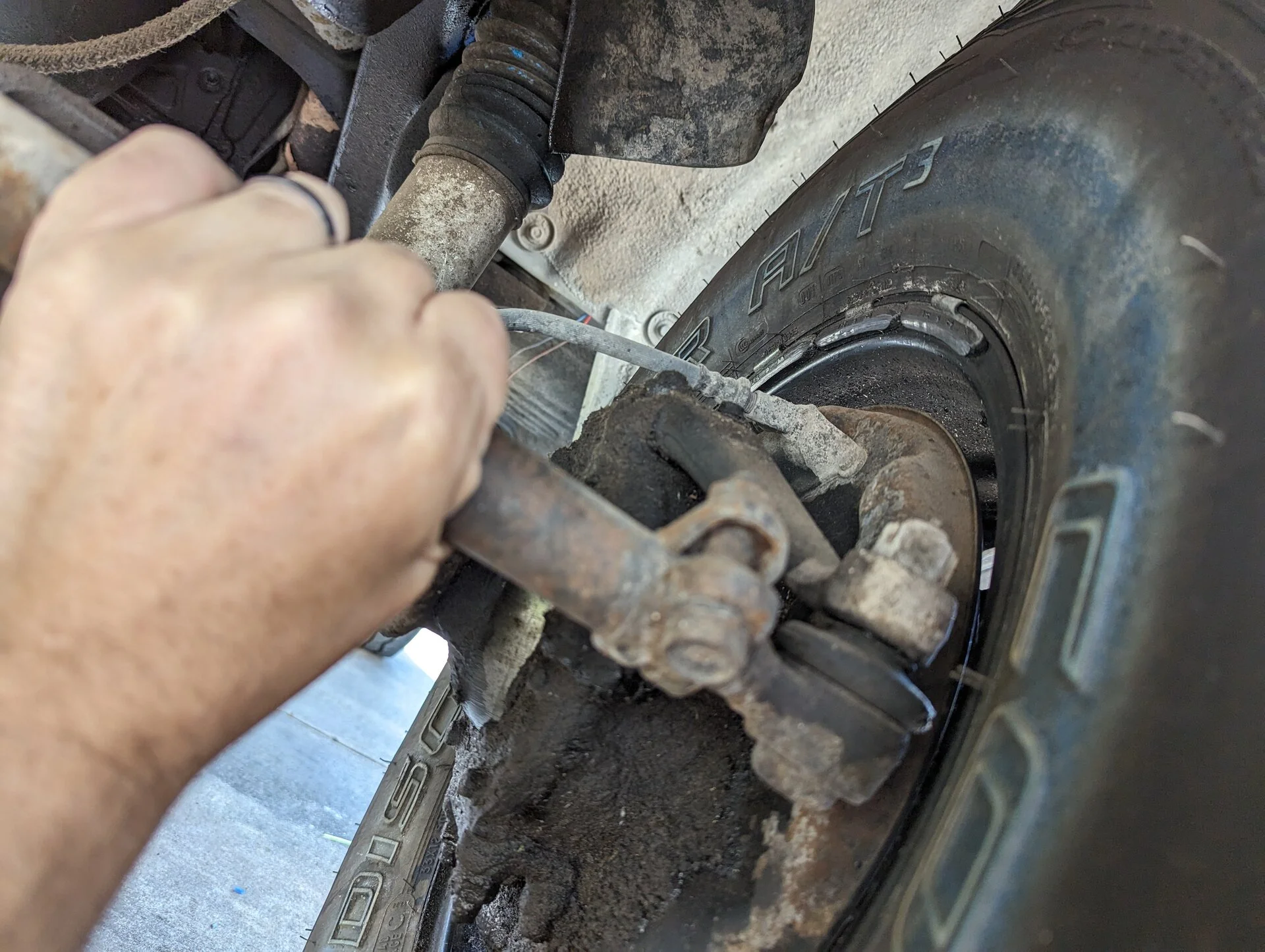

Correction, there is a TINY bit of rotation on the part connected to the pittman arm in this pic, but just a couple degrees . (Drag Link?)
This is the only part that significantly moved when I grabbed on it. pic is twisting up.

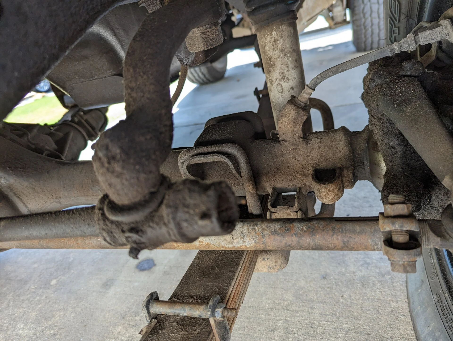

This is how much it moved total, pic is twisting down.
Looks like thats on a ball type joint, but I have no idea how much it's supposed to move.

Spring bushings, sound like a good place to start, who makes the best? OME?

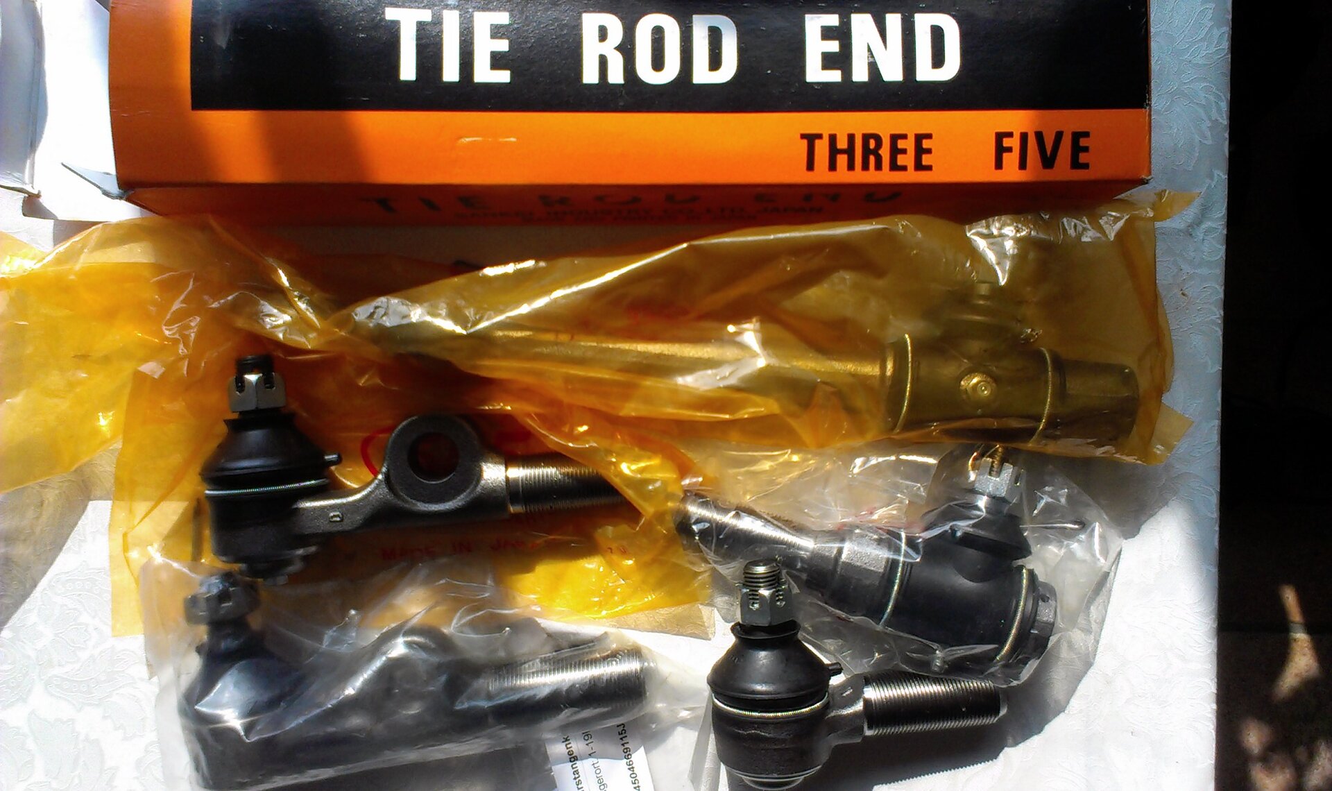

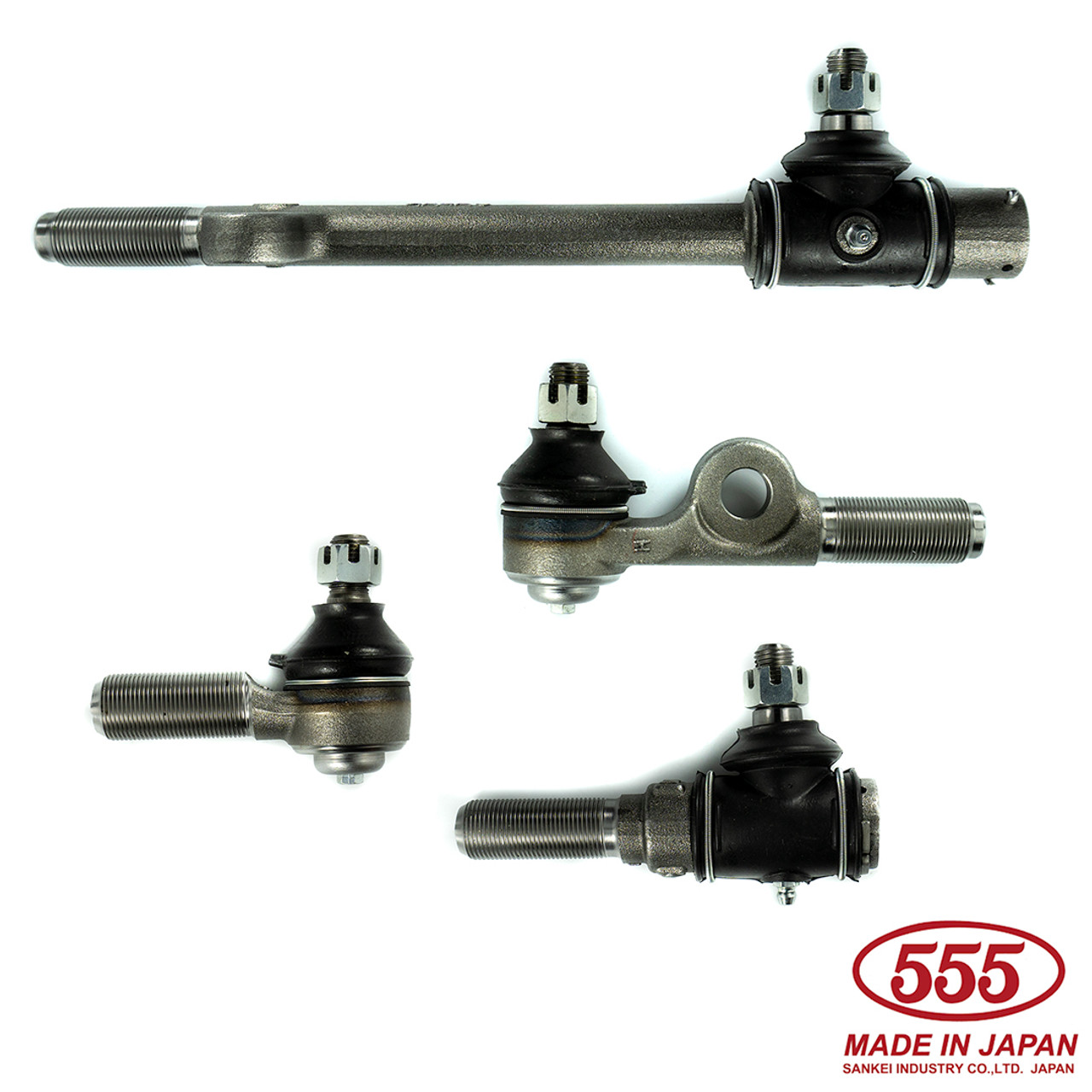

Are the best tie rod ends the 555 ones, or are OEM still avaialble?

-spring bushings
-u bolts

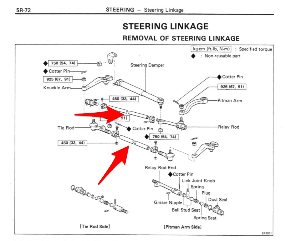

"replace both steering linkages and ends"
Does this mean all 4 ends, or all 4 ends, plus both drag line and tie rod tubes?
I would just replace the whole things. It is generally not worth the time to try and re-use the tubes when the new ones are <$100 each
A brand new stock FJ60 rolling off the factory floor in Japan only had about 1/2” down travel in the front until the bump stops hit. It also had negligible bump steer.
The reason for bump steer is the geometry of the steering gear: the higher the suspension is lifted, the worse the bump steer gets because the tie rod tubes angle up higher.
Look under your vehicle and see for yourself. Your tubes are not horizontal-ish. When the springs compress on a bump, the tube angle gets more horizontal — which pushes your pitman arm on the steering gearbox - which jerks the steering wheel.
There’s no way to prevent it on a lifted vehicle. A steering stabilizer just hampers the articulation of the suspension.
So is a drop pitman arm the soloution?
Hi steer?
I read the drag link is supposed to be parallel to the axle, and it surely is not

5? All the kits I saw had 4?
https://cruiserteq.com/tie-rod-end-kit-fits-8-80-90-60-62-series-left-hand-drive/
is #5 the one one on the steering damper to the drag link?
sorry, only 4, that saves some time.
I got the wrong one for right hand drive, conical hole is wrong way then.
