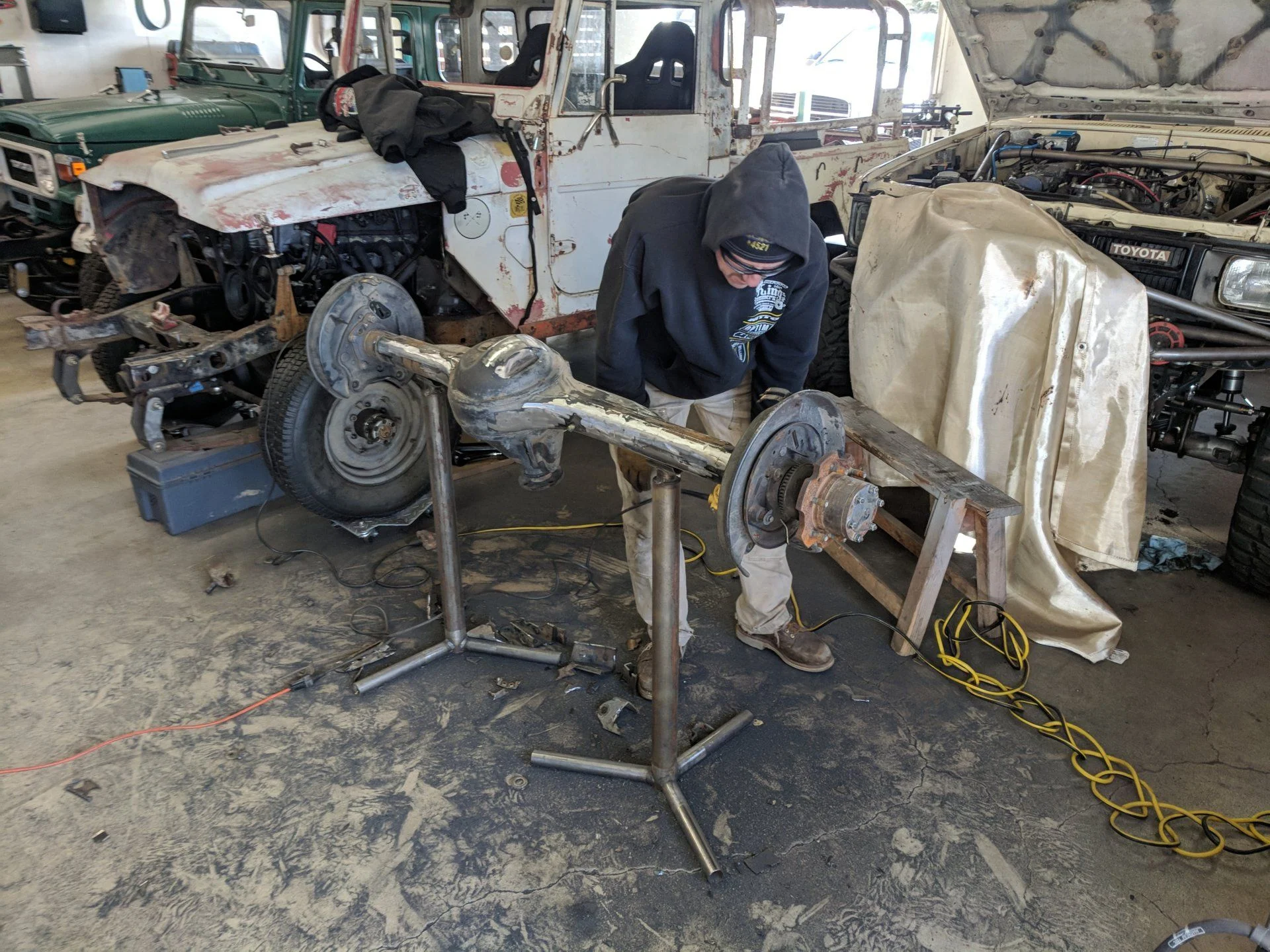

Building An 80 Series Rearend For Desert Racing On A Budget.

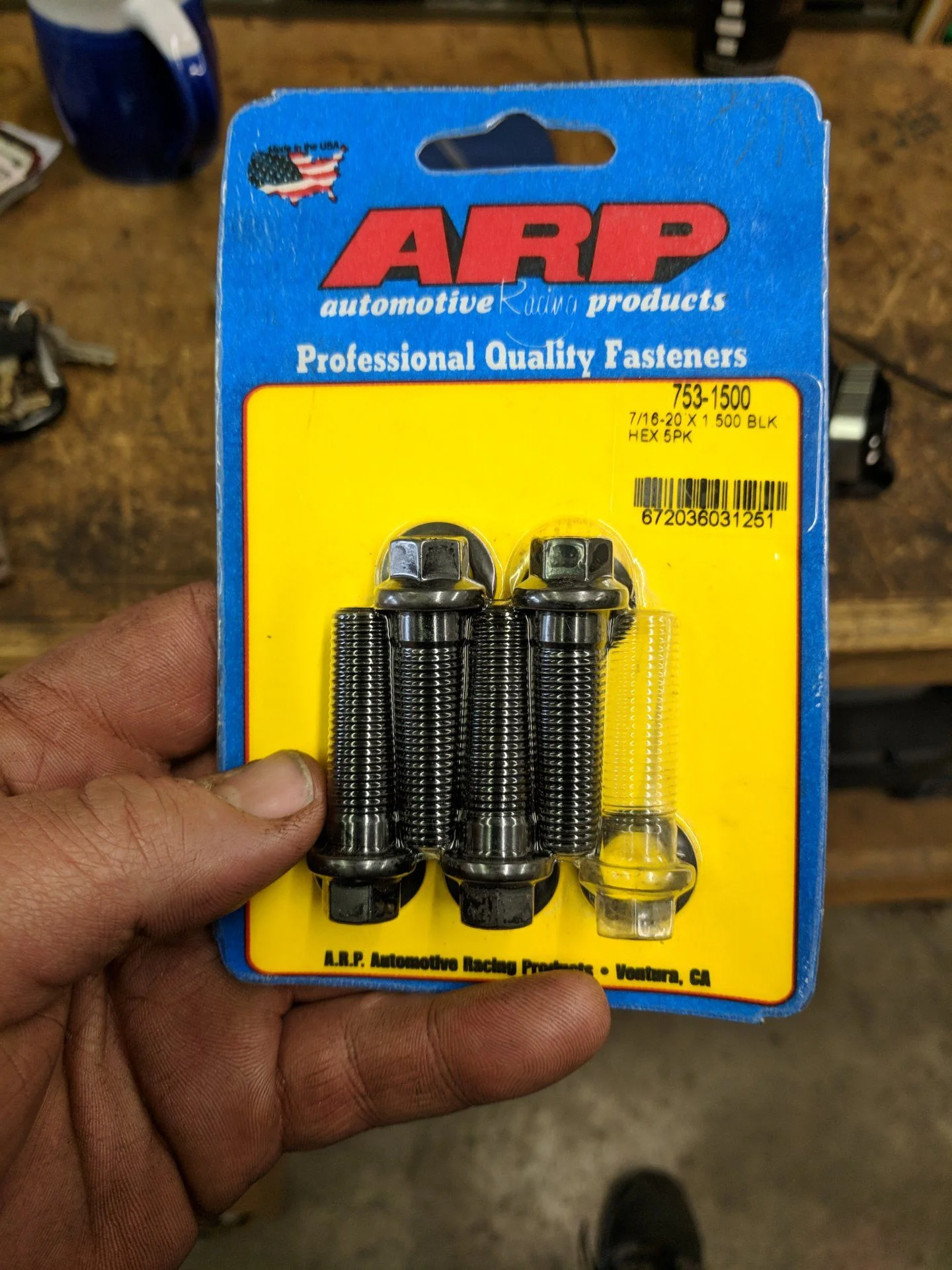

Per @cruisermatt suggestion we upgraded to the ARP 7/16 20

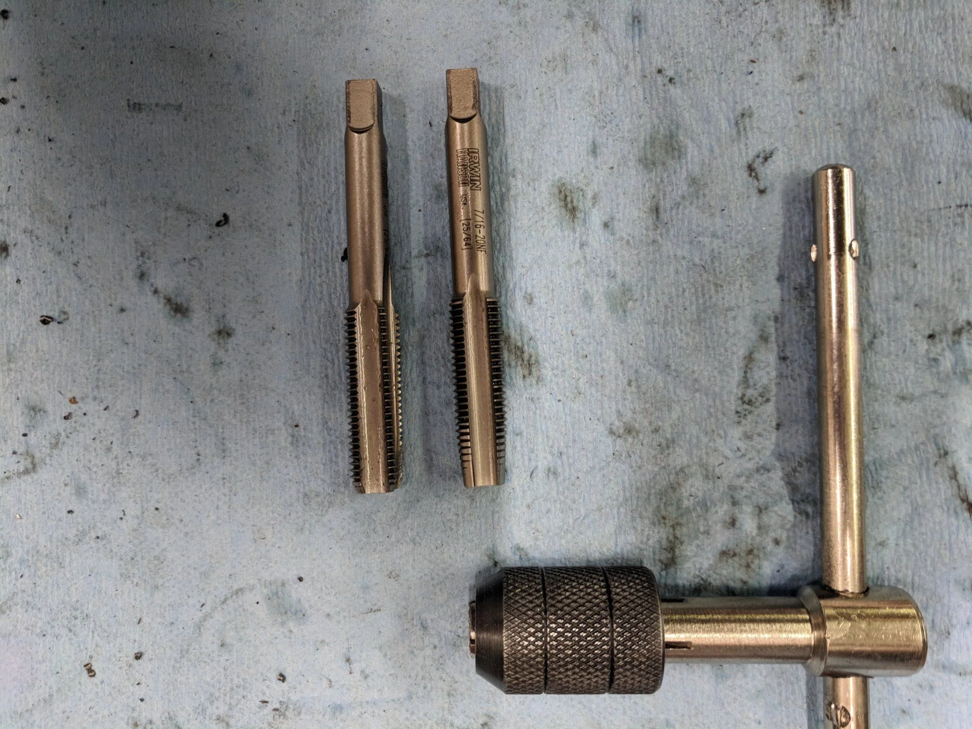

This forced me to true up my drill press to dead nuts and this is an easy upgrade, just some extra care getting the tap just right
. Thanks for the advice Matt!
For reference for other folks doing this

One tip or trick that works for me is tap as far as you can with a tapered tap then finish it up with a bottom ended tap. Helps get it straight easier and makes the final threads in the bottom easy to cut.

One tip or trick that works for me is tap as far as you can with a tapered tap then finish it up with a bottom ended tap. Helps get it straight easier and makes the final threads in the bottom easy to cut.View attachment 1859467
Tap holder usually has a hole in back so after you drill hole and before you move anything, put a center drill or something in drill chuck..bring down to meet tap holder and keep pressure down as you tap. will keep the tap from going on an angle.
