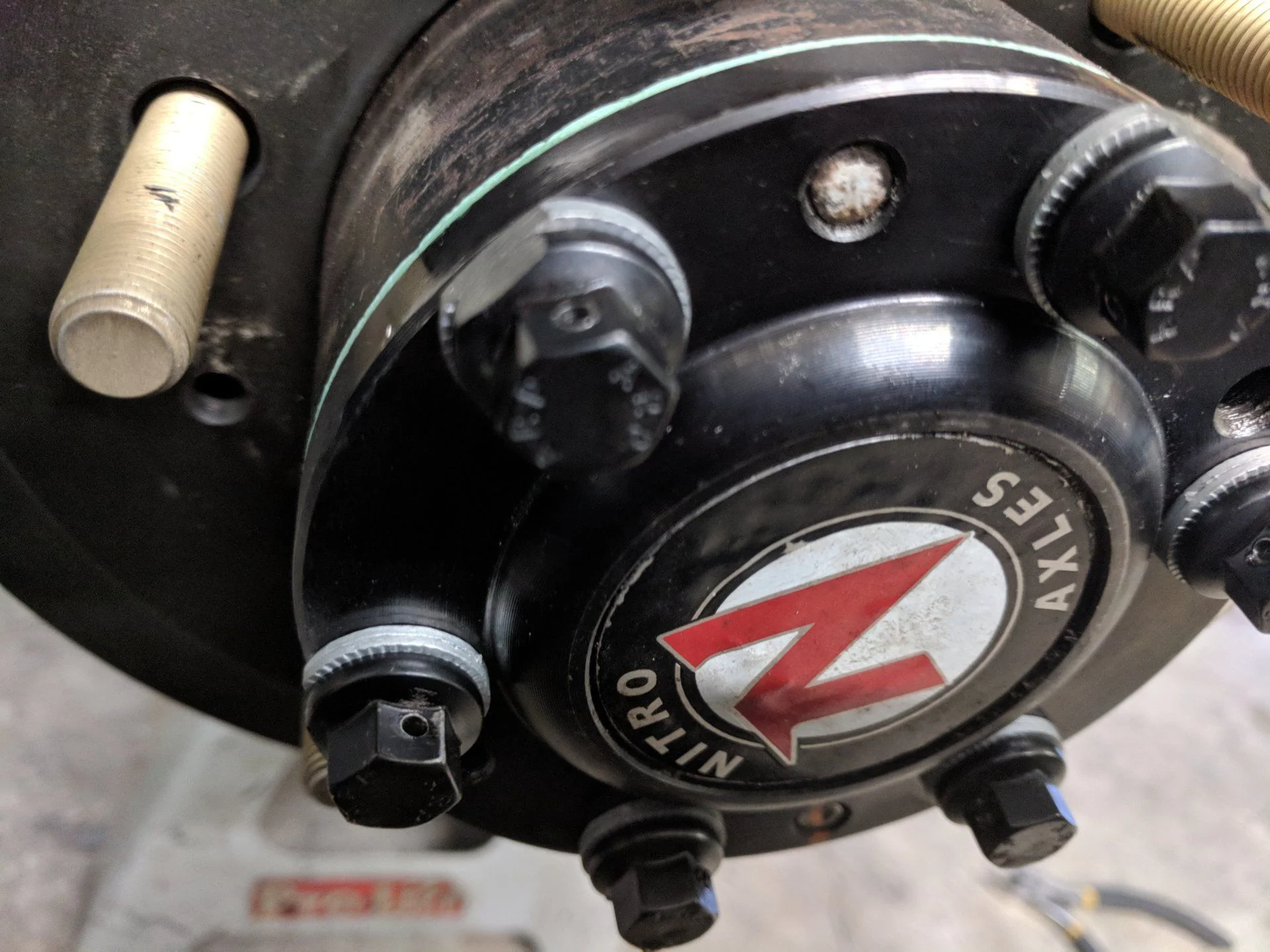

Rear is assembled, and plumbed.
Rear shafts are red locktite, Nord locks and drilled for safety wire.
Chris Bird my #1 guy in my shop. His wife is an F16 fighter jet mechanic. She is a pro at safety wiring, so she will be doing these next week.

Update, we have a few races on this rear end and several trail rides. Zero issues. I have taken it completely apart twice during race prep and have found no issues. Money and time well spent. Tough ass axle!
