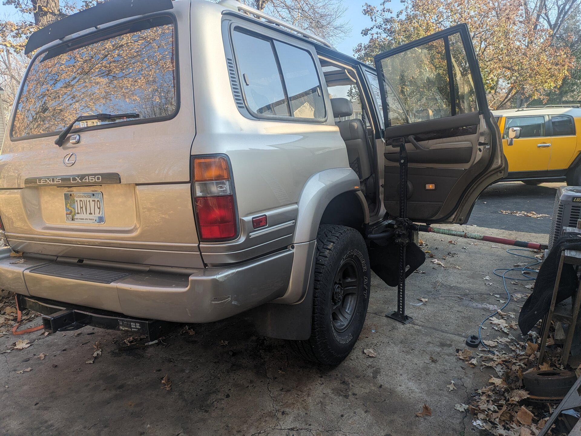

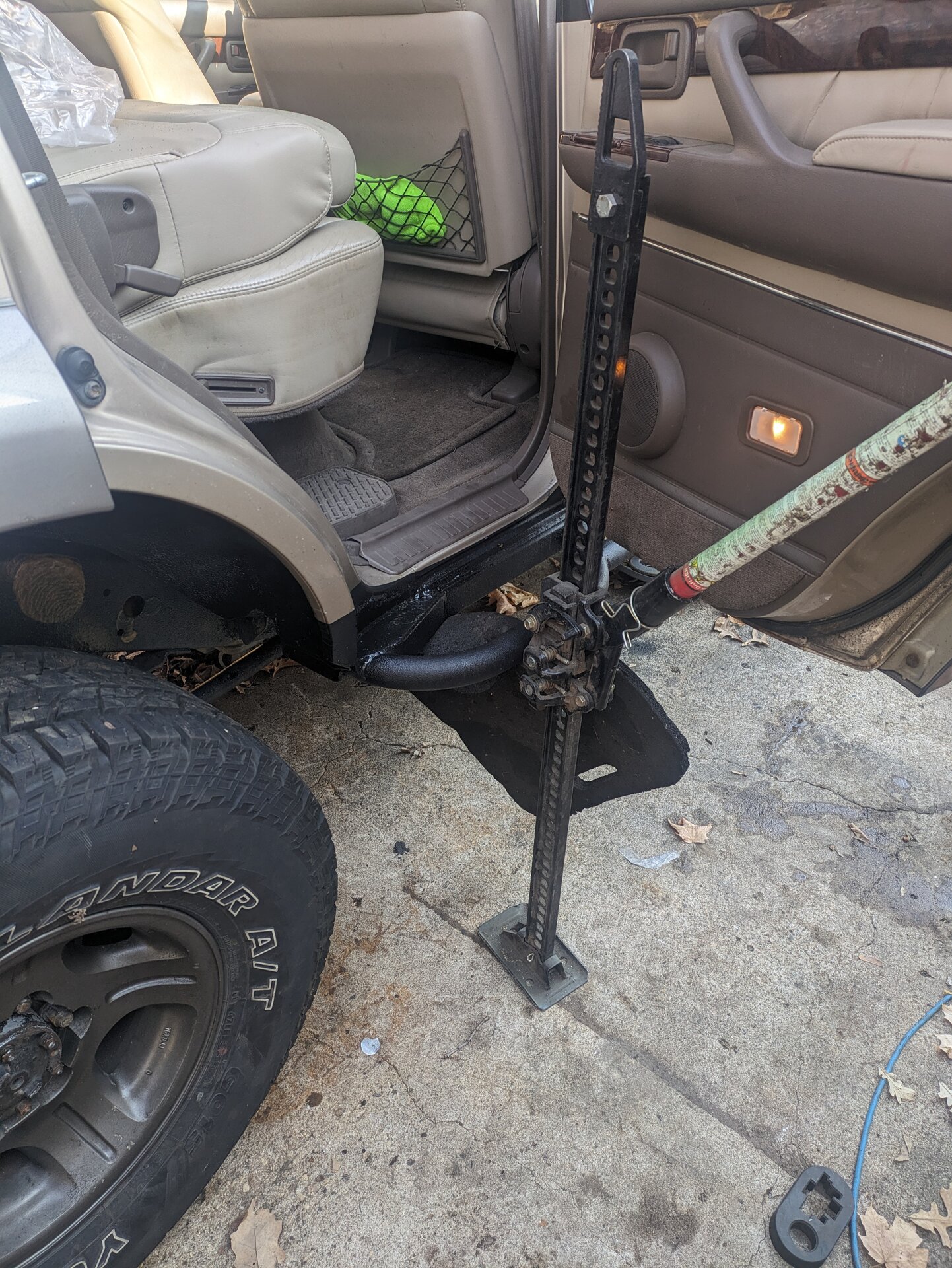

I was also inspired by your sliders and other who did similar and did them as an excuse to cut out some cancer. Haven't had a chance to test them yet but I have jacked the rig up and they didn't budge. I have more pictures on my old phone, would need to dig them up. Happy with how they turned out but there are a few things I would maybe do differently if I were to do it again. Keep in mind your cats will be exposed, you will want to modify the exhaust one way or another.
View attachment 3551764View attachment 3551765

That was what i thought when I started on mine. It took around 20 hours, a pile of cutting discs, 2 sawzall blades, a lot of mumbled profanities and half a dozen shed sodas. But it's a lot less work than "doing it right".

I'd seriously worry they couldn't take the level of abuse i dish out - that's a lot of extra load on the body mounts, especially on a chopped truck with less body mounts. I also like how far the frame mount holds obstacles away from the body.
