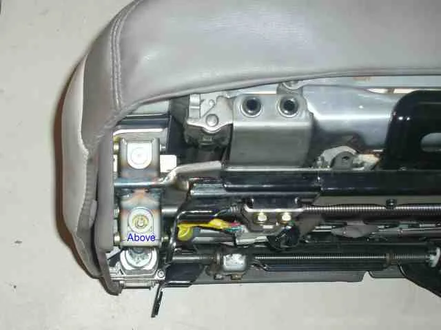

about a year ago my passenger seat would go forward but not back so pulled it out and set it as far back as itd go and put it back in with the electrical disconnected. then a few months later i found the little plastic cap had fallen out on the driver side and then had the same problem witht he seat, put two and two together replaced the cap and drivers side worked great. sooo the problem is i lost the plastic cap for the passenger side. A buddy of mine came over for dinner the other night and was complaining about how his passenger side seat was broken and how fabric must be stuck in it b/c he's pulling all kinds of fuzz out, so i bet on the same issue, pulled the seat out and sure enough no cap, so i moved it back and put it in w/o electrical and showed him the cap he was missing. now with two missing caps im willing to hunt down the pieces or order them from dan. does anyone have a part number for these pesky little things? or do you have to order the larger white unit including the piece? also what is causing these to unscrew or dislodge? anyone know i did a search and someone mentioned glueing them back in, but others pointed out they were threaded and glueing wasnt touched on further.

Old thread revival... is this the white thing you guys are all after? Someone PM'd me a few weeks ago asking if I could make a few of these, I finally had time to remember to run out to the 80 and try to see what he was talking about (and I'm sorry I forgot who, plus I had to delete a bunch of PM's to free up space and yours was among them, I'm sorry man... :rolleyes:)
Anyway yes this is likely very possible for me to fabricate... and I suspect I could sell them for $7-$8 each, something like that. But before I dive into the design, can someone please confirm that this is the part you're all after? thanks..

Looks like it to me. I just re-installed that fellow on the DS seat yesterday as it came loose. PS was about six months ago. I like the drill and small screw or cotter pin method to keep it captive. Safety wire would work too I guess.

I am the one that PM'ed you and yes that is the part.
I went back and forth with the Lexus parts guys about this, and they indicated that I would have to buy the whole assembly (I think it is the motor). Cost was $400.
