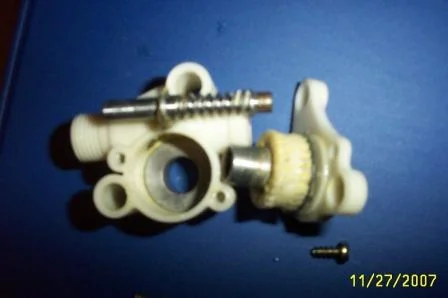

Seems like a lot of you are having the same problem as I. The plug might not be your entire problem. I had the same problem with the seat not moving and when I called the dealers for the fix it was going to cost $1200. I tore the seat off the track and like all of you I was missing the PLUG. The pictures show the part described as the HOUSING(sorry no part number) and what happens after the plug has been out of it for to long. Sorry about the quality, but notice the nylon gear in the second picture, it got chewed up from the metal screw which is held in position by the nylon plug. The housing at the stealer cost around $80. Maybe you guys can find it cheaper.

Yes, the white cap screws into the right side of the first picture and holds the metal screw gear in its correct place.

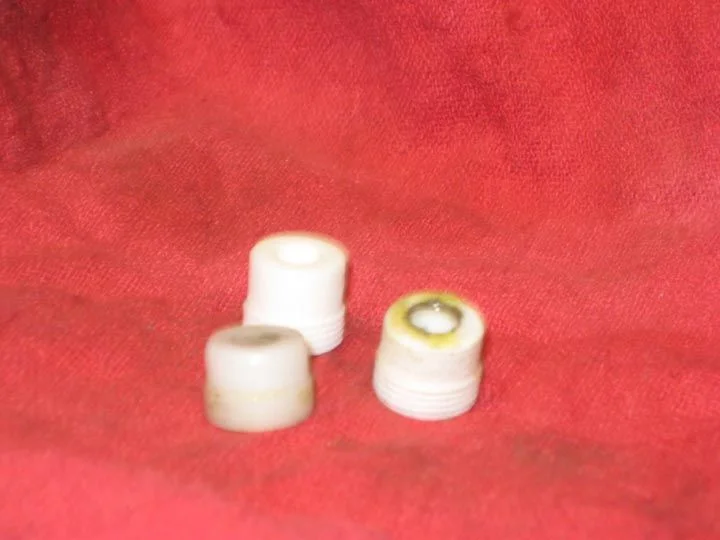

Ok the first prototype is done, and seems to work. However there are a few tweaks that could be done to the design though to make it even better, so I want to do one more test before I try to sell these.. shouldn't take long though. noting major just needed the small hole opened up a little and a quick trip to the belt sander to get a little shorter... the next file should nail it.
Here are your pictures, sorry for the poor focus in the second pic ..
