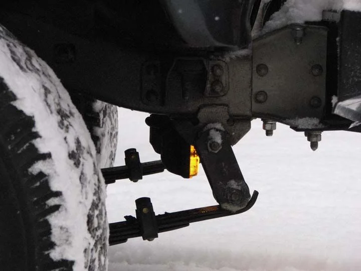

Mounting fog lights low is obviously going to give the best performance, but places them in jeopardy from all sorts of stuff if they're hanging off the bottom of the bumper. I've put those on my '84 Mini on a custom small cross member (bolted to where the swaybar used to live) back just about under the crank pulley. I do not notice any shadowing created by the front tires and they are fairly protected there.

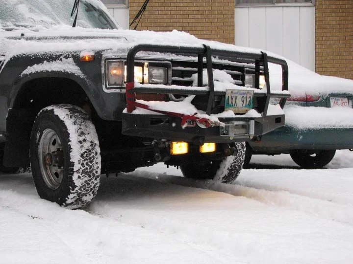

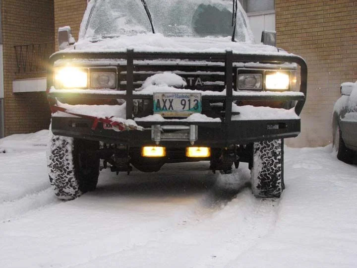

Here's how my fog lights are mounted, nice and low. I have vinyl covers that go over them when not in use, and they can be flipped back out of the way if you are concerned about catching something with them.
