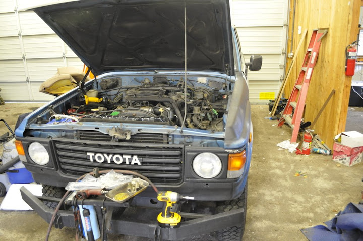

So here's the new (to me) 84 prepped for surgery.

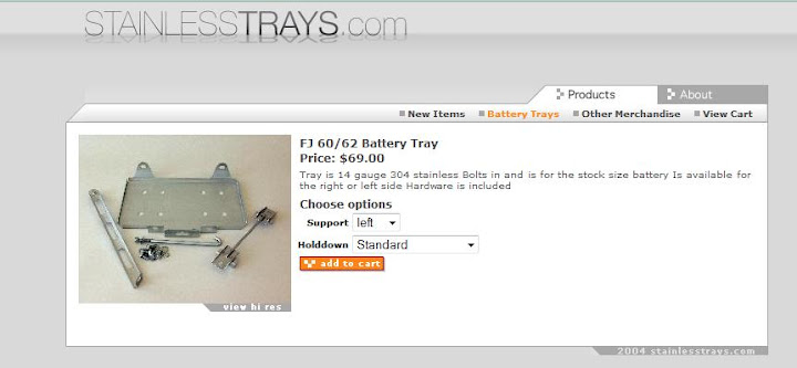

I just got my new SS tray from Noel at Stainless Steel Battery Trays for TOYOTA LANDCRUISER. Another great guy. I've been emailing him since i heard he lost access to get his trays made. Around Christmas I pinged him and got a quick response:
Quote:
Hi Rob
I did stop making them but I am now seriously thinking of making more. Hopefully I can get some going.
Check my website once and a while, or just email me.
Regards,
Noel

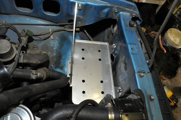

So i've been sitting on this GORGEOUS SS tray waiting for him to finally have them available online.
today is that day!!

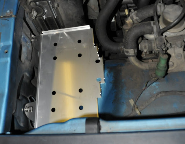

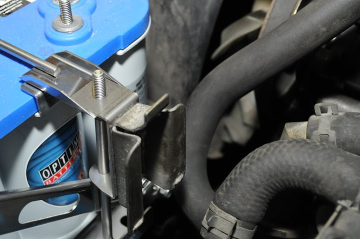

Tray set in

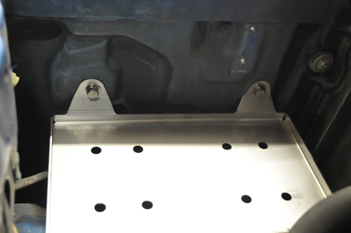

Missing one hole to bolt to fender:
Easy fix - hole and washer/nut.

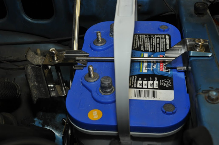

With the brace (man this is a good looking tray! almost a shame to put a battery on it and block the view!):
OK - got the battery in, with a group 34 specific hold down.

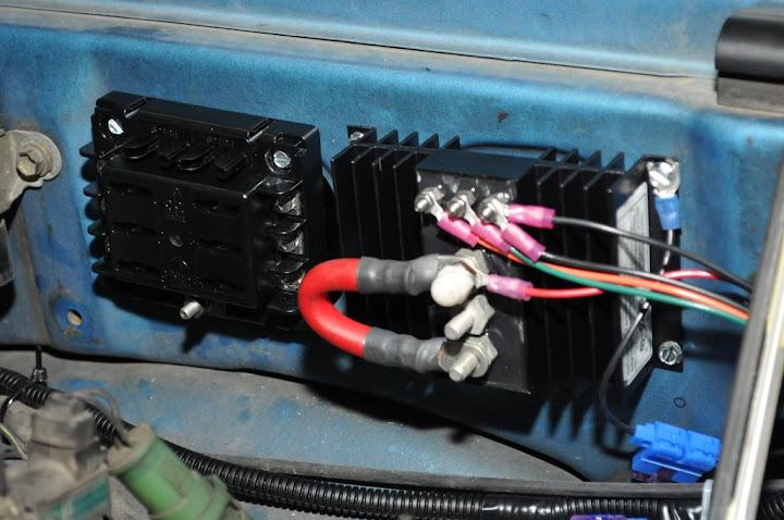

AND the coolest part - a washer bottle relocation bracket!! He made a couple of these, though i don't think they are on his site. This thing is perfect - clean and really well thought out. If you want one email him to add it to your order.
I am going to desmog next, so this is currently not being used. The smog assembly is in the way (i knew it wouldn't fit). I added a small extension of tube, and put the overflow bottle on the smog assembly. Not going anywhere for now. Desmog soon and i'll clean this up.
Additionally i don't have headlight washers or the bottle. (useless in my mind). That made room for the BIC-95300 from Hellroaring Battery Isolator/Combiner BIC-75300. I paired it with a fuse panel for accessories (still in the works), which also acts as a PDU for clean installs w/ standard fuses (same blade type as interior fuse panel). 100A max from Del City - Wiring Products and Professional Electrical Supplies (item 70365):

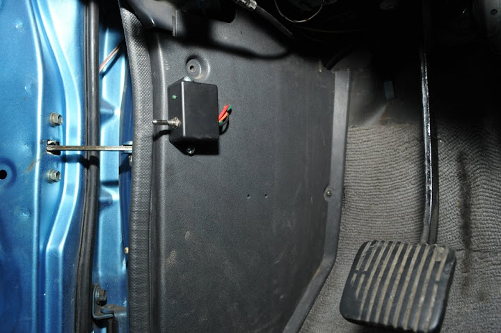

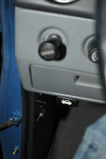

The BIC remote installed here - i think this turned out very clean w/ a bit of loom not shown:
i like that i can see it easily and reach it, but it's out of the way. I'm a big guy (6'8" - 260lbs) and don't want anything hanging in the way that restricts even more leg room.

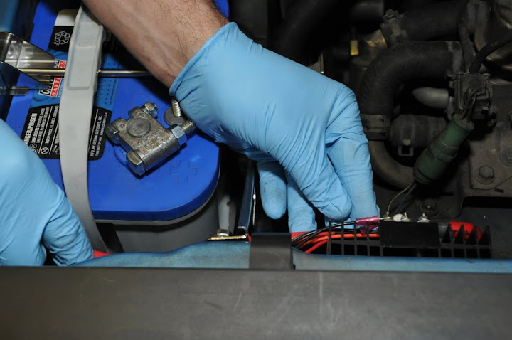

I need to grab some more shots of the final install. Here's brandon finishing up the wiring, and new military terminals (like these a lot!):

thx rfj. I wish i could take more credit, but i just helped here and there. It was really great to see someone who took the extra time to get it installed how I liked. Good mechanics are hard to find, and cruiserhead mechanics even more so!
I should show a pic of the disconnect he made on the kick panel. I knew i was going to be doing the damplifier install soon, so he did a trick connector to make it easy to disconnect and remove for the install. Don't think i will pull that panel very often, but nice touch.
