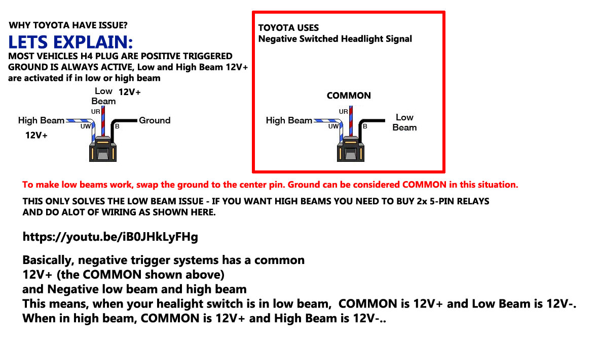

came across the image below....but I'm not sure how the stock sealed beams or the newer H4's work because they both have a shared ground circuit. If the toyota system relies on a switched ground and power is always on at the low and high beam power wires...then its a mystery to me how my lights actually work properly with only a single ground wire.
**Edit, think I got it*** Power comes in on the common lead and the switch simply makes the connection to ground for the high beam or low beam depending on position. So you can measure a 12v signal in reference to ground at any of the 3 connectors but the light will only light when the switch supplies the ground.
In the positive switch the ground is always present and the switch activates different relays to send power to the appropriate terminal.
So that said I now understand why the H4's work. I think the LED issues come from the fact that the flow of the current is backwards to what the LED needs. (guess)

I will be using this conversion harness to convert from the dual ground switching from the TOYOTA harness to a dual power input.
Harness
Think you are going to need a ground switch instead of the harness. Those LEDs aren’t effected by voltage drop the same way that halogens are. They just won’t work if they are positive switch and you plug them into your regular harness unless you have a negative switch between them and the LED.

Correct, this is the same concept but includes what is essentially a new harness

So.. I just ordered inexpensive Trucklight knockoffs off of eBay for $50 for a pair. Also purchased the ARB M002 wirining harness and it didn’t include the negative switches. I installed the harness and LED’s and they didn’t work. Ordered the ground switch modules and then “I saw the light!”
I know the more expensive LED’s have “sensing” capabilities but mine didn’t. I’m not sure if the ones your getting will either.
I think your going to find with that harness that there isn’t anything that switches the ground. At least in the description there isn’t anything that mentions that and it looks like there are relays but not switches in the photos. It looks like it’s a knockoff of the ARB M002, which might not make your lights work.
