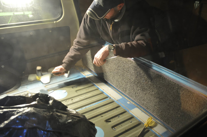

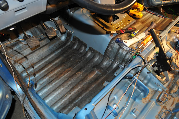

here is the start of the project - interior pulled out w/ factory tar in process of removal w/ dry ice/hammer/help from brother.

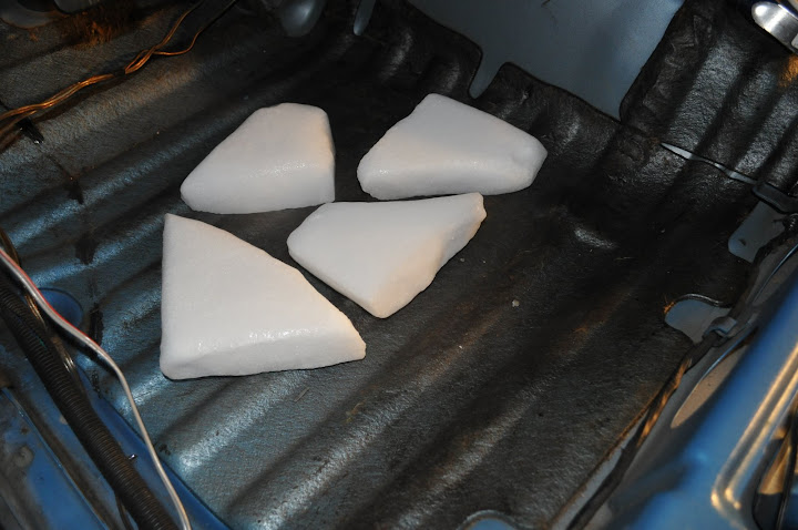

My bro was an ANIMAL when he got the hang of this. Set the 5lbs of dry ice on a section for 2'ish minutes, then move and hit with a hammer. It would come off in BIG pieces this way - most of the time just pickup w/ your fingers and move on. Sometimes need a screwdriver or chisel to get a tough spot or some leftover chips of tar mat.
We (ie my brother mainly) pulled it all in about 2 hours. If i were to do it again, i'd get TWO 5lb bags of the dry ice so you can swap it around faster between two people and let it sit 2-3min for best results (probably longer if it was warm to begin with). We had 45-50 deg weather all day, so dry ice didn't need 10min to work.
ice and hammer (harbor freight - harder plastic side worked great):
so - Before:
and - After:

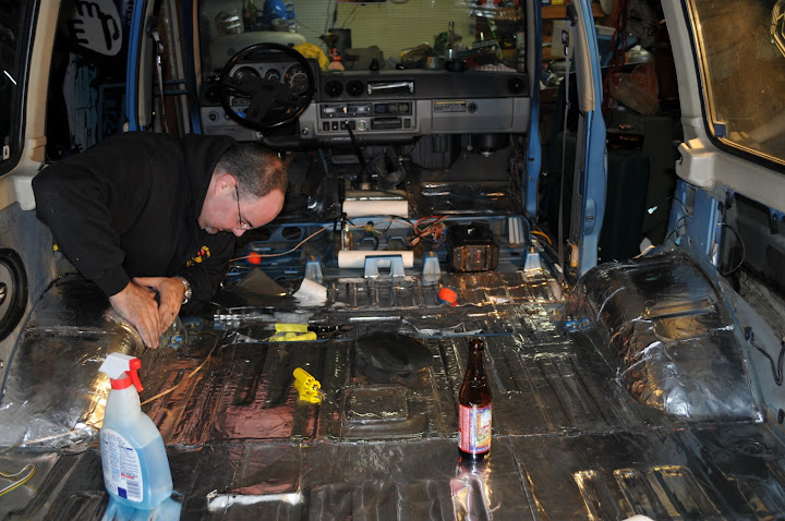

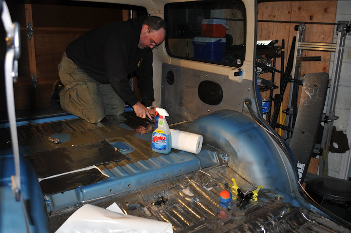

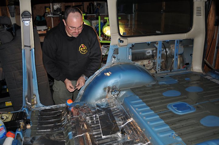

A few weeks go by and i finally decide i need to get this done. Pulled the crap out of the truck (set back in while sanding), and started cleaning/vacuuming. A buddy of mine came over to help last night after work. (family and good friends rock!).
He is fast! I spent the entire night cleaning ahead of him, or following and just nitpicking spots (pressing all edges down etc).
Starting out:
Both actually a bit into it and once we were getting the swing of it, but first time i remembered to grab some pics:
And just about done for the night (probably 3-4 hours hauling ass):

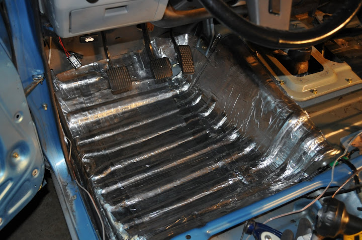

We have a full single layer over everything EXCEPT under the front seats. That will be next.
I'm doing 2 layers of Damplifier pro over the transmission hump (partially done), and rear wheel arches (done). Still need to do 3 of 4 doors, rear quarters, and rear gate.

Almost forgot - tips for laying down the damplifier:
  • The 1" roller works very well, but a tennis ball works nearly as well and is MUCH MUCH faster!!
  • I used the end of the handle on the roller to push down corners and edges of sunken areas. That's another tool it would be nice to have 2 of so you can really tag team and not wait for someone to finish using it. A nice smooth, smaller screwdriver's end also works similar. The wood handle is nicer though IMO.
  • the razor blade knife is really helpful for straight cuts and cutting sheets smaller for tough areas.
  • cheap tin snips from harbor freight - more flexible for curves and odd shapes, also easier to use than the knife, but slower.

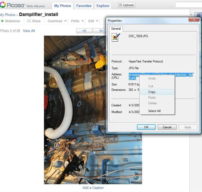

Hey...pardon my ignorance.... how do you post that many pics at one time? Cut and paste? Where the thread doese not show the attachement paperclip icon... Just so know, so I can do that when I would like.

You link the pictures to a website. A lot of website will host your pictures. Click the insert image in advanced reply.

good question - small pics suck.
To really lay it out for anyone interested (if you know this skip to next post)
I use picassa 3 on my computers, setup albums for projects, and upload to google web folders (1GB free space). I then manually insert pics as i go. I use [img]url here[/img] around each photo's properties/url as i go at the size i want.
Hope that helps. did a quick screen shot and was lazy so just uploaded it.

back to damplifier - worked on under the front seats. Passenger is nearly done. Going slow...
Thinking of how difficult to do headliner... man that looks like a bitch to pull down...
