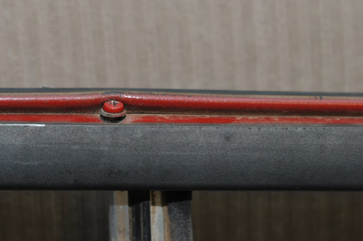

Remove the top screw:
open the windows so glass is in the center.

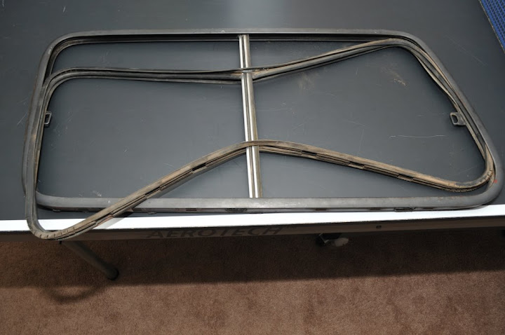

SO w/ glass out:

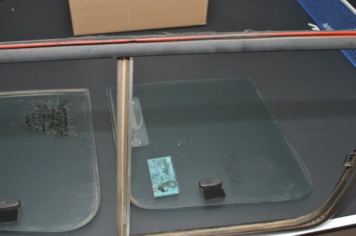

this part gave me the most difficulty so far. Top screw is easy:
even though the parts fiche i've seen looks to show a screw at the bottom too - mine does not have a second screw!

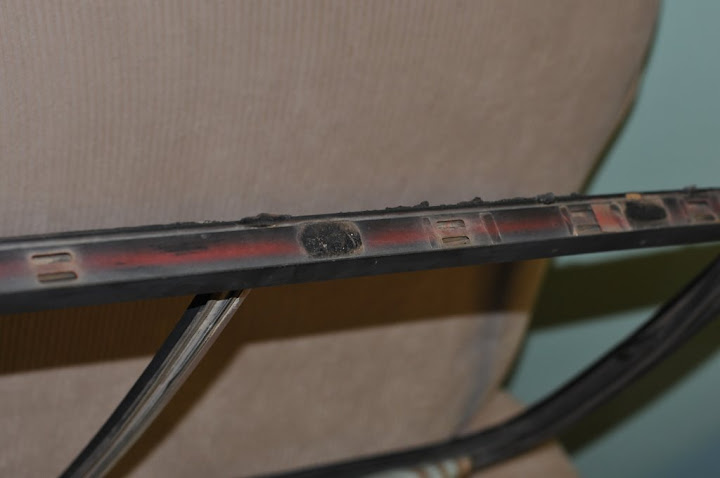

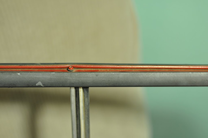

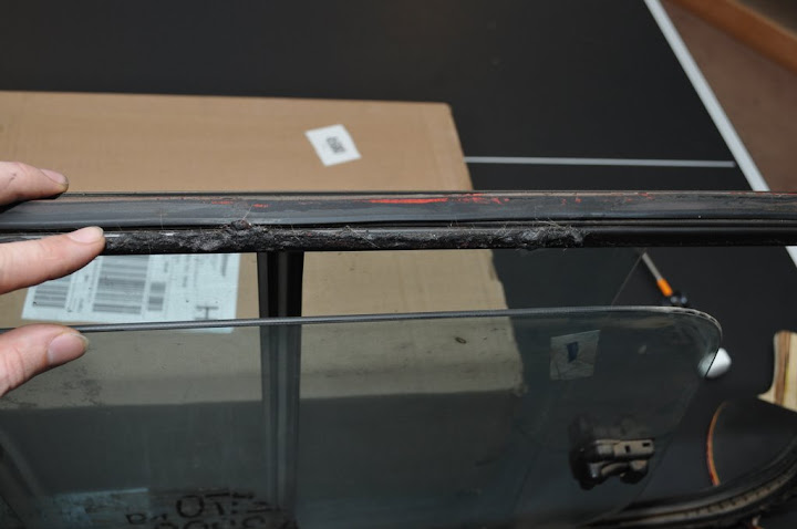

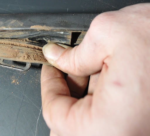

After fiddling with it A LOT, i finally figured i'd pull the old weather strip to get a better look at the bottom attachment for this center piece.

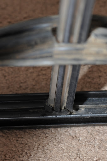

with the weatherstrip still in (getting pics to show and ask for help)

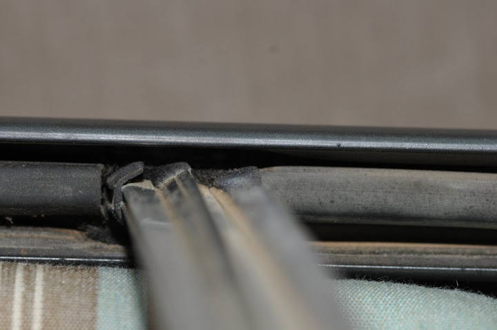

starting to pull WS out:

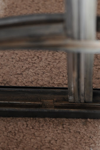

while messing with it i got the bottom part of the center piece to move over and back - Tada! i was about to post pics and it solved itself.

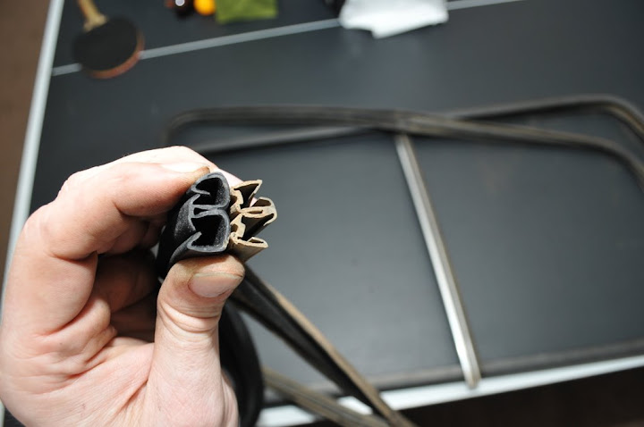

Alright - now i pulled out the old WS, and compared it with new:
at first they didn't look close, but side by side it looks like a perfect replacement. I got 3 lengths, since Tinker or Euclid said 2 was just shy of enough. (anyone need a smidge more just let me know).

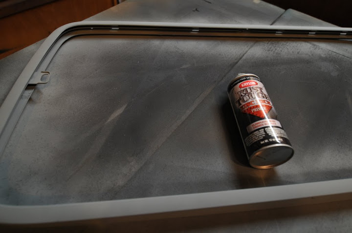

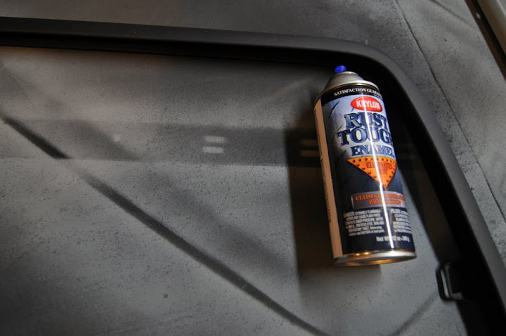

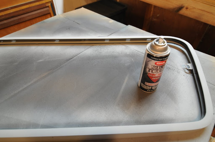

I wirewheeled them this weekend, and am primer and painting them before new WS gets put in.
I will post up pics of primered and painted next.

Hey guys - too many projects. Here's the latest. I primered and am painting the frames - before I install the new WS.
Primered:
Painted:
I hope that helps. I am likely going to smooth(sand) down the paint and hit them with one more coat before i call it done. Definitely better than before, and it's not a show truck.
I got some of the Gorilla glue to use when i glue in the new weather strip - think it's too strong? I also have some 3M Super 77 spray if that would be better... Anyone have thoughts on this?

OK you whiners! Dynosoar asked me for some of the caterpillar fur for the division bar, so I'm sending him enough for both windows plus spacer material since those things usually disappear or fall apart.
So email me & I'll do the same. All I ask is postage. I hate the PO so I'd rather just go once.

Is it really necessary? I stripped my old w/s out and it sue doesn't look like there was ever any adhesive.

Naw, no adhesive. You slice the bottoms of the corners perpendicular to the length of the weatherstrip at 1/8-3/16" intervals with a single-edged razor blade. New Xacto blade for the drain holes (biggest PITA of the project).
Hey, everybody, make sure you've emailed me (steve@restocustoms.com) for the caterpillar fur & spacers. I'd like to go to the PO once & make it as simple as possible (read Priority Mail). I'll try to make up instructions to include, too. But I have a RJ (or a full-time substitute for same) so please excuse my tardiness.

Thanks Steve, it all makes more sense when a guy pulls the old ones apart. No adhesive, seeing the corner slices on what remains, etc. Any tips on getting the w/s in for those of us with ten thumbs?

I'm going to do the ends like mine had. Let me see if the pic shows it clearly:
hopefully w/ this cropped you can kind of see the adhesive. Was like rubber cement, just at the ends where they touched (on side near window lock). And i clipped my fingernails after this...embarassing...lol.
so i'm going to use the gorilla glue i think. i know it dries white, so hopefully will just put a couple dabs under the WS to hold it.
