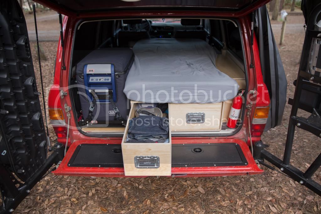

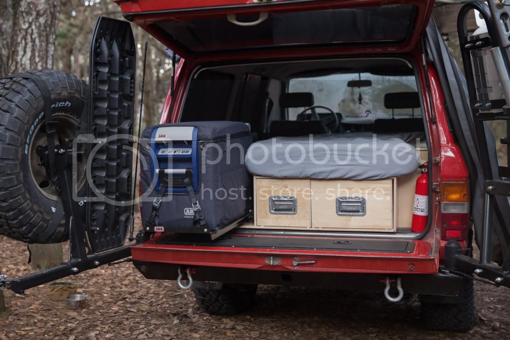

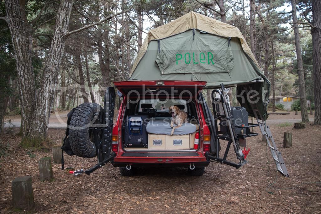

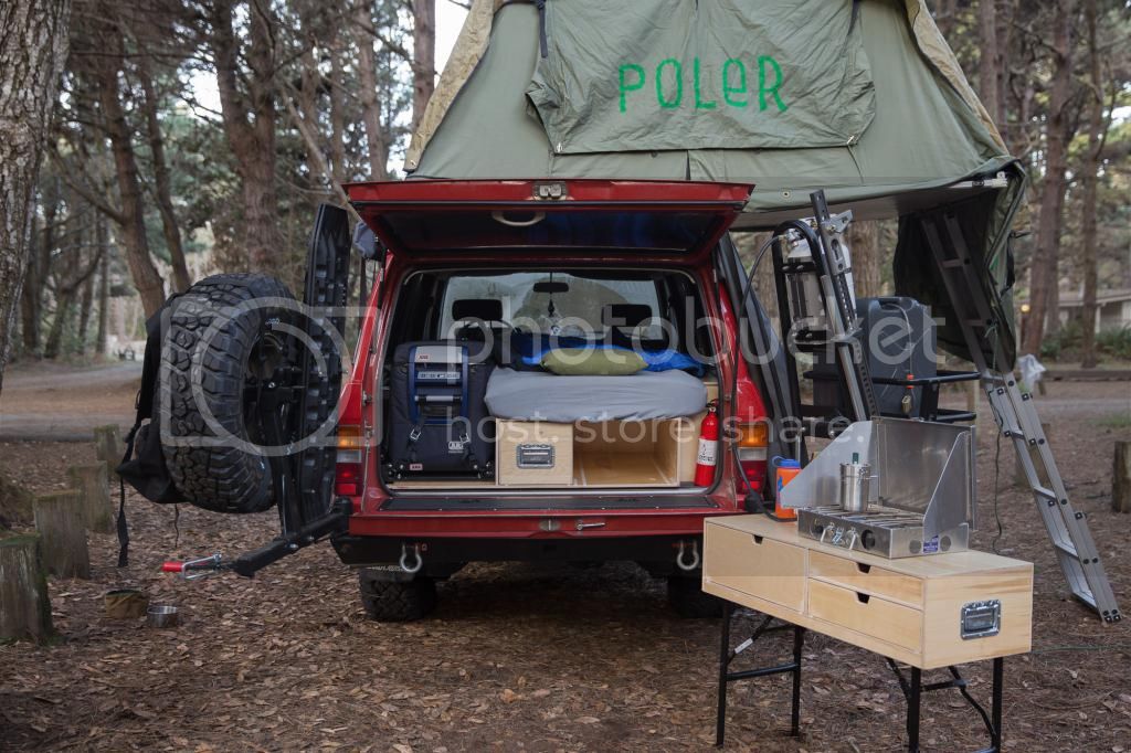

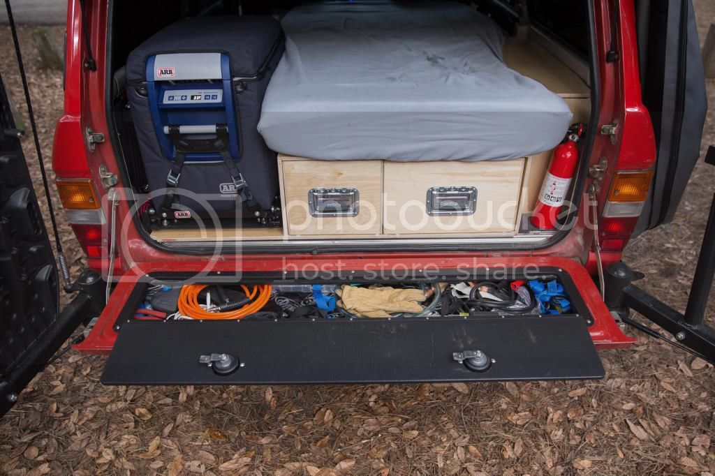

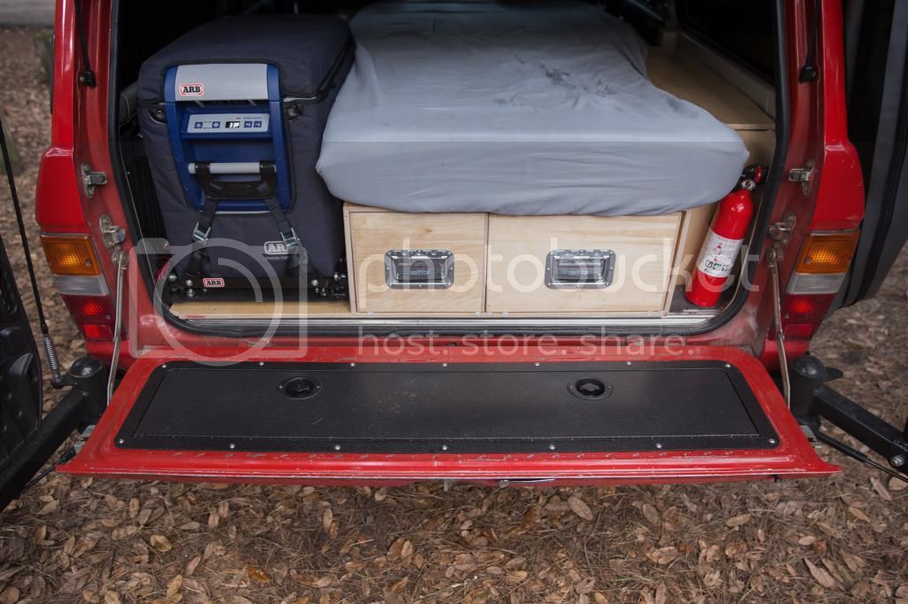

I finally had to pay for a camping spot last night. I'm use to traveling alone and you can camp on the down low easily, but my buddy is traveling with me on this trip....it's why I have the roof top tent. Speaking of the tent, a good buddy of mine owns an apparel company called Poler Stuff, and he had a few made and gave me one. Below are some images of my build out, I'll the post other bits later on. There are some other storage areas you can't see.
This build is based of off Luis's from Lost World Expedition and I believe he was inspired by Kevin's build out. Mattress is a 6" twin memory foam I got off of amazon, I simply cut the sides to fit around the fridge and side storage but length was perfect. If anyone is looking for a turn key storage and sleeping setup, Tor had 3 of these made at the time mine was built if you're looking for a solution.

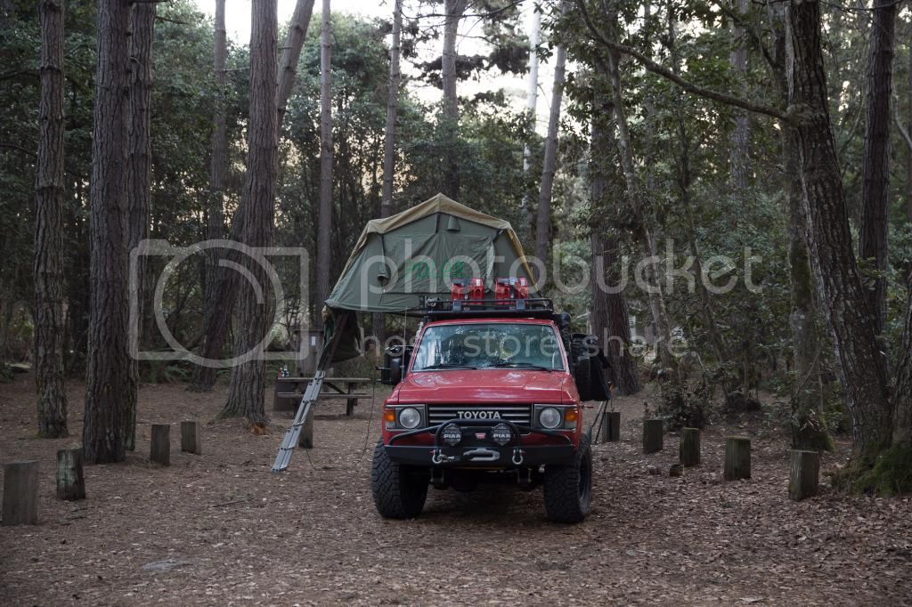

First paid camping spot, MacKerricher State Park:
ARB 50qt fridge with slider:
Wagon Gear tail gate storage:

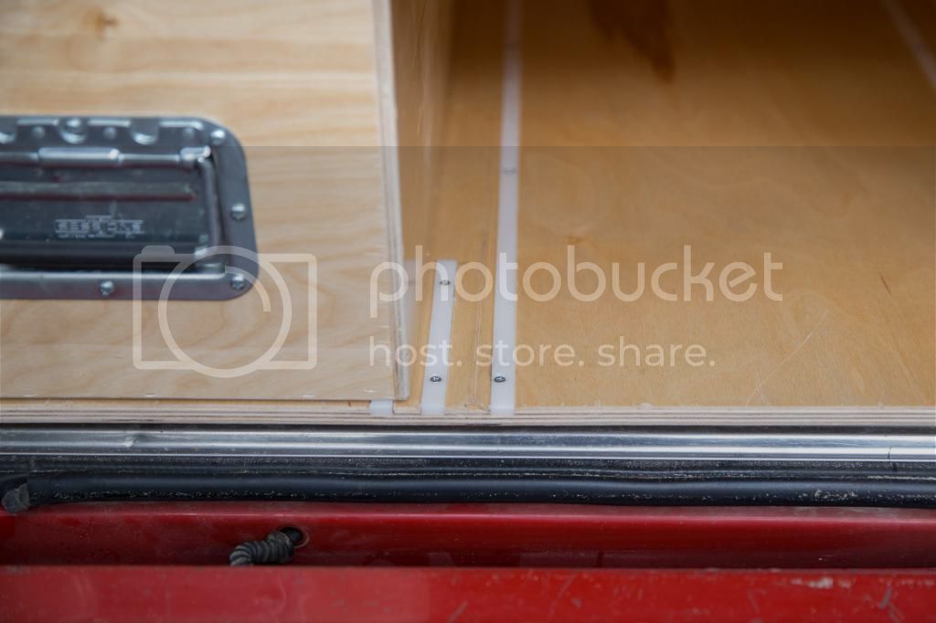

Plastic so the drawers slide easily:

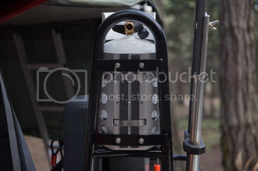

Custom bracket Tor built for my 10# propane tank from AT Trailers:

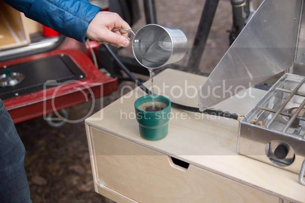

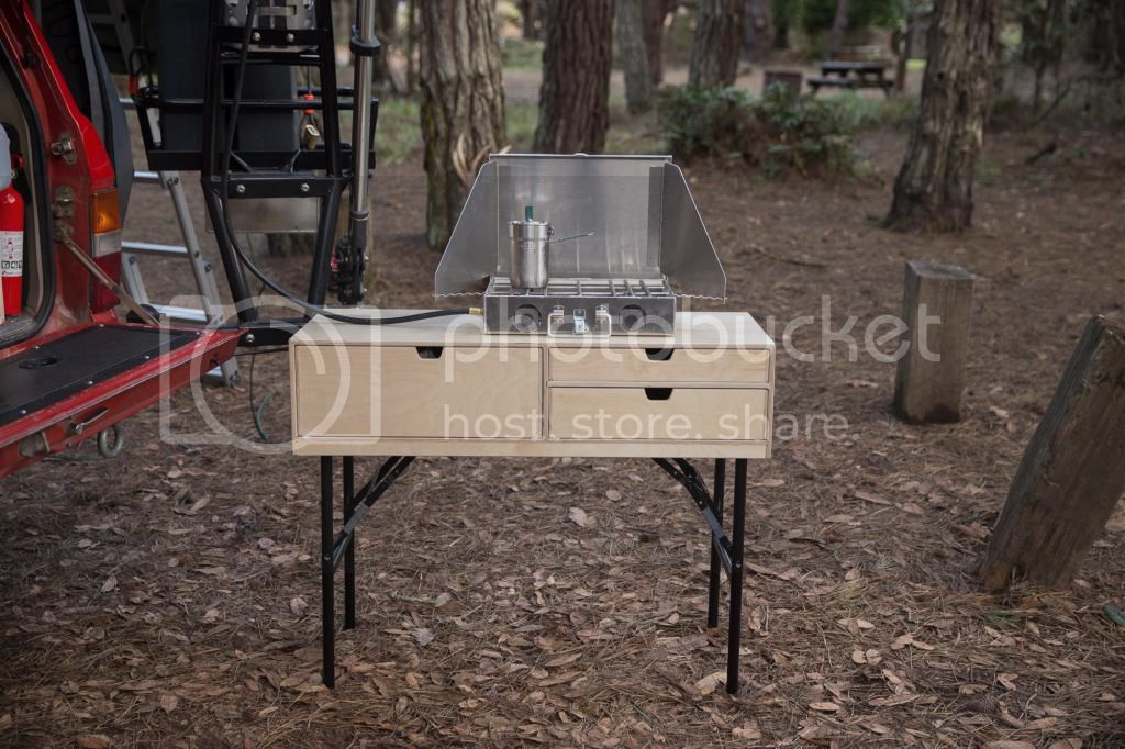

One drawer pulls out for a cooking platform and the Partner Stove stows in a drawer:
Coffee! I dig this Stanley setup for morning coffee, comes with 2 cups:
