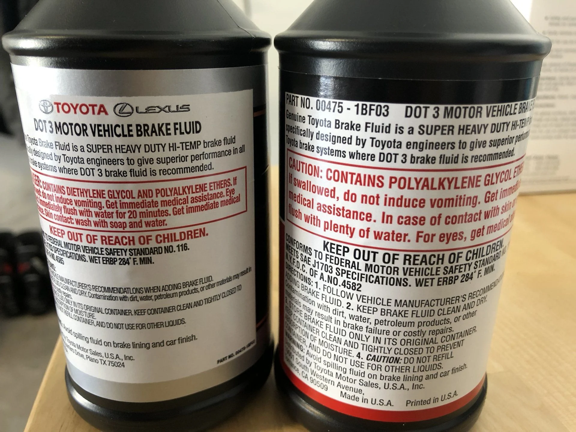

I just received a few bottles of brake fluid for the brake fluid flush i'm about to complete... Has Toyota changed the formulation or just the label of the 00475-1BF03 fluid?
To confirm, the bottles list the same part number but the previous bottle I have lists Polyalkylene Glycol Ethers and the new bottle lists Diethylene Glycol and Polyalkylene Ethers.
Bottle on the right is current. I have seen the one on the left. Prob just the label changed, not the formula.
