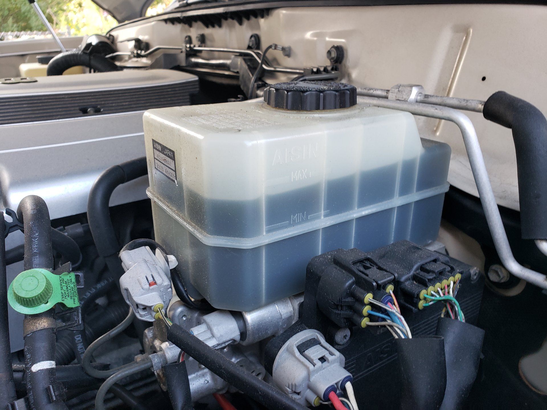

I plan on doing this in the next month. Just checked mine. Reservoir looks dark and fluid is a dark green tint.

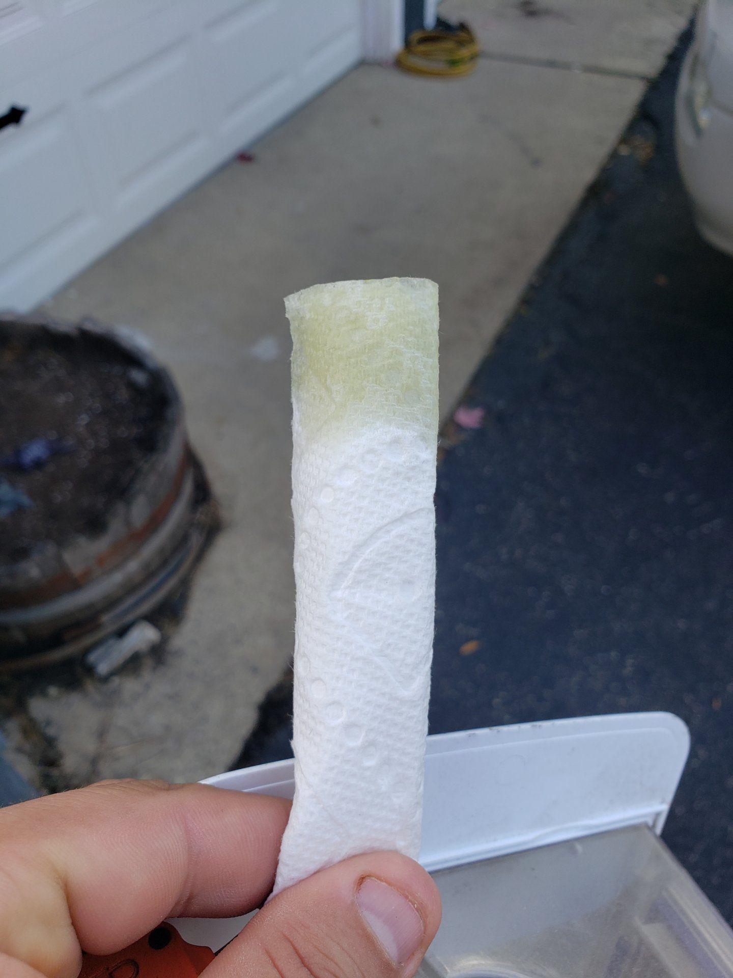

My fluid appeared the same color as wyattroa's was here. After reading these threads about the $4k ABS actuator tool, I decided have the dealer add it to my timing belt/water pump job.
When I picked the vehicle up the fluid appearance was the same as before. Unhappy, I took it back in and they swore up and down they flushed it. I then took it home and flushed it myself. It ran clear golden immediately on the fronts and almost immediately on the rears. Turkey baster of fluid from the reservoir was also clear golden before I began the flush. So the moral of the story is that the reservoir can distort the appearance and the paper towel method isn't foolproof. But the job is so easy I wouldn't pay the dealer to do it again. The bleeder screws are accessible without removing the wheels or jacking up the vehicle.
