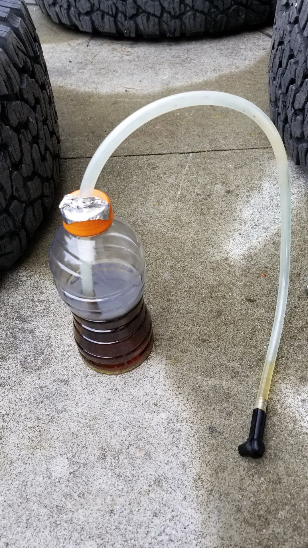

I have unsuccessfully flushed before using a couple of gizmos so today went back to basics and the result is the return of a confident brake feel and performance.
1) key off.
2)press pedal till it bottoms out. This is a good time to remove much of the reservoir fluid and put fresh.
3)turn key on without engine running. Took about 30 sec booster running.
4)attach a hose to FR and 10mm ready.
5) respectfully ask wife to watch her netflix on the driver seay.
6)three pump on hold PLEASE.
7)release 10mm and wayched air/ fluid out then close the valve.
8)ask boss to release pedal and repeat 3 pump and hold. Repeated about 5 times then clear fluid.
9)check reservoir level and fill as necessary.
10)repeat FL, RR, RL.
11) quick drive and activate ABS few times.
12)return and ask boss for her foot again and repeat.
13)yest drive and grin over a work well done.
14) clean up and check fluid lebel.
15) bourbon treat to myself.
I did use the fitting that came with some kit i tried but would work without.
