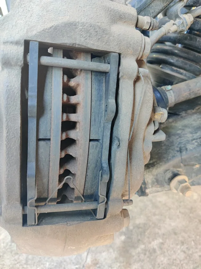

After replacing the front pads, original Toyota, they stay noisy on small dragging brake (like when parking).
My mechanic suggested to try another set (original). Ideas?

after further research I discovered that my mechanic didn't install the brake pads shims from the used pads... picture attached.
ordered a new shims set and will install them next week with some copper grease between the shim and the pad.
I find there's some tailoring or tuning that can be done with or without the shims. Classically, the OEM setup will have 2 shims: middle layer with lots of reliefs that keeps grease captive and a stainless shim against the piston.
More and more aftermarket pads come with some backing already bonded to the steel brake shoe. I would just add the stainless shim over that. Looks like some newer Toyota/Lexus have this setup as well.
Basically saying you may not want to add all the shims back. I find less shims to also give a more direct/positive brake pedal.
