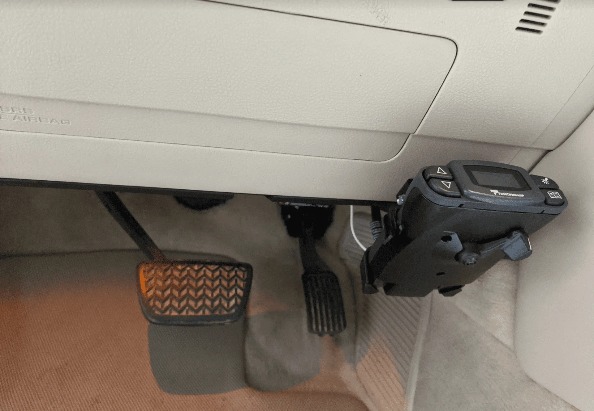

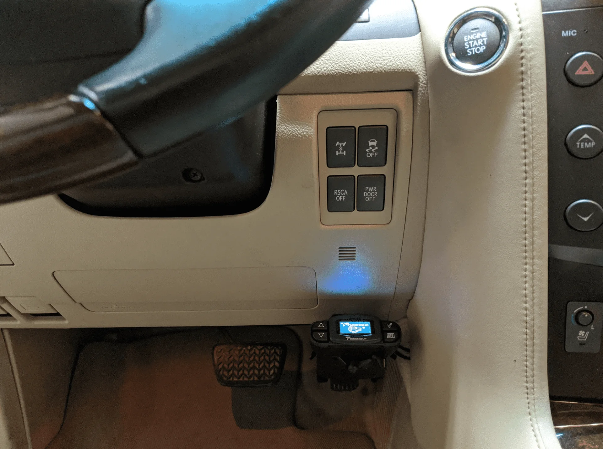

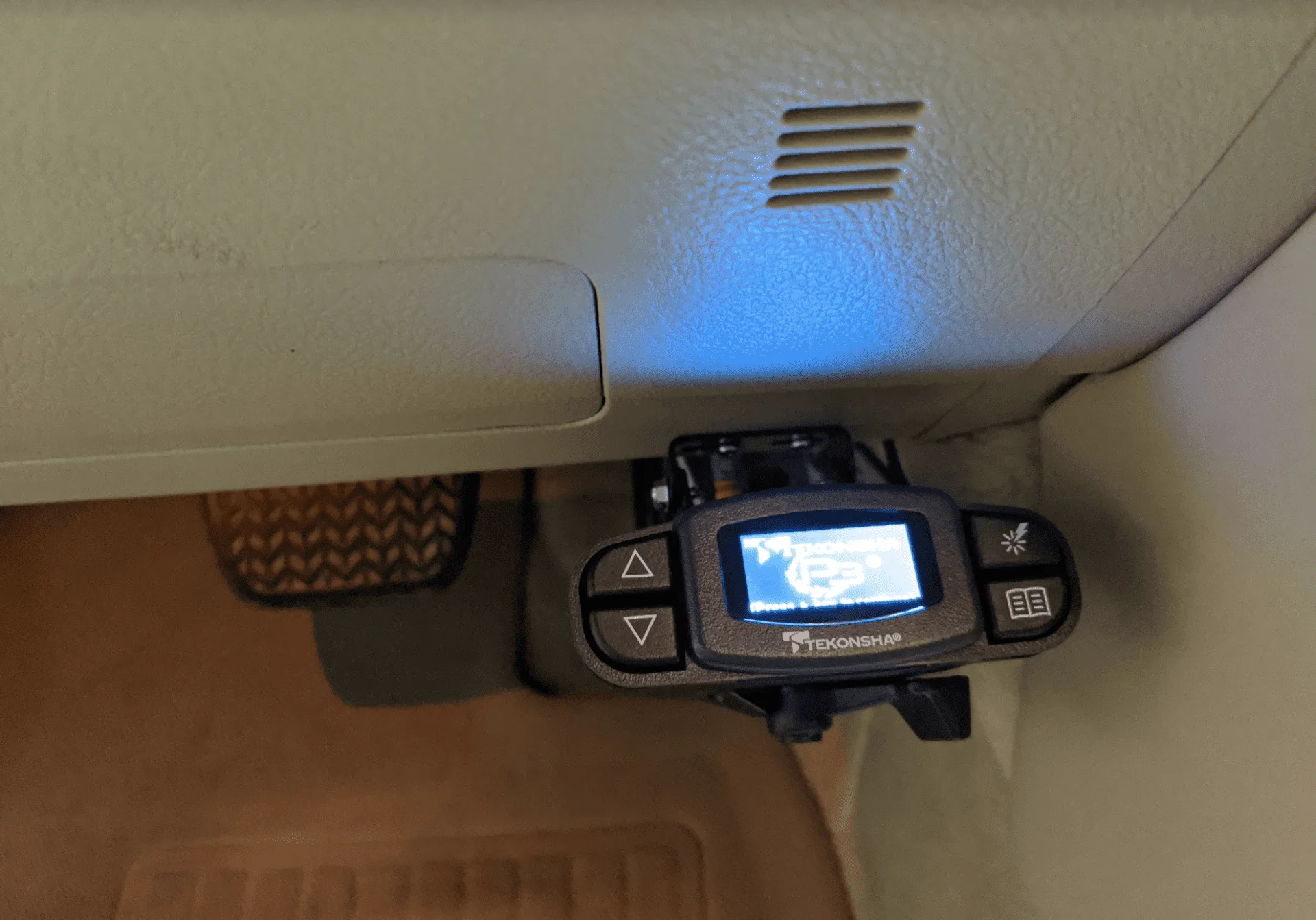

I mounted it here, and angled it all the way up so that it is out of the way and my knee doesn't touch it. Worked out perfect.

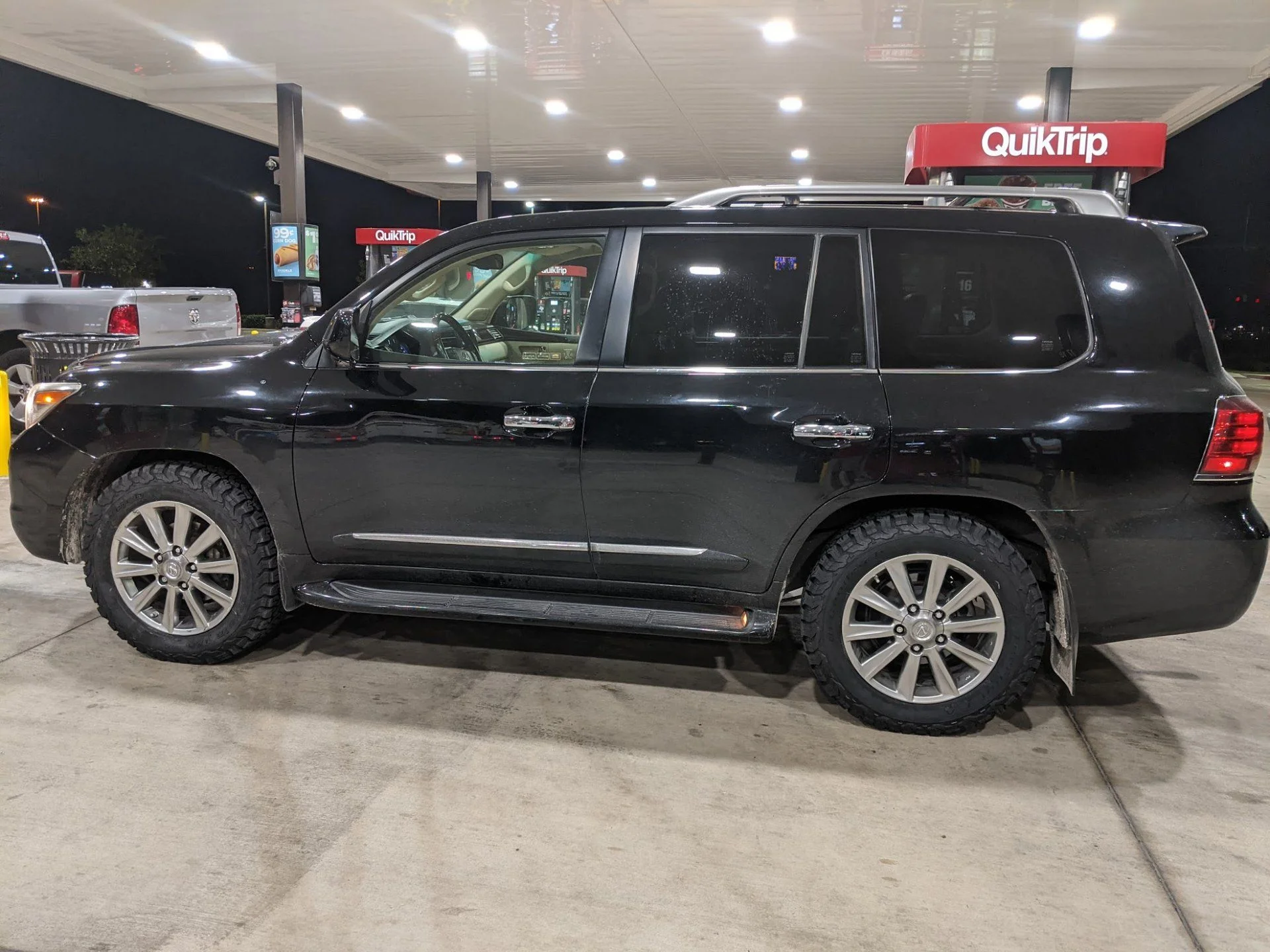

So I gave the KO2's a shot knowing that they would ride more firmly since they're D-rated, and that they would hum a little with the more aggressive tread. I was okay with all of that. Discount tire did a price match with Sams Club and I got them put on. They looked fantastic, no rubbing, and drove more firmly which were all good things. But there was a slight vibration at highway speeds. I took it back and they rebalanced and it got better, but not perfect. Took it back for the third day in a row, they replaced one of the tires after road force balancing and that helped more. But still had a slight vibration at highway speeds, and also had a noise at lower speeds that was obvious the either the tread was not straight or the tire was not straight. Took it back again and they said there's not much else they could do, the KO2's are just like that.

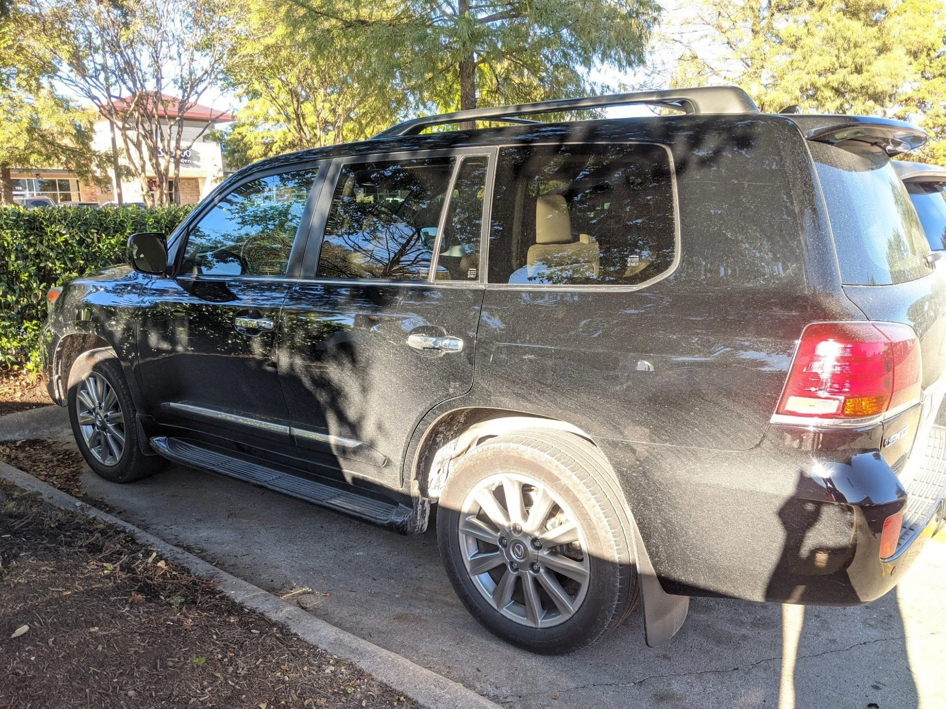

Need pics of the defenders on your LX truck please. Full photos would be ideal. Thinking about upsizing defenders. Love the Michelin's by the way, unless you off-road heavily, no need for them!

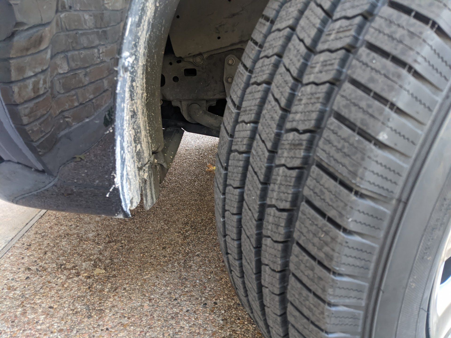

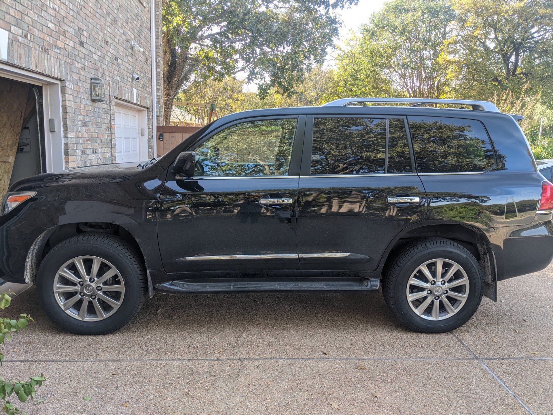

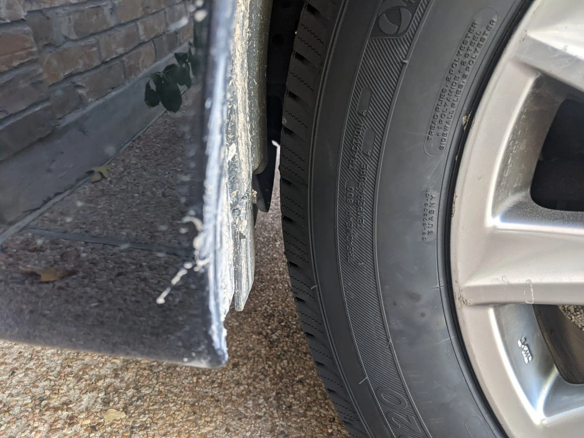

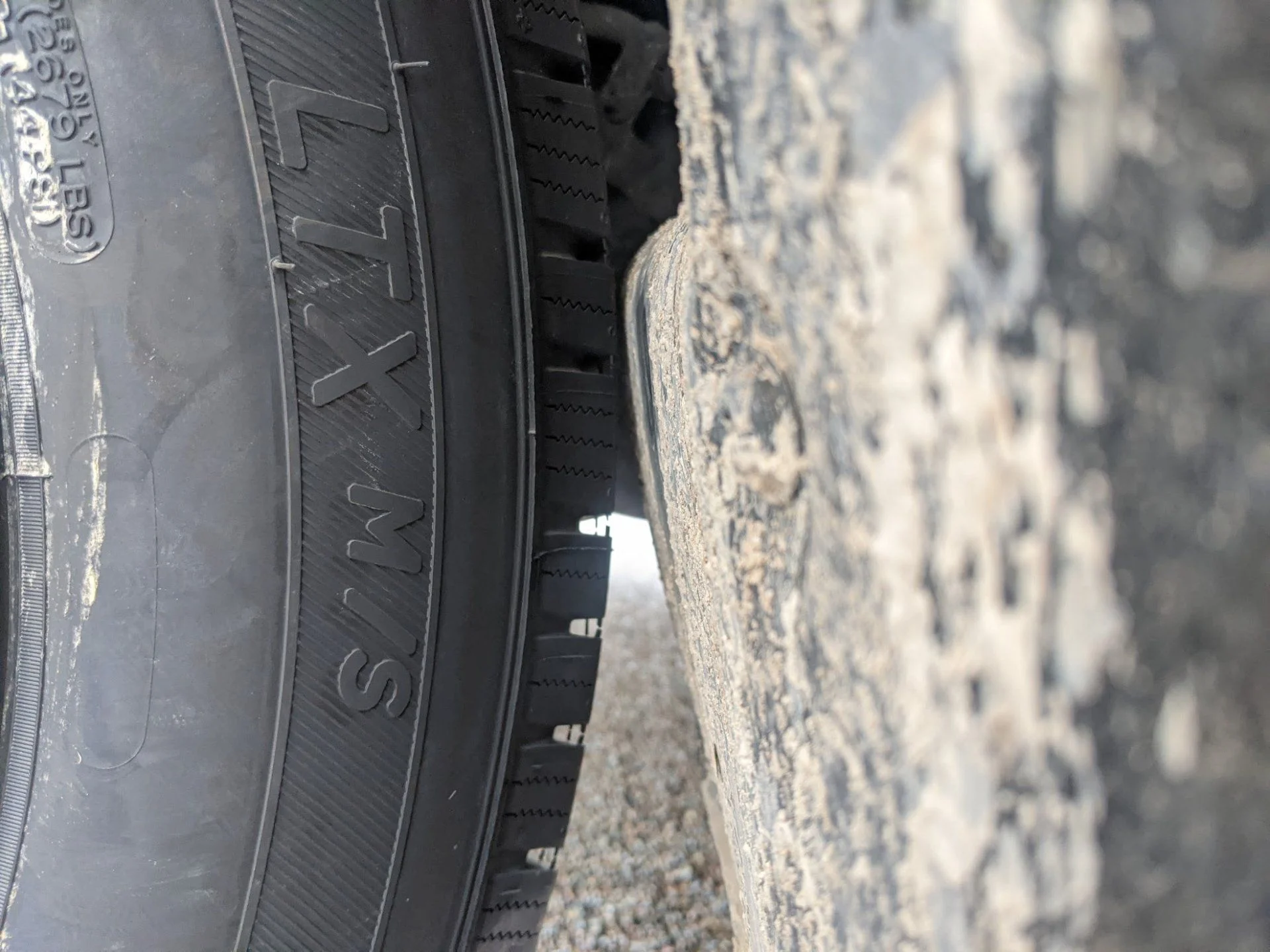

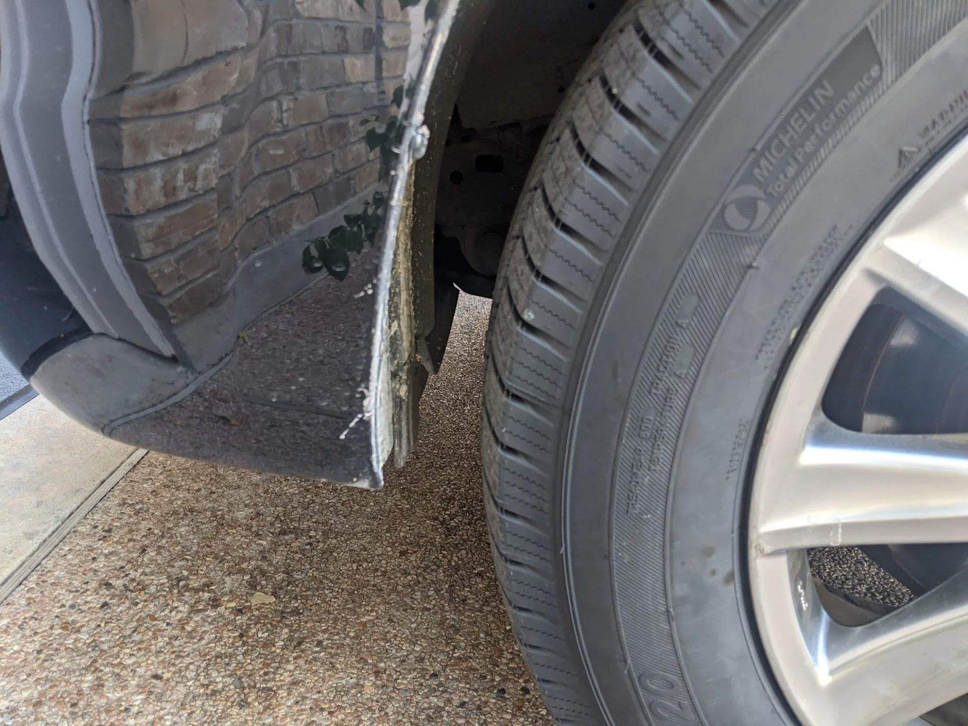

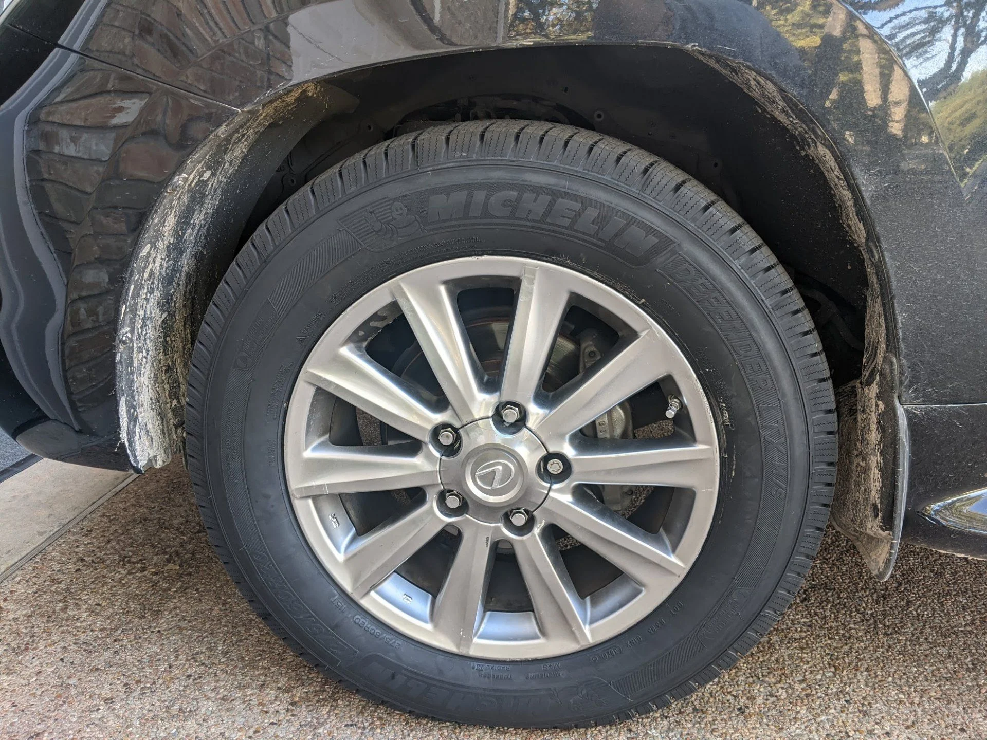

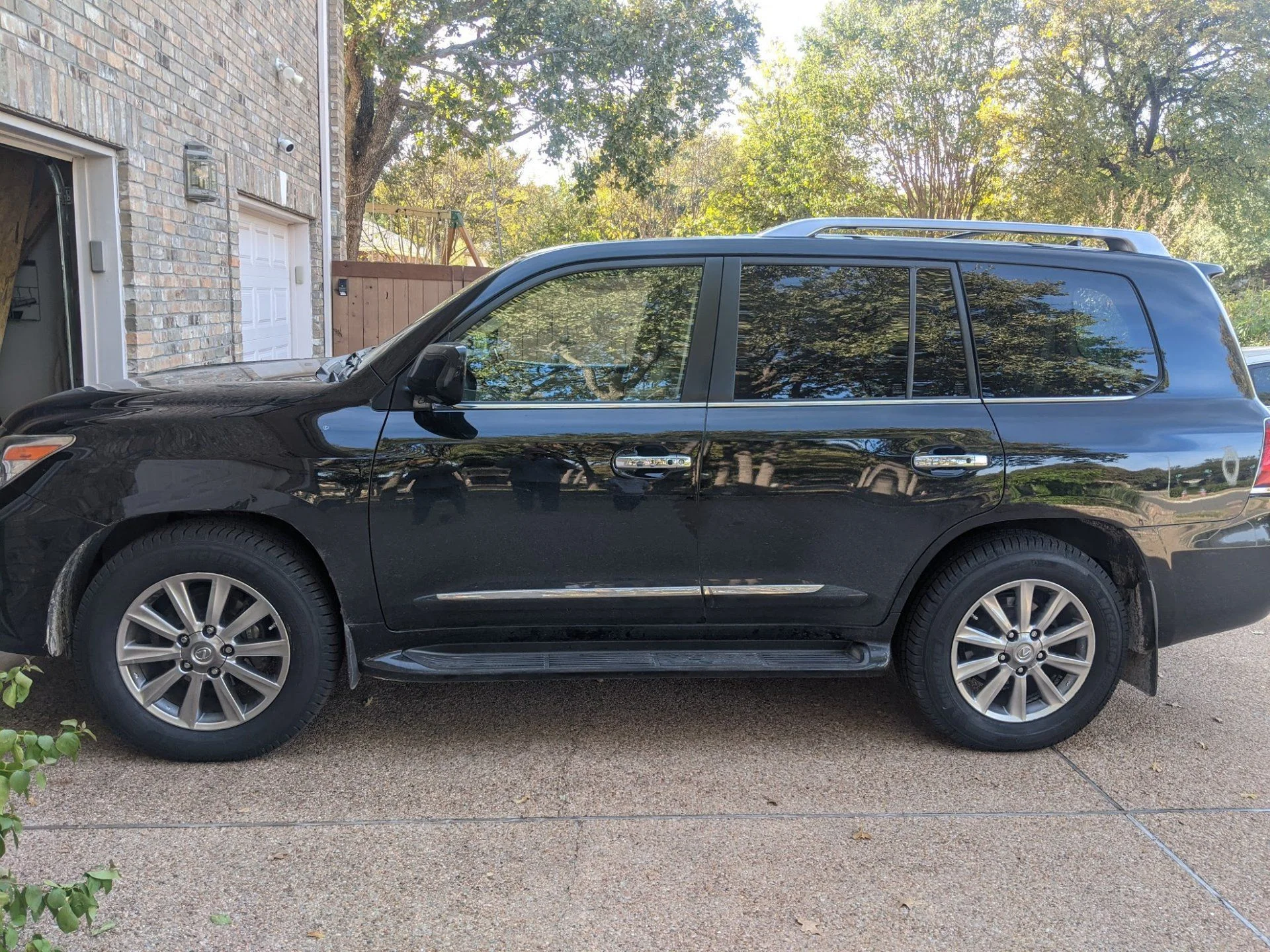

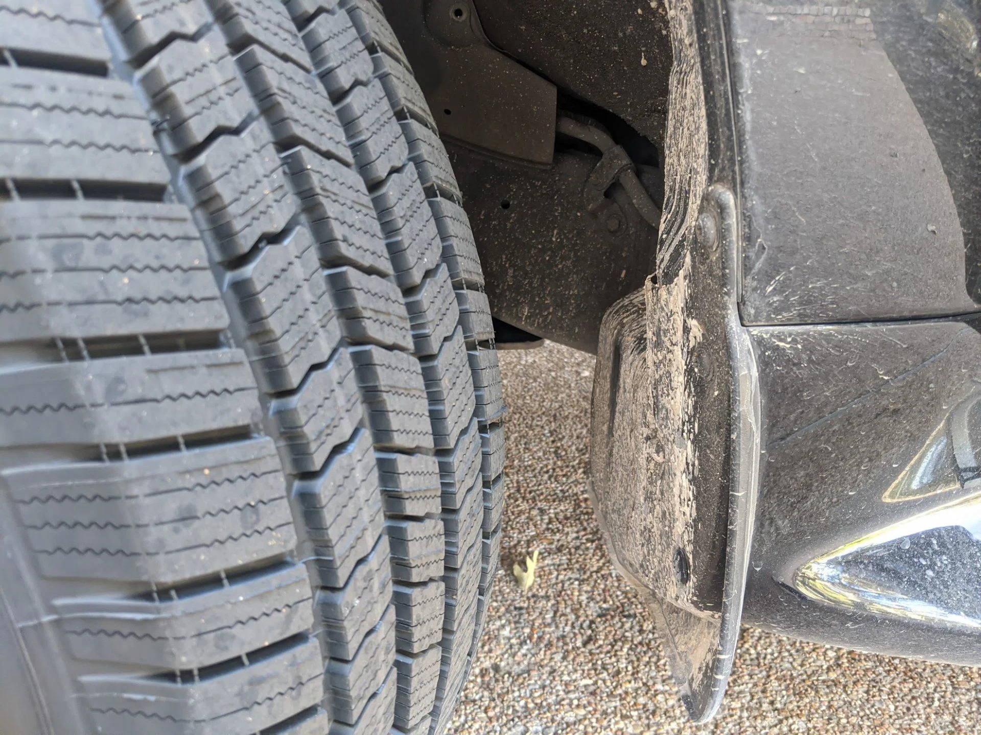

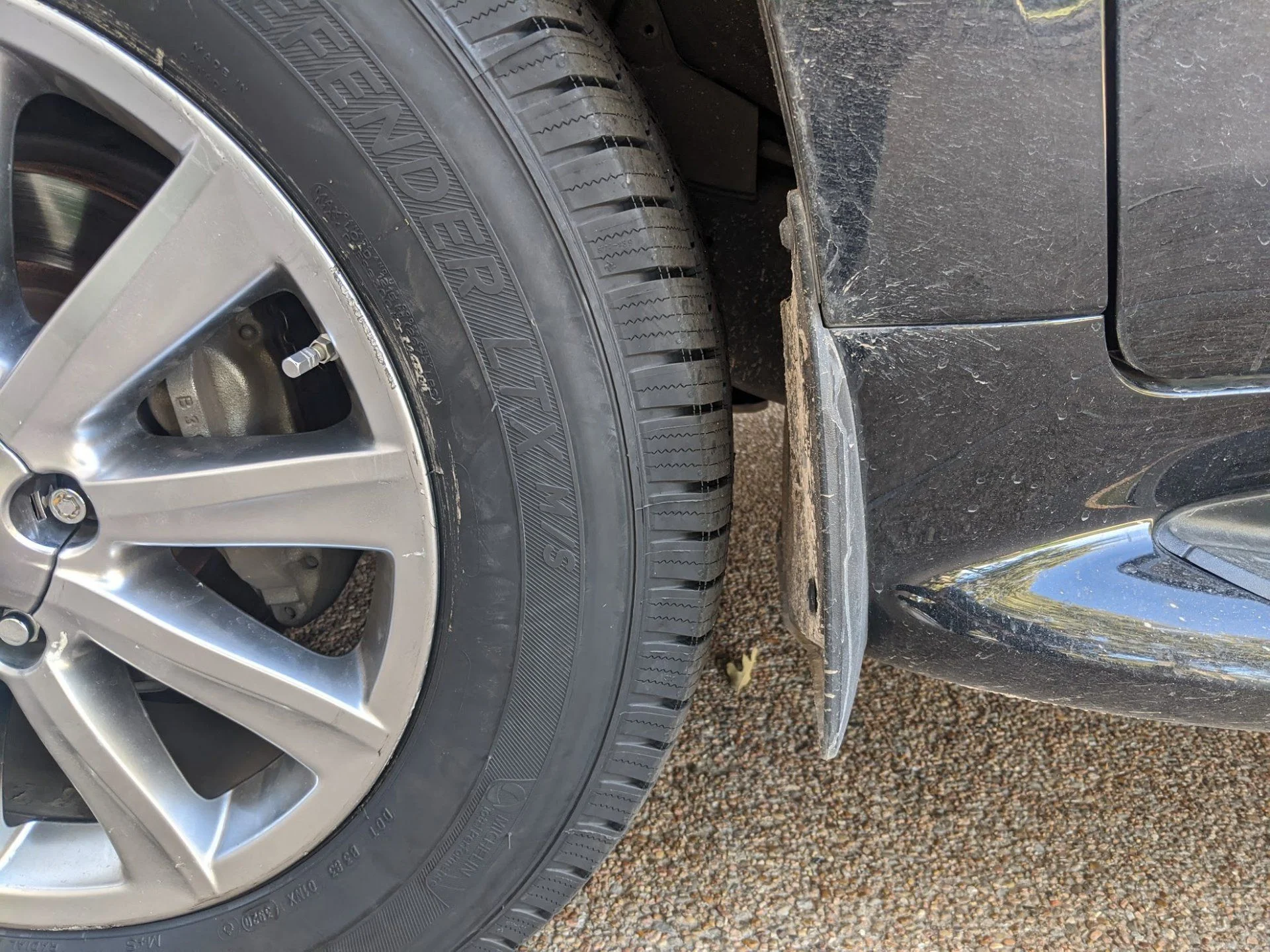

For sure.... Here are pics with the new 275/60r20 Michelin Defender's. Pics are in Low/Normal/High. And then back to Normal with the wheel turned all the way to the right and all the way to the left. The closest part is the rear of the tire when turning outward against the mudflap plastic, but it doesn't touch. If you went up to a 65 profile it would definitely touch and require a tiny bit of trimming, but the 60 fits with no issues so far.
And this is a photo of the stock sized Michelin Latitude Tour HP's 285/50/r20, in "normal" height.
And here is the BFG KO2's in "normal" height. They fit the same as the new Michelin's in the same size. They looked great. Handled well. And didn't balance well. Google around and you'll see plenty of others with the same issues with the KO2's. Just not quality controlled well enough for me personally. If I were in a jeep or something slow I may have kept them. But the toll road here has a speed limit of 80mph, and you do 90mph regularly. Even a little off balance or poor tread alignment is noticeable.
