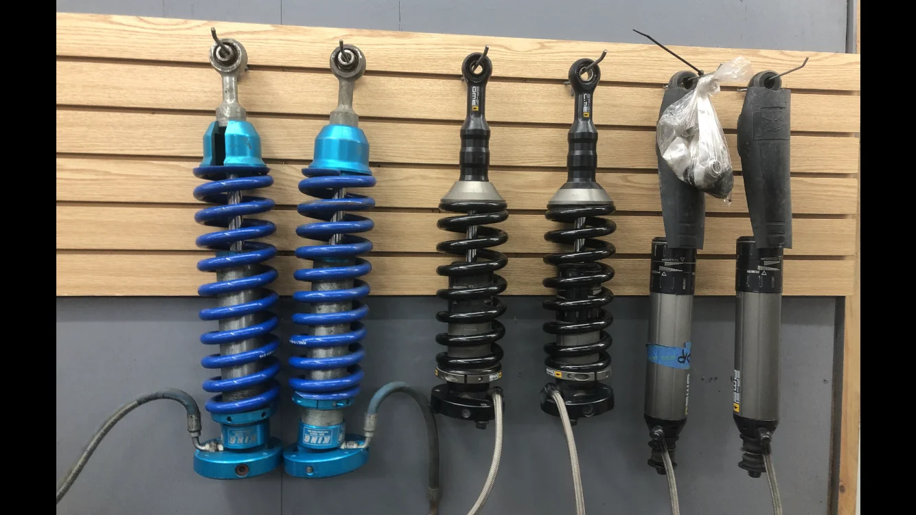

It only took me about 5 years to finally pull the trigger on these to replace my L shocks. After building up a long travel 1st gen 4runner and running a set of BP51s on my GX460 for awhile before putting on an accutune Fox 2.5 DSC kit (which is softer riding around town for stock weight but the BPs performed way better overall and were more planted), the 80 was long over due for a better ride. One of the last times out to the mountains I took my 80, it was a swaying mess on Pearl pass with horrible shock fade. Daily driving my 80 has also been just harsh compared to everything else I own so I’ve rarely opted to drive it anywhere.
Since slapping these on earlier today, areas on roads I previously avoided have become fun to drive over and these things are just soaking up chatter and holes with ease. My tires are around 45-50psi right now and the bump compliance feels as if they were at 15.
I was a little hesitant with my expectations on how the ride quality would be compared to the set on my gx460 (being a newer vehicle with ifs) but I’m very happy.
As they are more of a 2.0 shock in terms of piston size vs a 2.5 and they aren’t as easy to adjust as shocks with adjusters on the reservoirs, there are a few cons. However, throw in their reliability, hard anodized finish (which will stay looking good over time) and their internal bypasses, I consider them one of the best options for the price. I can’t imagine spending double for shocks and them being twice as good. Maybe less likely to fade in higher speed applications due to more oil capacity etc, but my 80 will never be used that way.
These BP51s were pulled off my GX and have around 50k on them with a good amount of winter driving. The Kings have less than that and you can see the bodies and threads getting nasty with corrosion.

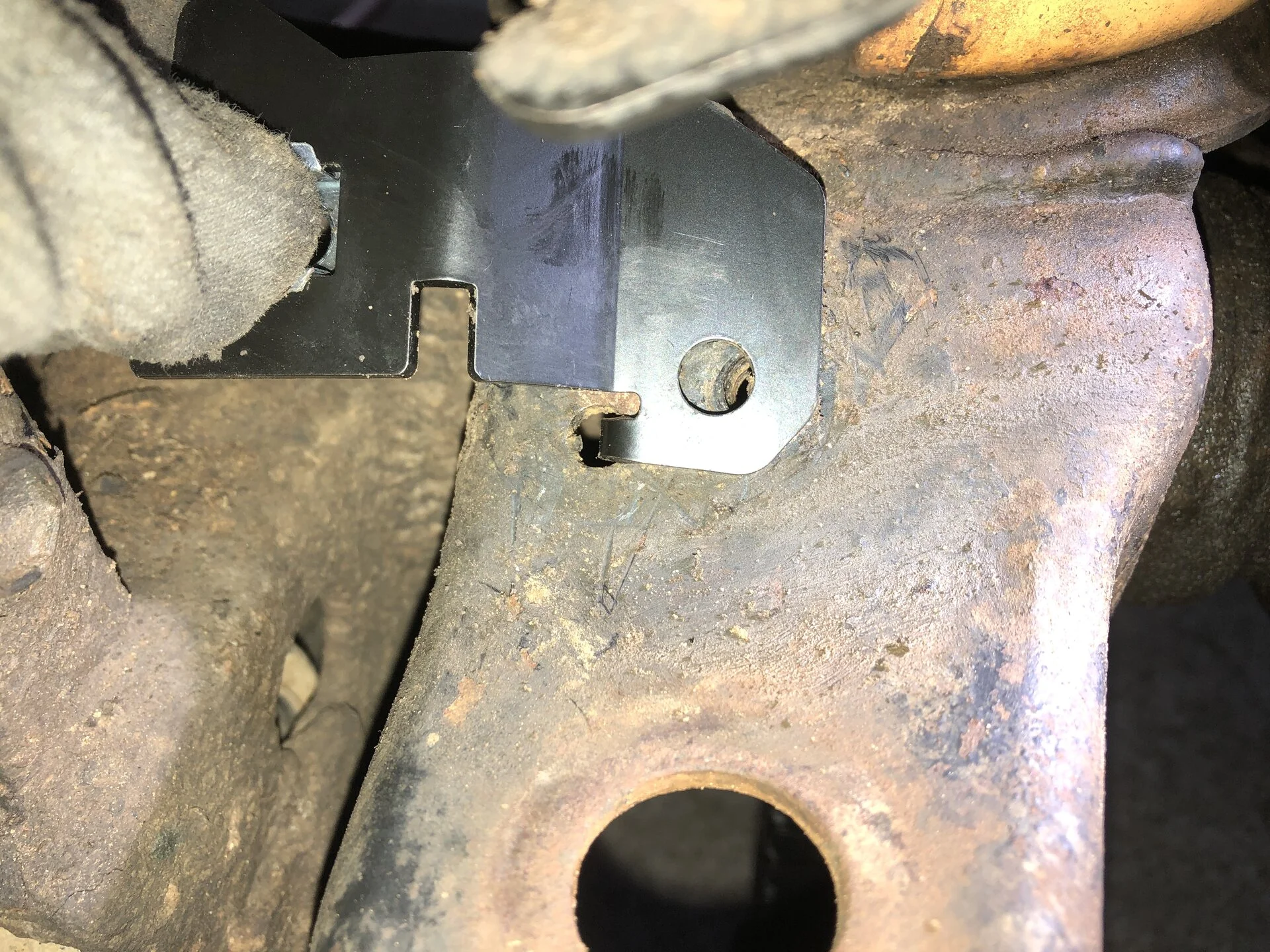

Oh and one thing that didn’t fit quite right on my 1992 were the brake line extension brackets. I had to drill them out to be able to install them. The mounts also didn’t fit as intended on the new landing spot and the hard lines may also be a smidge different as bending the driver’s side line out of the way was a PITA with its bends already in place.

Fwiw, they arn't more of a 2.0 shock, they are exactly a 2.0 shock. The 51 in BP-51 is diameter. 51/25.4 = 2.0079. I think we can call them exactly 2.0 :D
The precise side of me needed to distinguish that they are metric and not exactly a 2.0, but if we are rounding I’ll agree with that. I’m a big fan of my BP2.0”s haha
7.87 thousands of an inch is close enough for me :D
Just got done installing my BP51s on my 95 and ran into the same issue. I'm not convinced those brackets are necessary with the SS brake lines I have so I left them off for now. I just can't see how they matter. Care to educate me?
The purpose of the brackets is to move the brackets/connections out of the way of the shock body with its larger diameter so they don’t crash into each other on big compressions
Makes total sense now that I looked at it. A little massaging of the brackets and they're now installed. Thanks!
More like 1.5 due to the internal bypass design.
Apologies I misspoke. Many claim it to be a 2.5 but due to the internal design the piston is much smaller so yes 2.0
Nobody should be claiming 2.5", it's exactly 2.0", so much so they put it in the products name "51" :D
I don't disagree but people compare a shock body to shock body often ignoring the internal measurements, hence why its often called a 2.5
Well that would be inaccurate as well. The common BP-51 shock body OD is 2.75" :D
