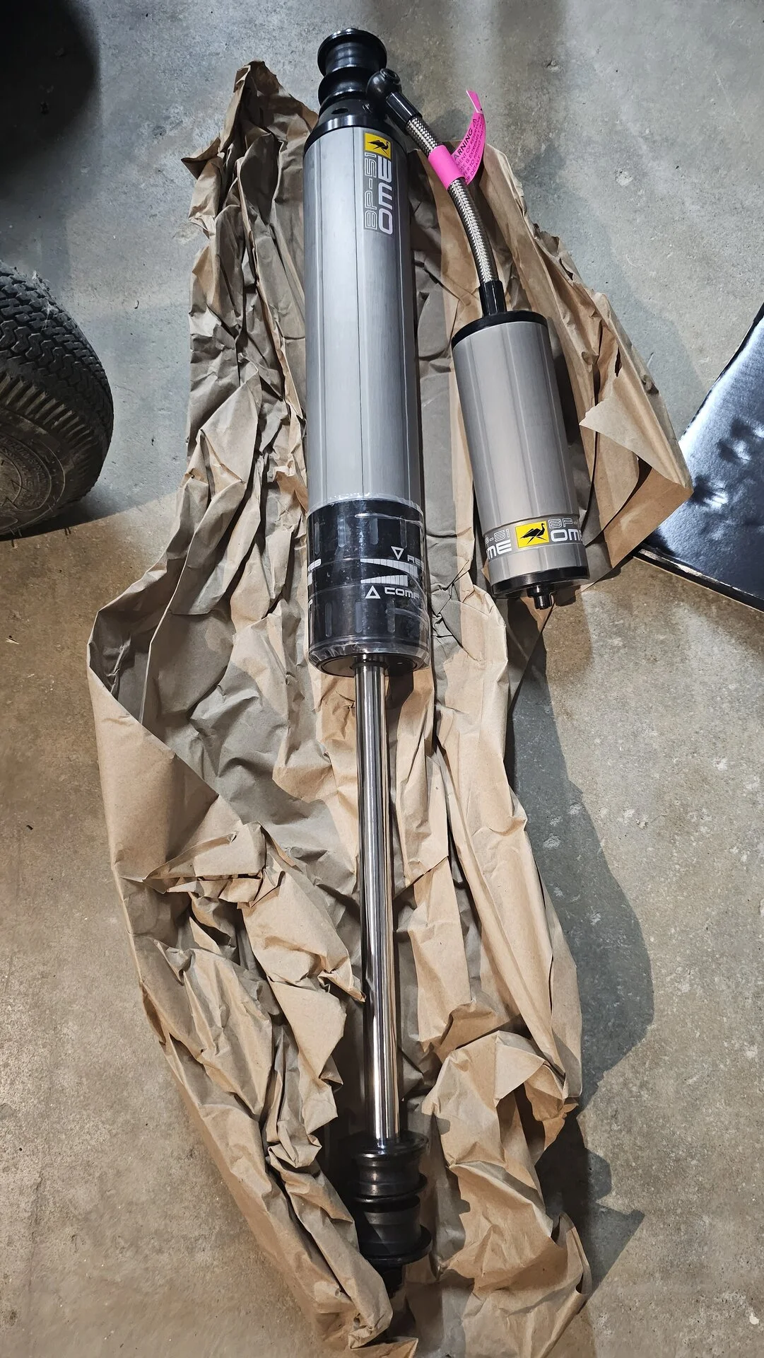

Just picked up these bad boys with a set of J Springs to go around. Sourced by none other than @cruiseroutfit - these shocks are much larger than they look in the pictures!

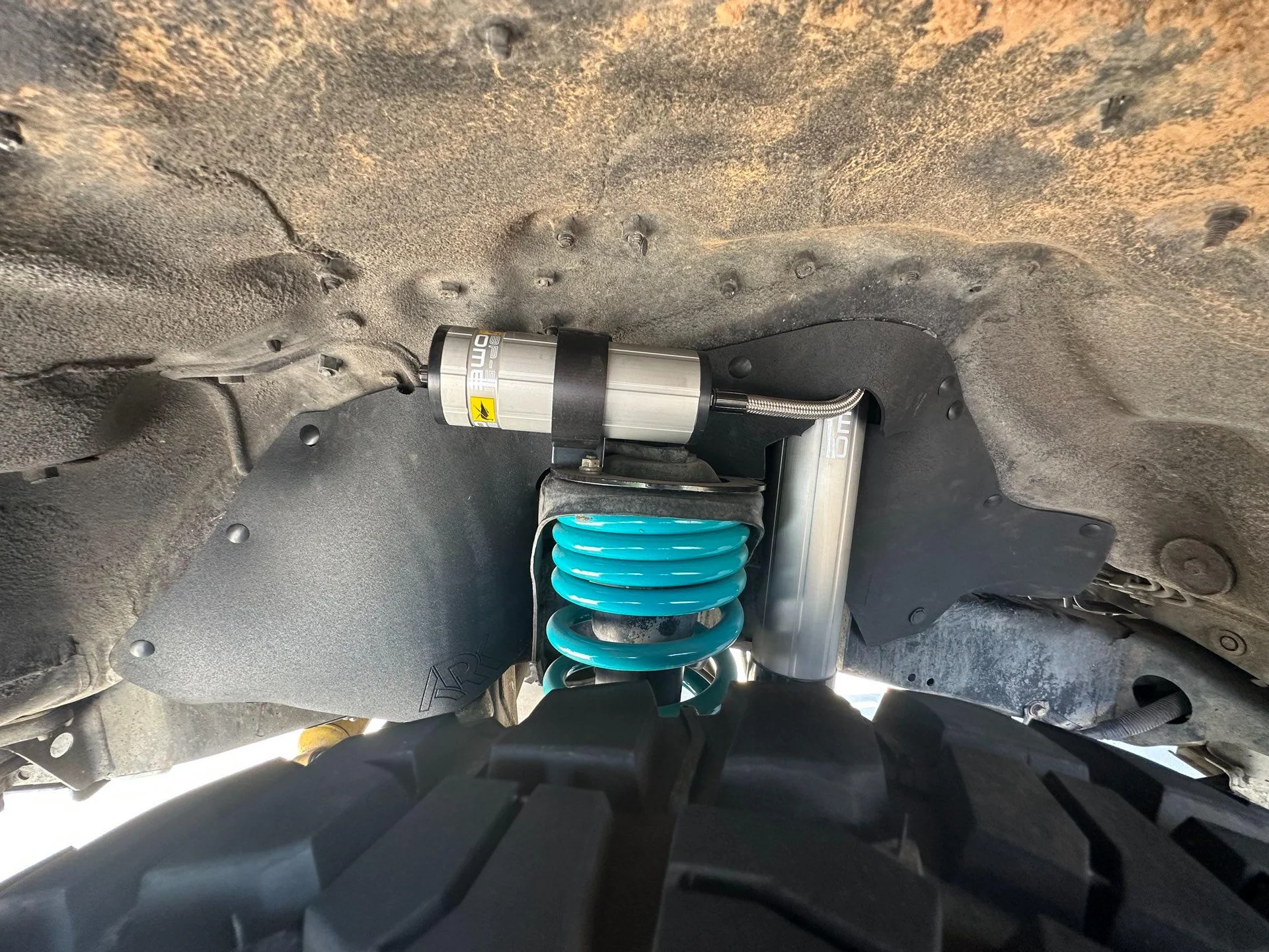

Does anyone have any pictures or where they mounted their reservoir in the front and rear? Trying to keep the fender liner intact.

ARB has a kit for these to mount the resi's
Here's a picture of what the front looks like:
I think they were an add on, but I don't remember :doh:
That looks clean.
Let's see if we get any other mounting input from the team...
Edit: Confirmed that is the included mounting solution when purchased as a package deal from Cruiser Outfitters.

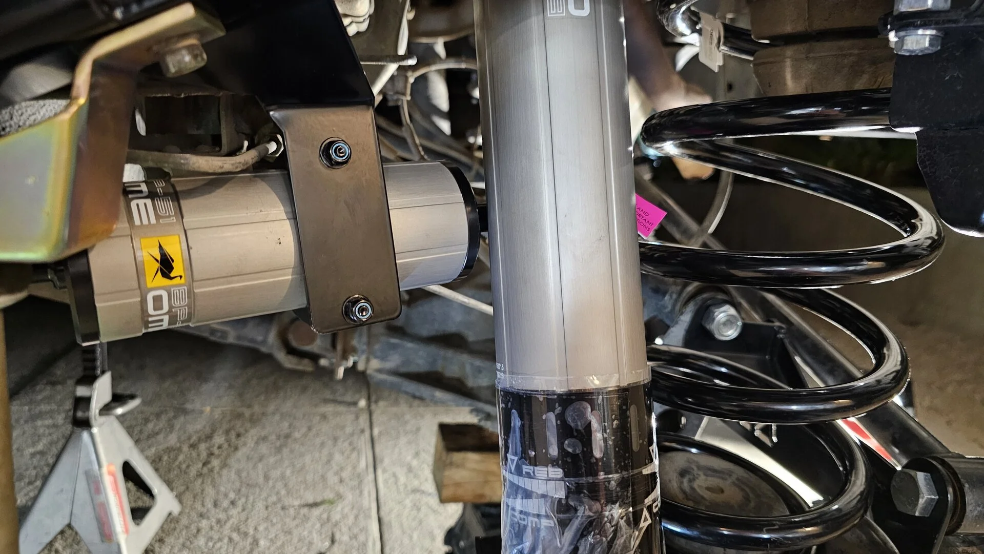

BP and J Spring install going smoothly so far.
Sorry if I'm hijacking this thread with my install questions. Figured it was best to keep a single point of reference going for all things BP. I can start a new thread if that's preferable. Just let me know. Thanks!!!
3 Questions for anyone that can help.
1.) The picture below is the Driver side rear. (Haven't gotten to the PSR.) It looks like the reservoir is pretty close to the upper shock body. I looked at the measurement spec on the instructions, but if I try to accomplish that it actually touches the shock body. Can someone advise on their setup?
2.) I placed the included washer/mounting hardware on the lower shock mount as described. However this pushes the very short lower shock bolt just barley to far from grabbing the threads. From what I can tell. Have any of you been able to use the OEM bolt and still kept the two large and one smaller washer on the backside as per the instructions?
