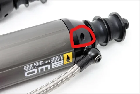

anyone having issues adjusting these? They want to turn in the perch....
I stuck an allen wrench in this hole while using the supplied adjusting tool to turn and adjust the comp/rebound.
