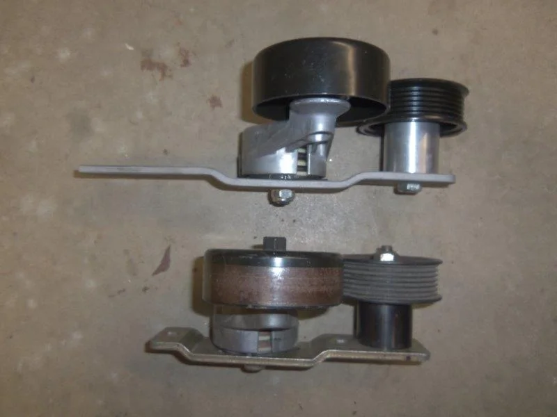

that is some nice fab-ro-ca-shun!
get a buddy with an end-mill and machine a piece of steel bar stock and mill it down to the proper dimensions if you couldn't get a piece of strap broke like the original and the duplicate piece above.

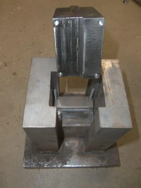

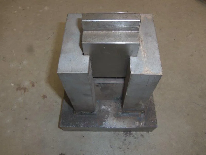

Thanks. I made this press to create the bends. I made the dies with the correct offset and depth for the material thickness. Springs hold the die open.
Bill
