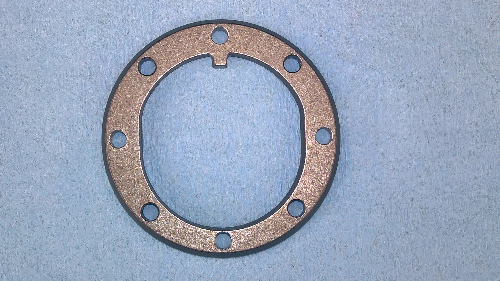

Again, due to the design of the rear hub lock nut/thrust washer indexing, it's not really possible to be exact. I'm not really sure what the engineers were thinking when they designed this.
@Kernal had the right idea by adding 4 more holes to the thrust washer to be able to set preload a bit more accurately.

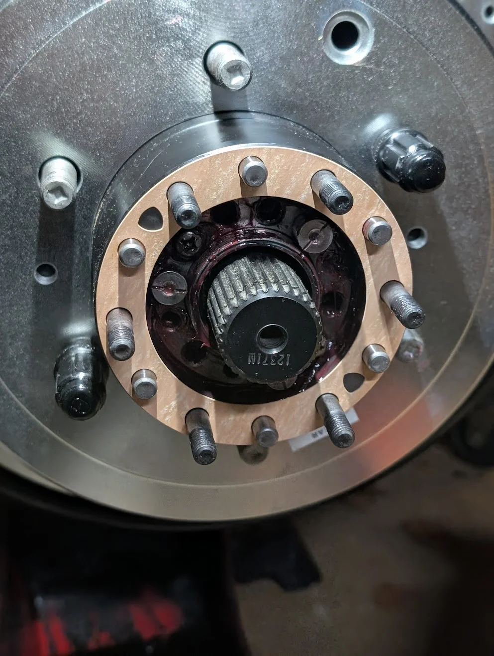

OK, mostly understood.
The picture shows a stub axle sticking out. Does this setup require a drive plate like the front? The RCV website provides no installation information, and I have reached out to them both on their tech support web form and email with no response.

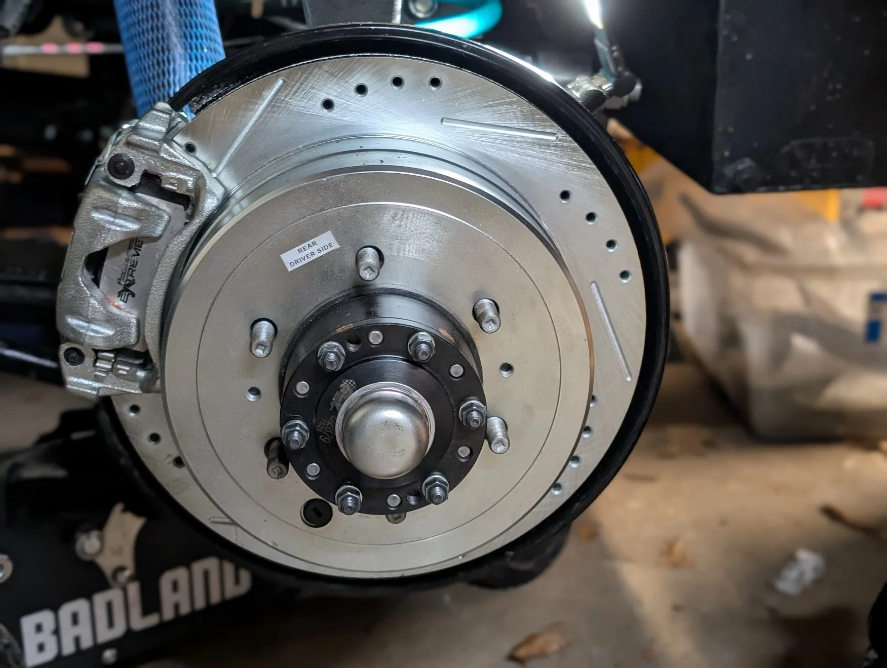

Yes, it uses a drive plate like the front and a dust cap. Here it is all buttoned up.
