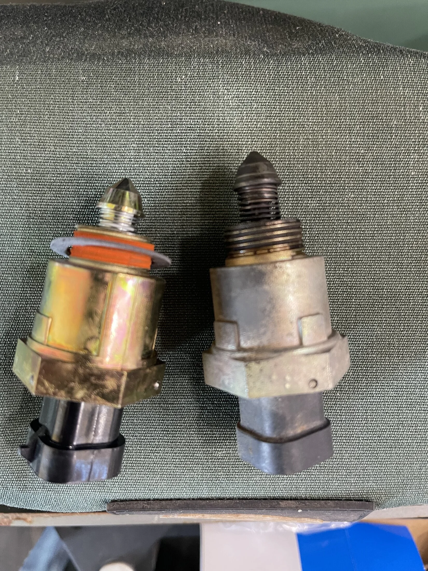

New air idle controller valve replaced. When touched old one with wrench it turned, turns out it was wasn’t even finger tight.
Idle smoother and higher but had settled down after I shut her off and restarted. Now darn battery dragging after short bit of cranking. Gonna test it here shortly.

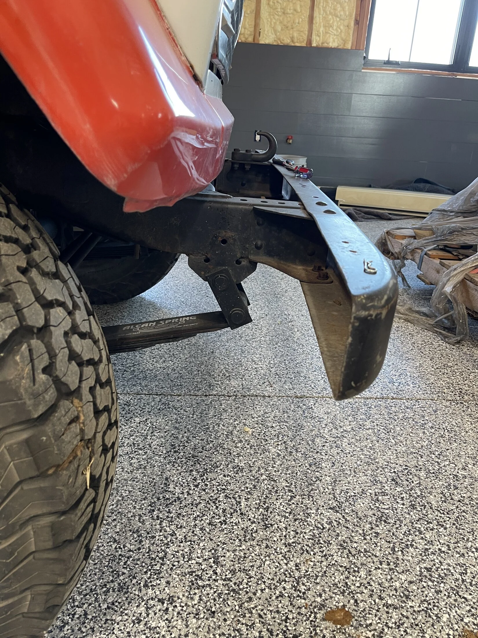

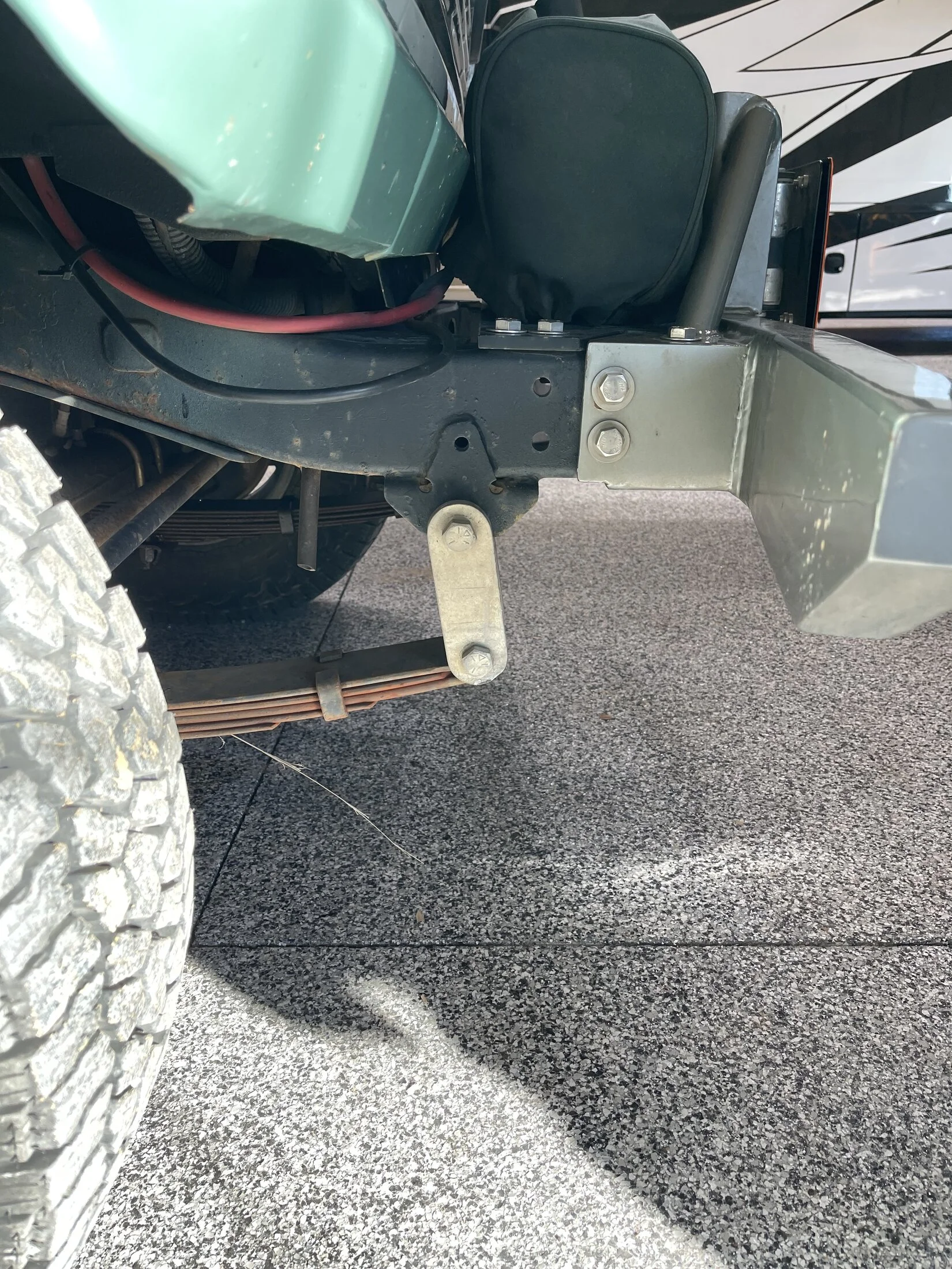

Did check out Bonnie shackle angle, think we’re good!
Clyde, he is not perfect.
Bonnie’s shackles look longer than Clyde’s. If Clyde had the same length shackles, the angle would be closer to the same, but as it is the angle isn’t too bad. It’s further in the positive action zone than most are, but not bad. Are there any caster correction wedges on Bonnie?

Agree rush, no wedges that I see.
Yeah Delancy apparently had Alcan springs made years ago. I too had them make some for 69. . Since the body of 69 going on Chris’s 76 chassis in future it would only make sense to swap those new alcans on the 69 to Bonnie.

Clyde looks about as close to perfect as one could get on a stock'ish pig front end to me. I wouldn't mess with it.

Shackles are an inch longer than oem at one end and half inch at the other. Don’t recall which end is which. Thought we put wedges in the front. Homemade lift with the slightly longer shackles and Man-a-Fre add a leafs put it up a little over two inches. All pieces from miscellaneous parts buys. Always rode well and tracked straight. Also did a double cardan ujoint to get rid of some driveshaft vibration. Extra 7 1/2 inches of the overdrive left quite a rear angle.
So the idle control valve fixed the idle issue?
What little I got to drive her today around property it didn’t surge like it had previously. There very well may have been small air leak with it being loose like it was.
