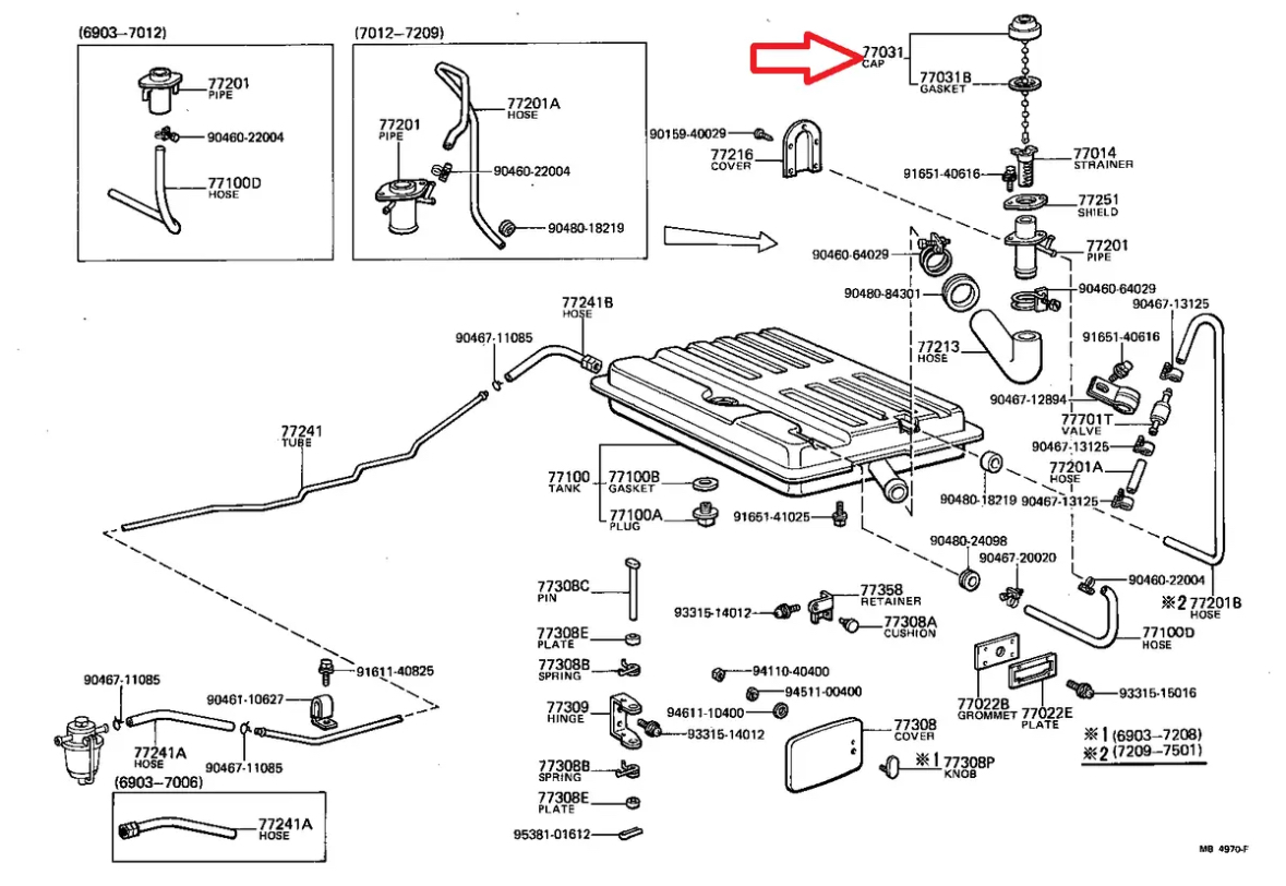

That is weird. Only two vents as opposed to five. Is that odd little threaded nipple supposed to be the fuel pickup? No return line?
No return line only overflow from filler that I can tell.

Here’s another diagram I found to accompany the one @bobm posted. This one shows a different style filler neck with a nipple coming off 90° of the other one with a check valve in line to the other vent.
Rush agree with your statement, must be some venting via the gas cap.
