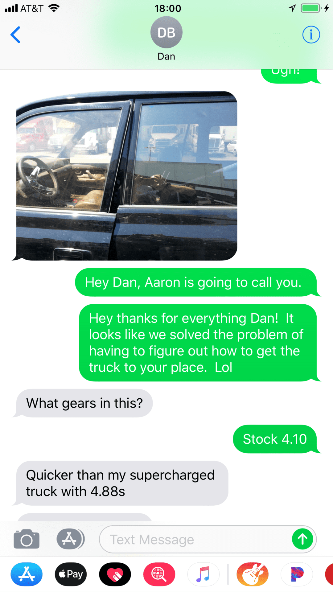

For you turbo non-believers ;)
I sent my trucks out to SLC and Cdan is driving them home for me. I think he was surprised on low boost (10psi) it is quicker than his TRD SC with 4.88 gears.
