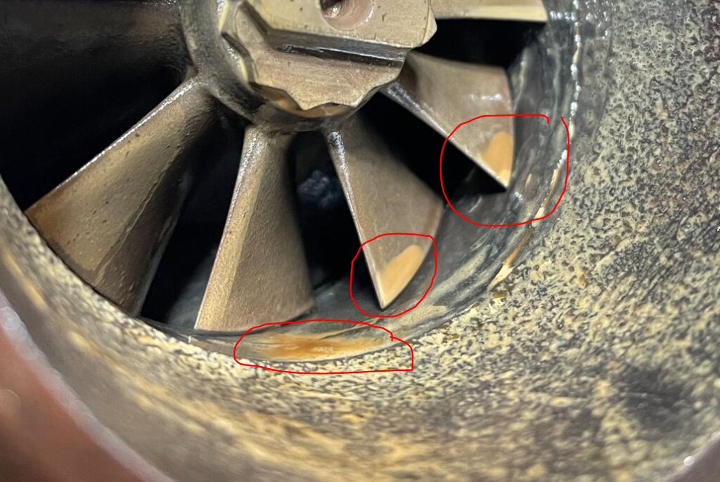

I'd be cleaning out the rest of that coating in the exhaust housing myself. Don't want that crap flaking off into full tilt turbine blades IMO.
I plan on it. I'm more concerned about what the hell it is and why it's coming off... I tried to email Borg Warner but only could find a general "contact us" page. TBD on that...
My first thought was ceramic coating. But, you did not have these coated, correct? The turbine housing should be as cast.

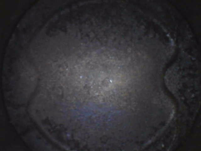

Going to stick a bore scope down the plug holes and see if there’s anything telling in the cylinders.

Well… had the turbo on my cruiser with a fresh rebuilt 1fz. Took the turbo off during an overhaul and noticed condensation (sludgy) on the exhaust wheel, as well as chipping of the lining around the exhaust housing. Anyone seen this?

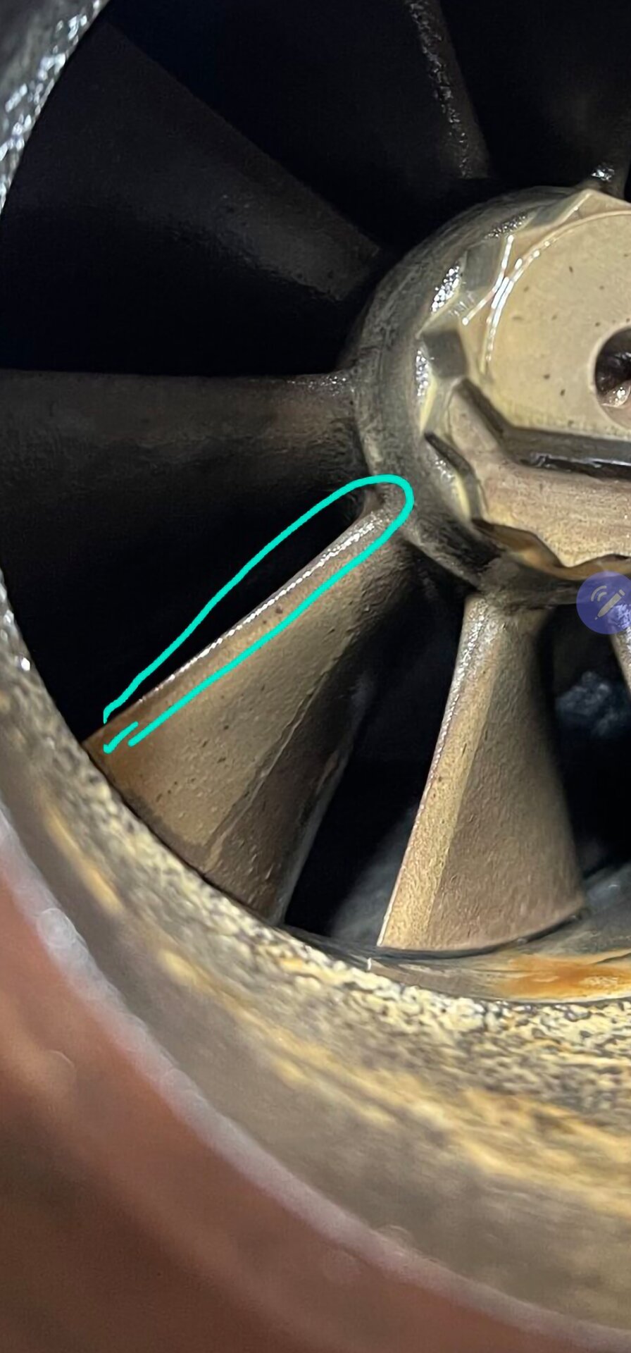

Is it just me? Or does the leading edge of all the blades look polished/ eroded
Also, that's a heck of a grind to balance that turbine. Unrelated I'd guess
Looks like coolant/oil mix to me and just reflection of light in the photo.
Maybe. Any turbo I've had in my hands, the blades have been consistently sooted over.
Water mist sprayed into a system preturbo erodes compressor blades.
If there's droplets of coolant hitting the turbine, they'll act to abrade the blade tips eventually

I did my ME internship at Garrett Turbochargers in Torance CA. They used the interns to collect measurements on prototype turbos, assemble them, balance them, and deliver them to the test lab. After testing we tore them down and collected all the measurements again, putting them into spreadsheets. I was amazed how much material I had to grind off sometimes, on both ends. But, balanced is balanced, never saw a correlation to bearing wear on after test units.

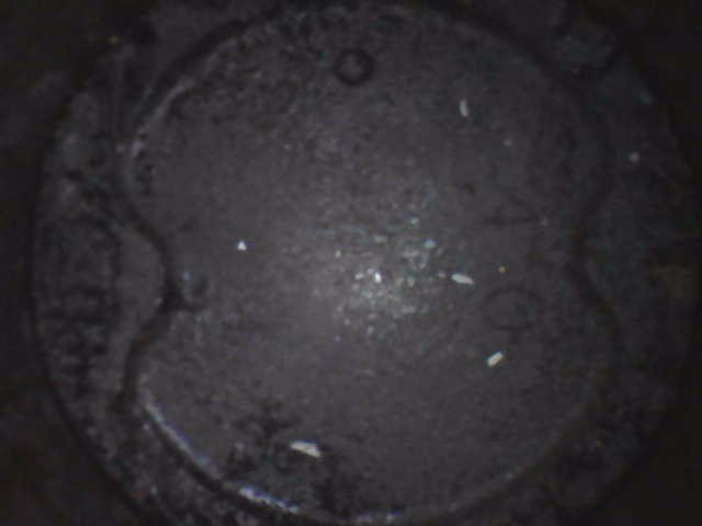

I ran the borescope I have last night. Resolution of a potato but I'm not super stoked with what I found. The still images I took don't seem to show what the videos do. Heres the pics for start, but I'll try and get better ones/videos posted. I'm curious if anyone else will run into this with their boosted setups.
in order 1-6 below. Note the little flakes in the middle are valve cover paint that fell in the tube holes from getting baked off, not metal shavings. Though the black carbon/other areas its hard to tell if its pitted or not. .

(number 6 piston)
Also, I did finally get ahold of Borg Warner today. If you need to call them the best line is 833-250-6306. I sent them the photos of the flaking and they all seemed to scratch their heads. It COULD be rust flaking due to moisture, oil thats been baked on, or a defect. I have to go through a 3rd party to attempt them looking at it. They were super responsive and I explained the *WE* situation and they offered a contact for a local vendor of theirs. I can't go directly though BW for any parts or inspection.
