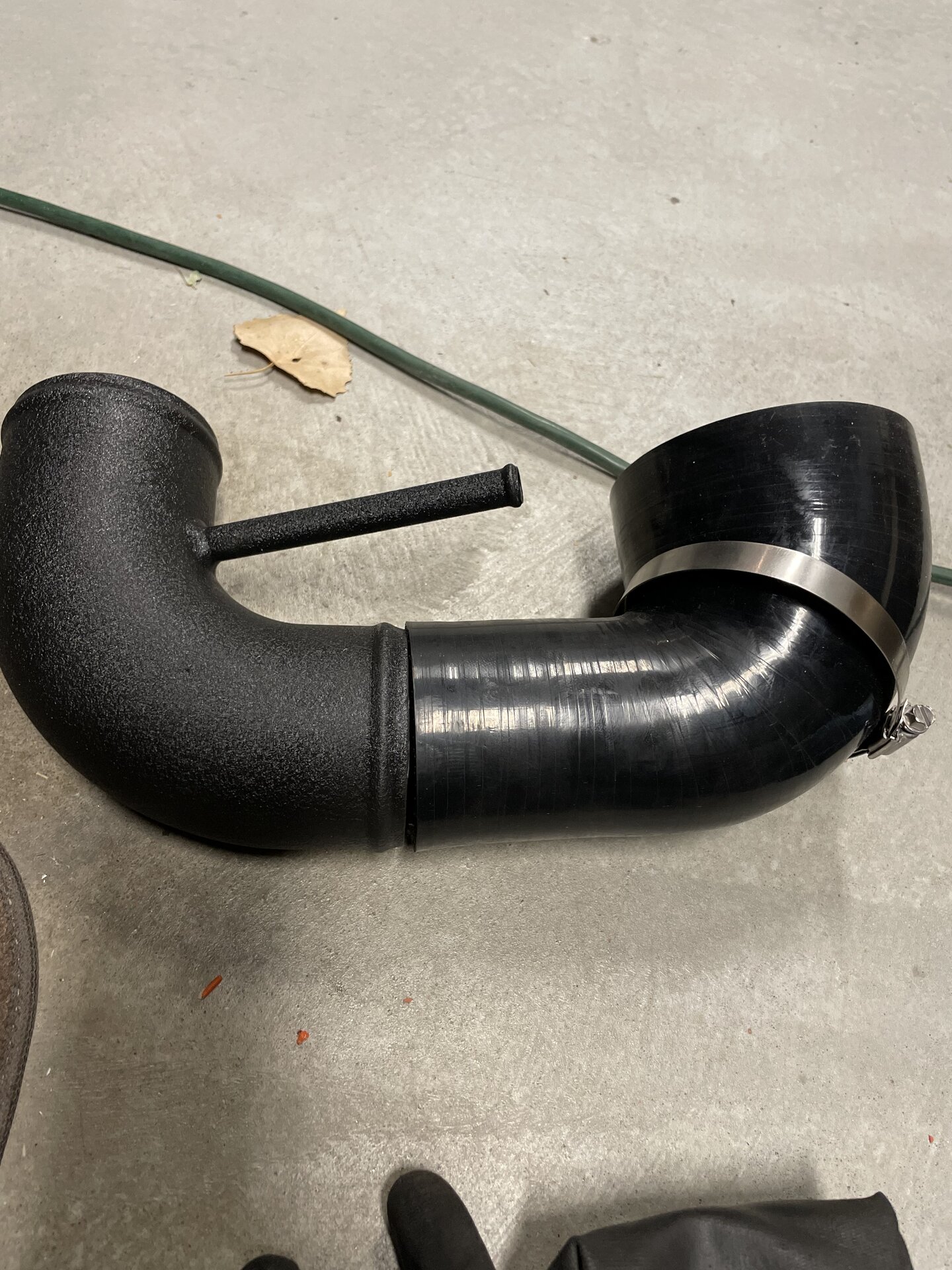

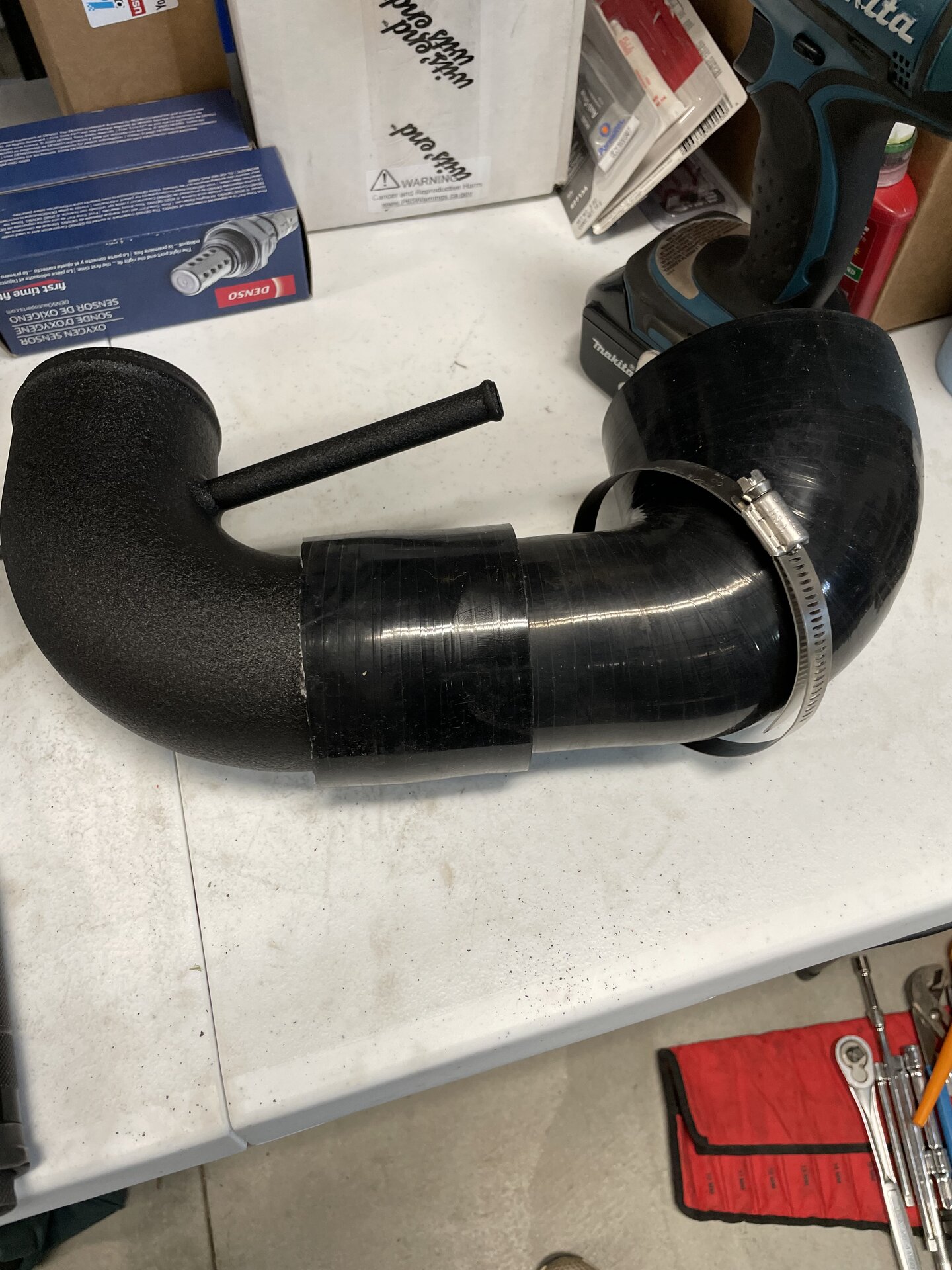

Also - my kit came with the wrong size intake hose that attaches to the turbo itself. The smaller end was made for the wrong diameter. I was able to use a cut piece from one of the other tubes to make due while I waited for a replacement, but I'm tired of the HVAC tape sealing it up.
Does anyone have a good source for me to purchase a new 90* silicone intake tube?

You can usually order them easily off any racing site. Summit, even eBay. That is weird though. I’ve bought mix packs of silicone hoses off eBay and cut them up to make due before.

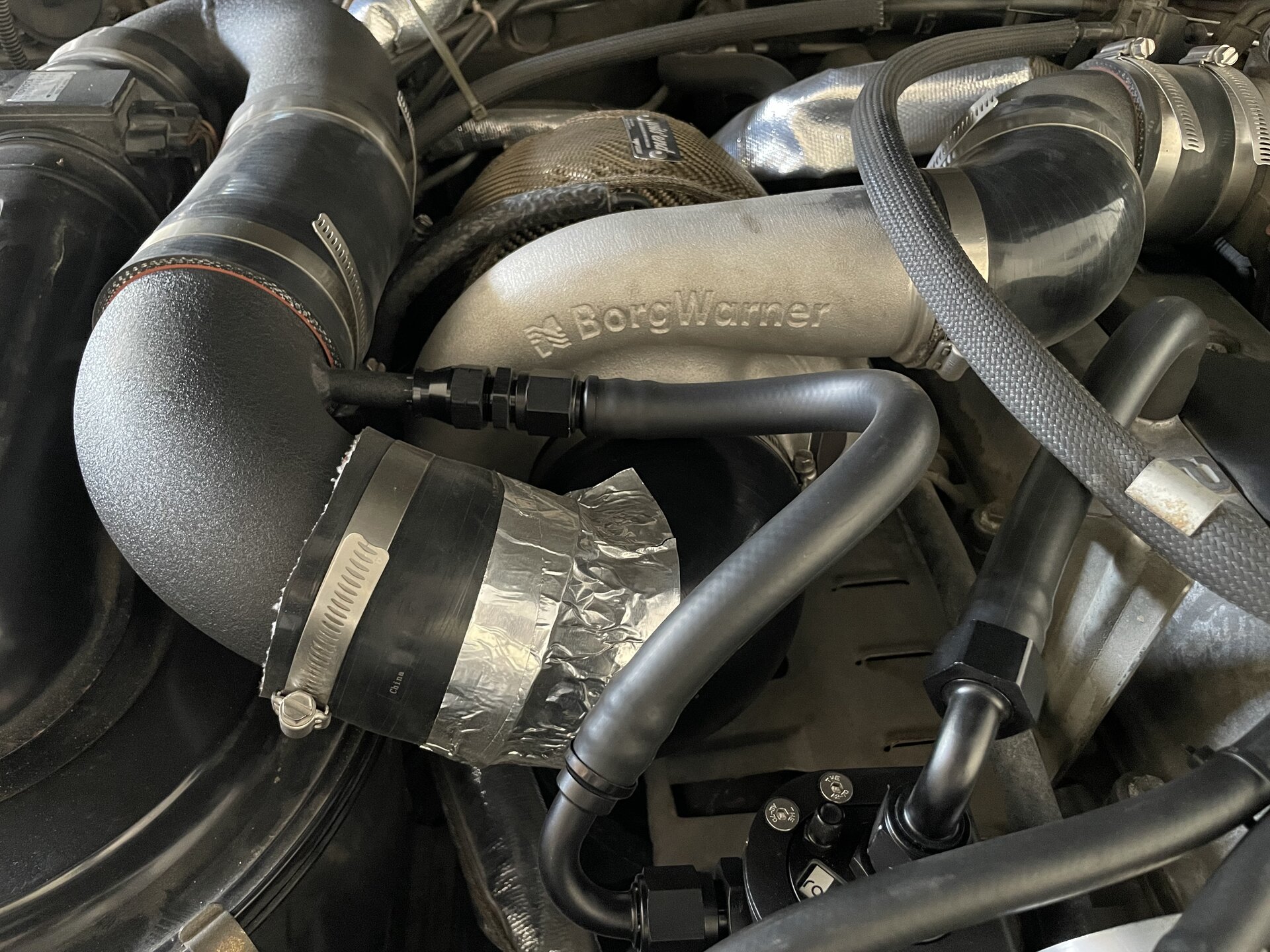

What setup is that you’re running for a catch can?

I just ordered from Siliconeintakes.com
Website seems outdated, but they ship quick and have good components. Their T bolt clamps are priced good.

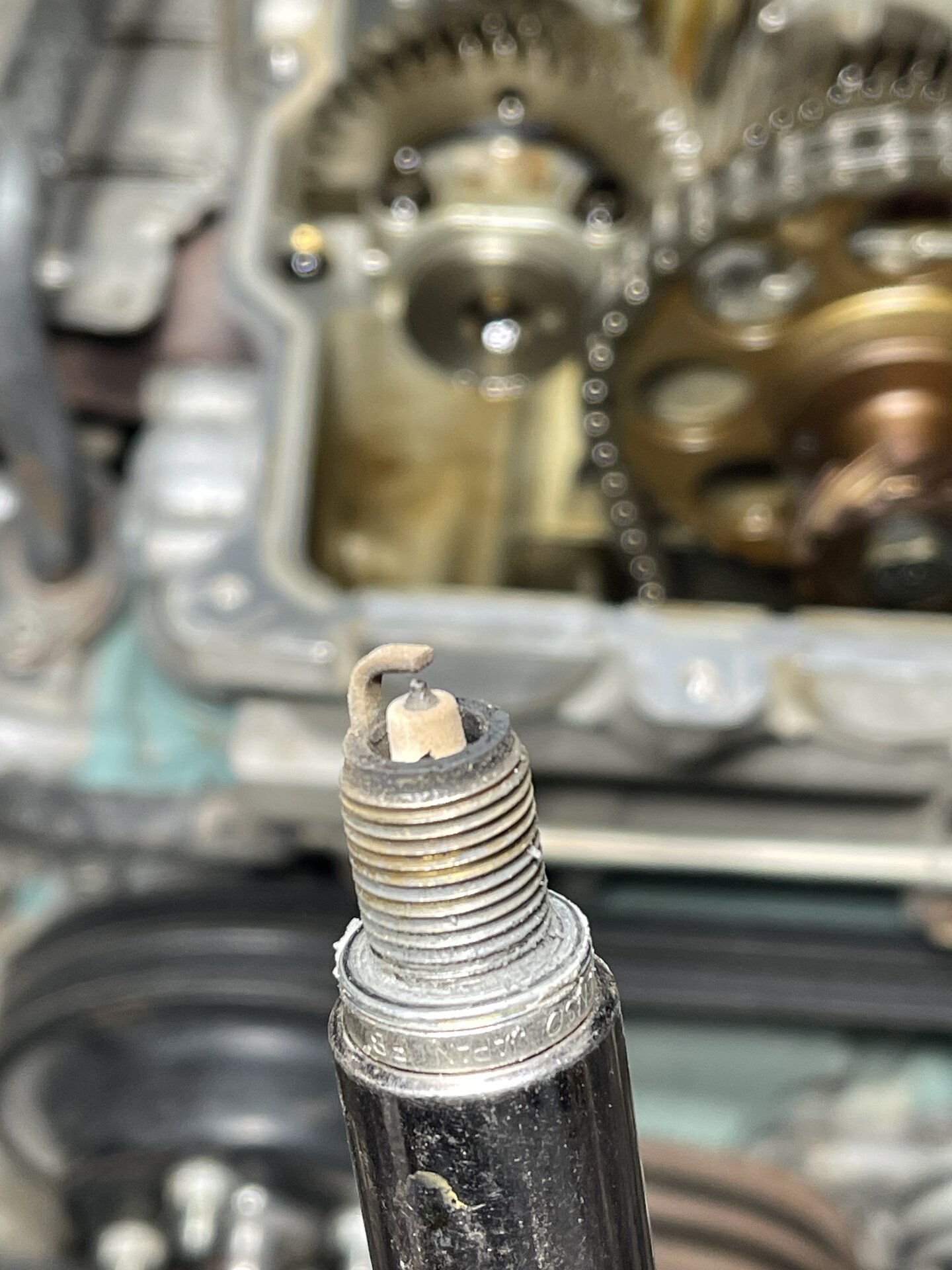

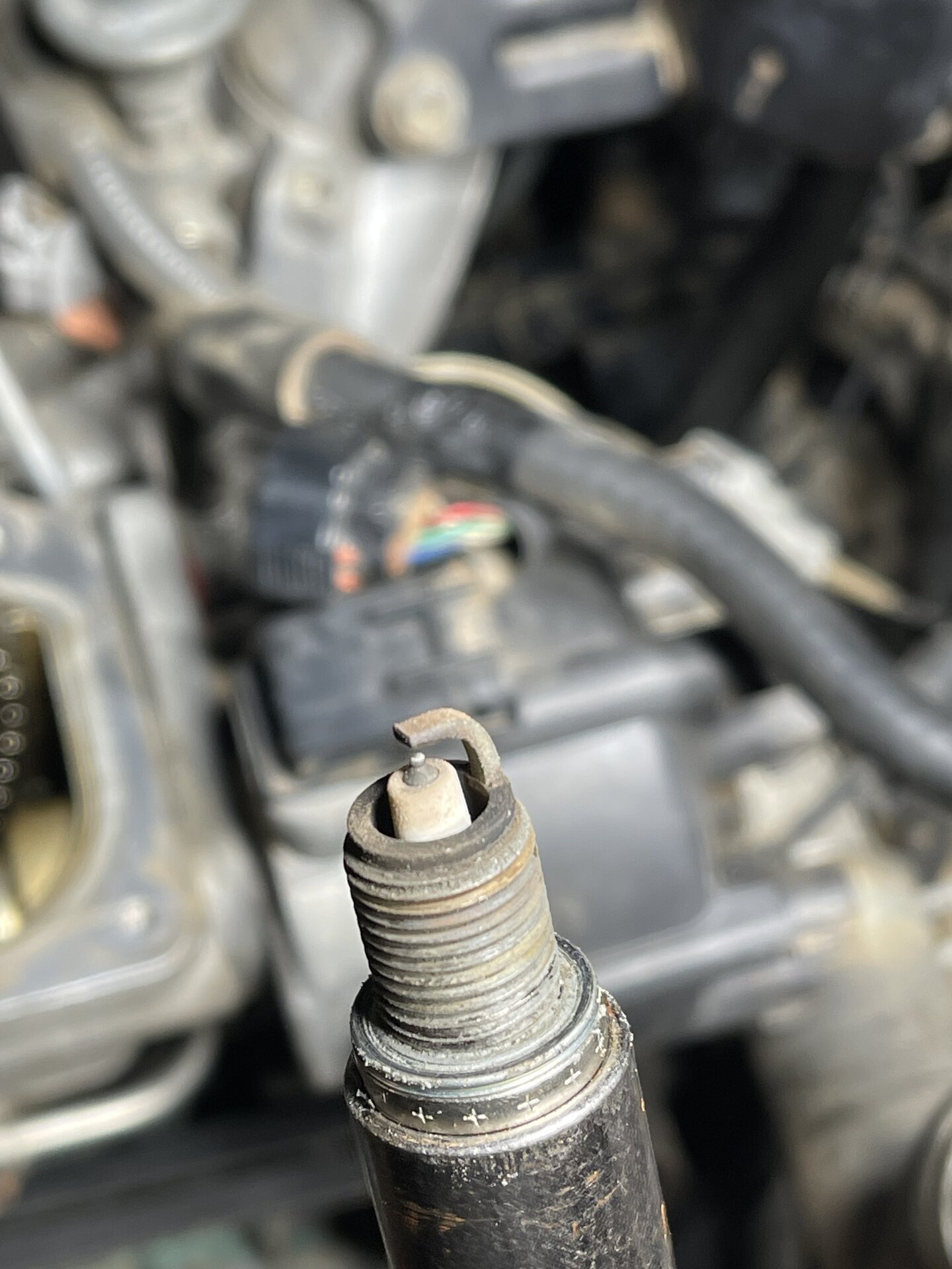

Also attached are pics of the sparks 1-6. At first I thought HG had gone but no coolant in the oil.

Plug color looks good but the melting of the electrode is troubling!
Detonation maybe, borescope your cylinders would be the next step.
