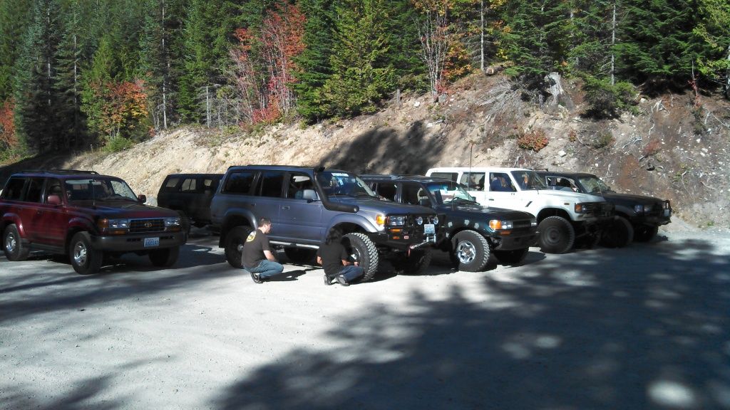

Here are some pictures from our Naches wagon trail run Mike put on, What a great group of guys and gals.

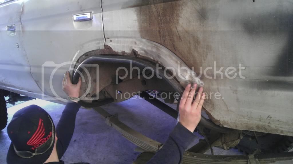

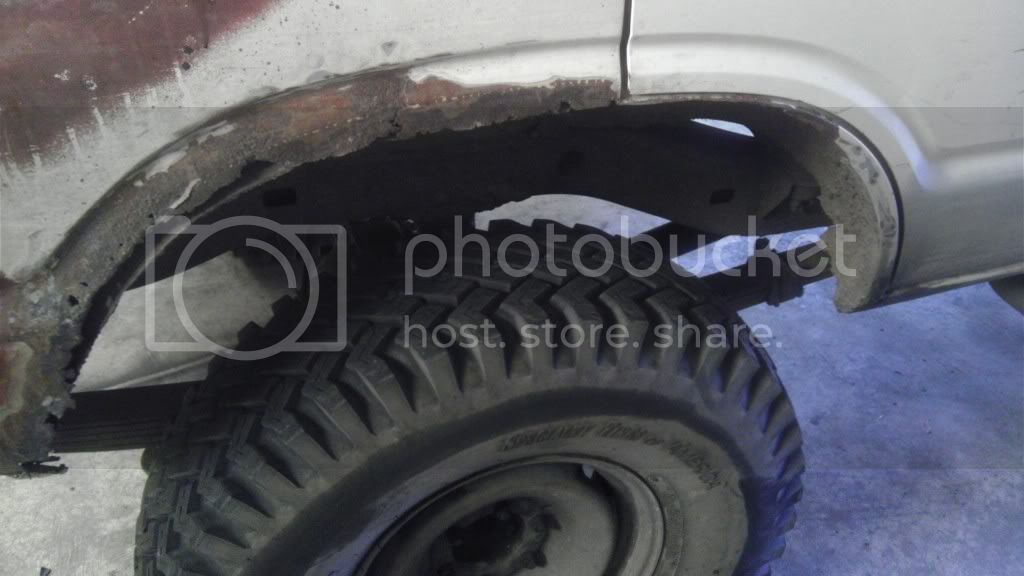

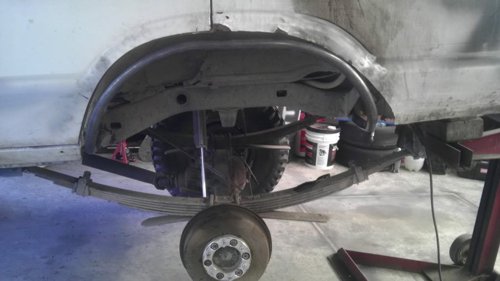

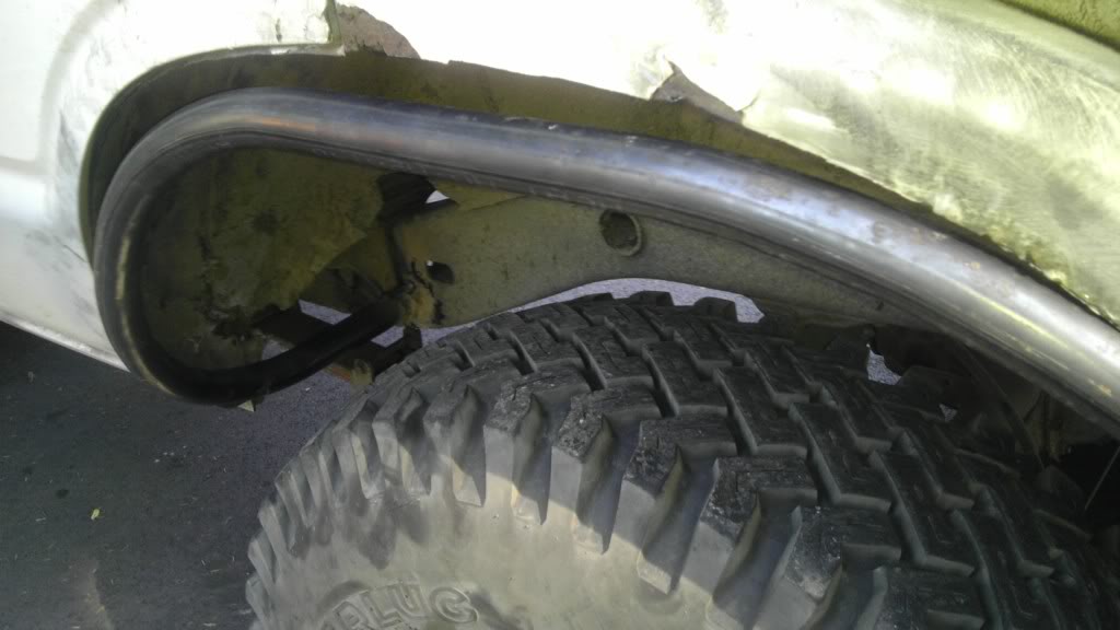

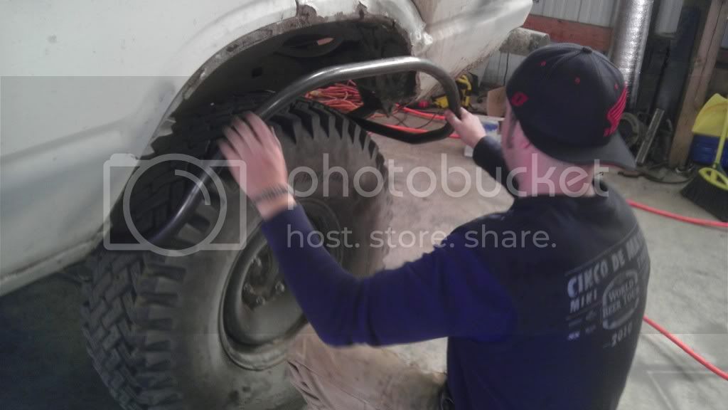

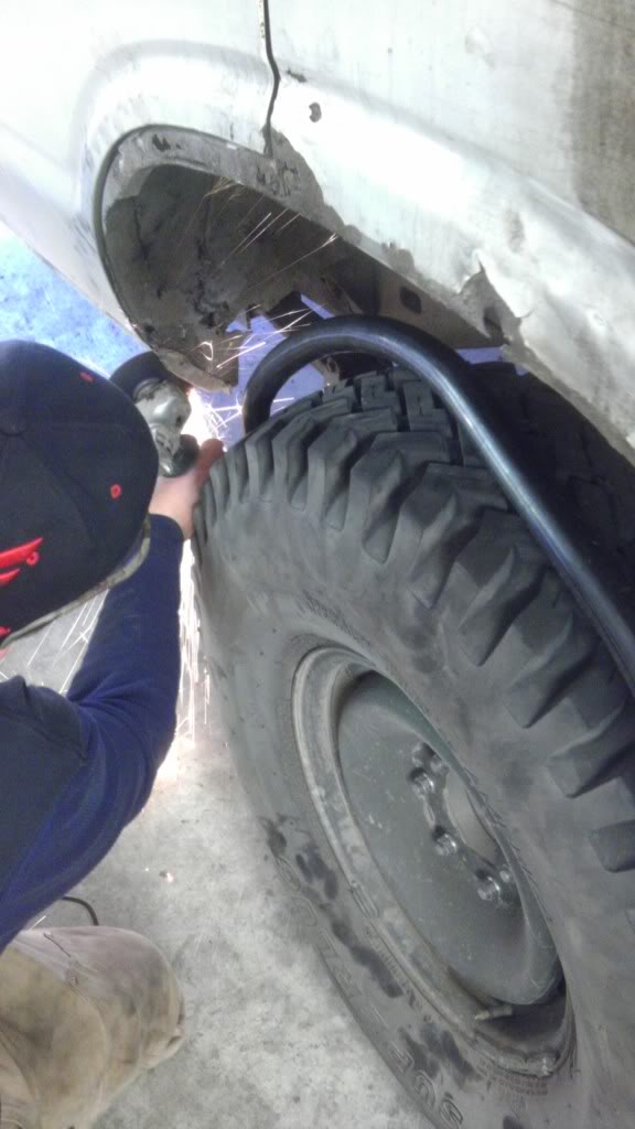

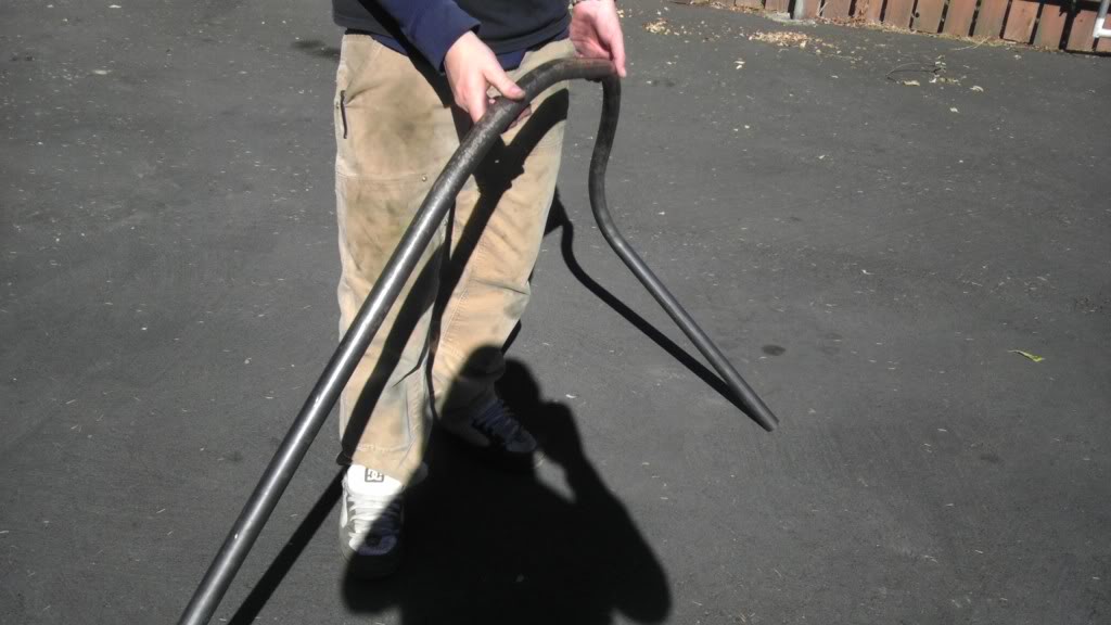

Here we go, I dove into the fenders finally! everything so far went very smooth, got both pieces bent up and one welded on. Tomorrow I am going to try and weld the other up and finish nicks OBA. Sheet metal will have to come at a later date.
Before pic
Pre bent a mock up out of pvc
Starting to look more like a fender!
Next side.
Well those pictures make it look like Nick did all the work! overall I am happy so far it feels incredibly strong and I can always add some support in the middle section like a up side down J

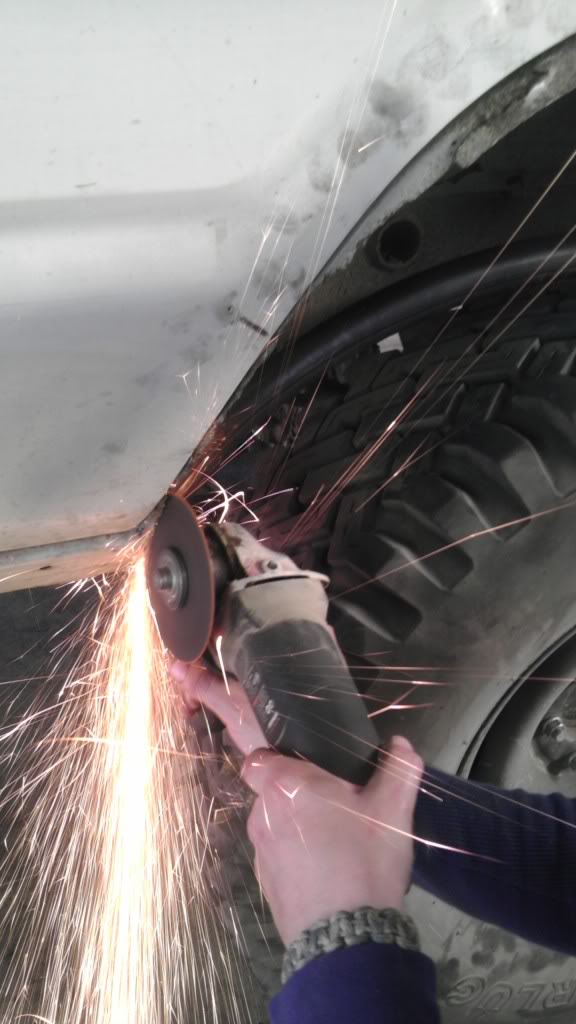

We also cut down my rear rocker panels a few inches.

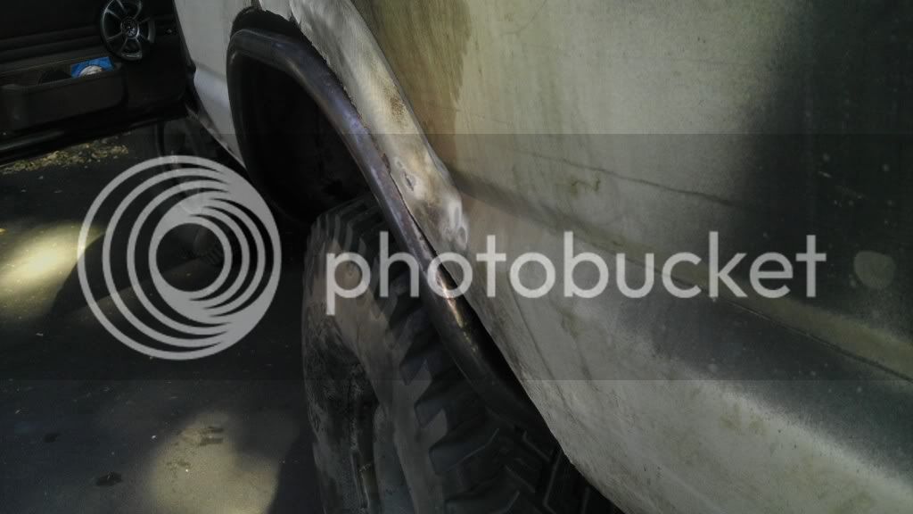

Since those fender bars are welded to the frame are you going to solid mount the body to the frame or is that just temporary until the sheet metal is filled in? If not temporary you'll probably end up with some issues of having the body moving differently than the frame when wheeling.
Damn boots! I didn't even think about that. Probably going to have to solid.mount the rear body mounts I guess. Thanks for bringing that up, maybe I will eked in the sheet metal and take it out after primer and see how it acts. The bars have a slight amount of flex in and out but not up and down... I'll have to think this one through.
Snow you keep adding things to my to do list :beer: what you can do is weld a couple of springs between frame and the tube just make sure it's lighter then the body mount rubber
Springs like so the body doesnt unload on the mounts too far? The body mounts look like they are less then a inch, so I can imagine them compressing more then 1/4" which out at the sides would be more. But how much that can "unload" I have know idea.
Or just some alu or hpe plastic or something body mounts.
I think what I am going to do is this, weld up the other side and before I do the sheet metal work I will mount a camera to the body right at the gape, take her through some twisty's and see how much it moves. Then I will go from there.
Unless any one has some more bright ideas.
I don't think your body will move far what will do damage is vibrations; what I would do is go get some springs from tractor supply or homeshitpo, a chunk of rubber would probably work to just make sure it's as flexible as the body mount.
I see, so springs to the fender bars, or rubber in between the bars and the frame. Got it, I have to experiment on this one.
You guys thing it will crack at the welds over time?
