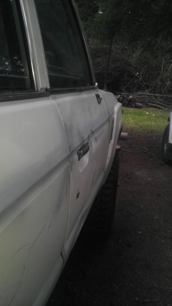

I would keep the fender bars welded on until you fill in the metal for the body work. Once that's filled in I'd cut the lower piece off the frame and back until it looks right/blends in with the body work. Having a tube like that as the fender rim is already going to strengthen the fenders. Frames flex and bodies flex when going over stuff so yes there would probably be damage of some kind if it's left solidly mounted to the frame. Sheet metal work is not the most fun and it'd be sad to see some weld crack or metal wavy after a few wheeling jaunts.
Snow, I'm with Boots. Solid welds to frame and body will eventually fail. So, as he recommended I concur, do the work and then cut the welded areas for flex relief for future FUN!... Gonna be a interesting look.. I'm intrigued with this idea!
J
Well, I may do that but my latest thought is building the fender using the bars as a guide but keep them floating off the body but I am not sure yet. That way I can tie my sliders in.

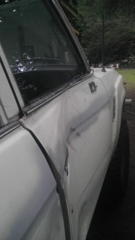

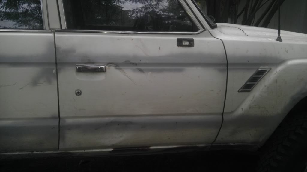

Put a nasty dent in her, YAY! that was fun, only one to make it through that little section of the trail hahaha.
Got some bigger spacers of the rear one, not enough though, going to go 1/2" more. Pounded the dent out (you will have to wait for after shots) fitted a new bosch priming pump, and rotated a spare tire into the mix... wow how lame. I guess I am just getting back into the saddle lol.

You did a heck of a good job on that dent man, good work :cheers:

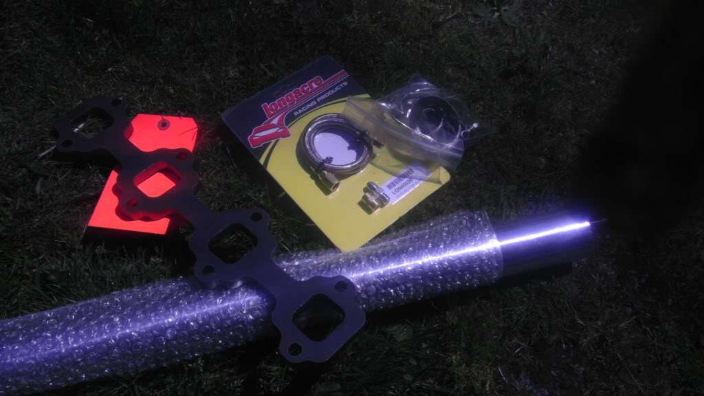

Some goodies came in the mail today! you guys know whats next. I also picked up this bad boy from the laser cutters. All the parts should trickle in throughout this week, I cant wait.
Ah ha ! I smell a turbo !!!!!:bounce2::bounce2:
