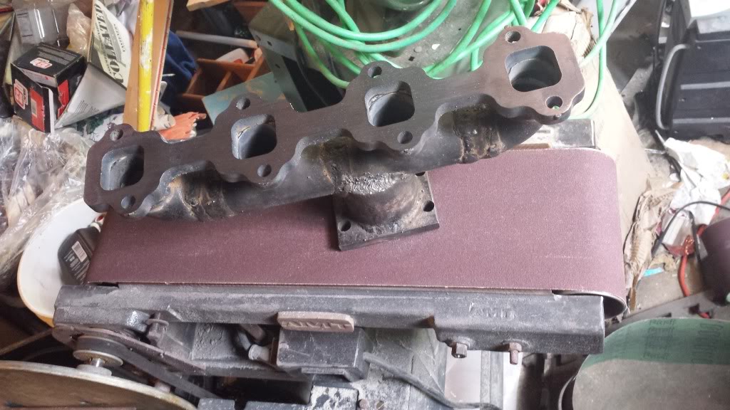

Down pipe, got lucky and didnt have to fab up a flange because the stock one was perfect!

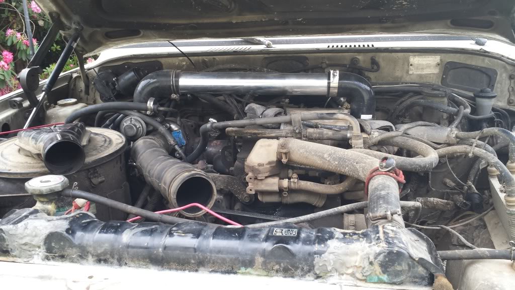

here is a video checking the boost. 1/2 turn on the fuel screw. No egt gauge yet so that's all till the pyro comes in.
Steepest Hill nearby looks like 10 psi at 2k topping at around 12psi
Yah, DDing her ever since, waiting and saving so I can go back through her and fix everything I dont like. Probably next year. Cracked the frame as I mentioned to yah, let people know really strengthen your frame up if you run your spring out there.
All I gotta say is THANK GOD FOR THAT TURBO! We moved up a steep hill but she holds the twisty corners and speed limit in 3rd and usually under 10psi cruise at speeds is around 5psi.
