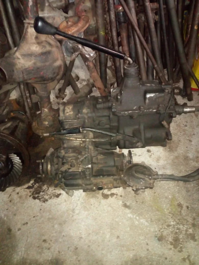

A quick update, picked up a used H55f today and the workshop is busy overhauling the gearbox. Will appreciate if you guys can suggest if I should make any other alterations to the gearing.
Alterations to what gearing? The trans and transfer? Not much you can alter besides a low range kit for the transfer. If you meant the final drive ratio, that’s going to depend on your tire size and anticipated driving style/speed. For example, 3:70’s and bigger tires can make that 90hp engine feel even more sluggish than it already is.
Unless you live in a very flat area, I’d start looking for a turbo if you want to use that 5th gear much.
