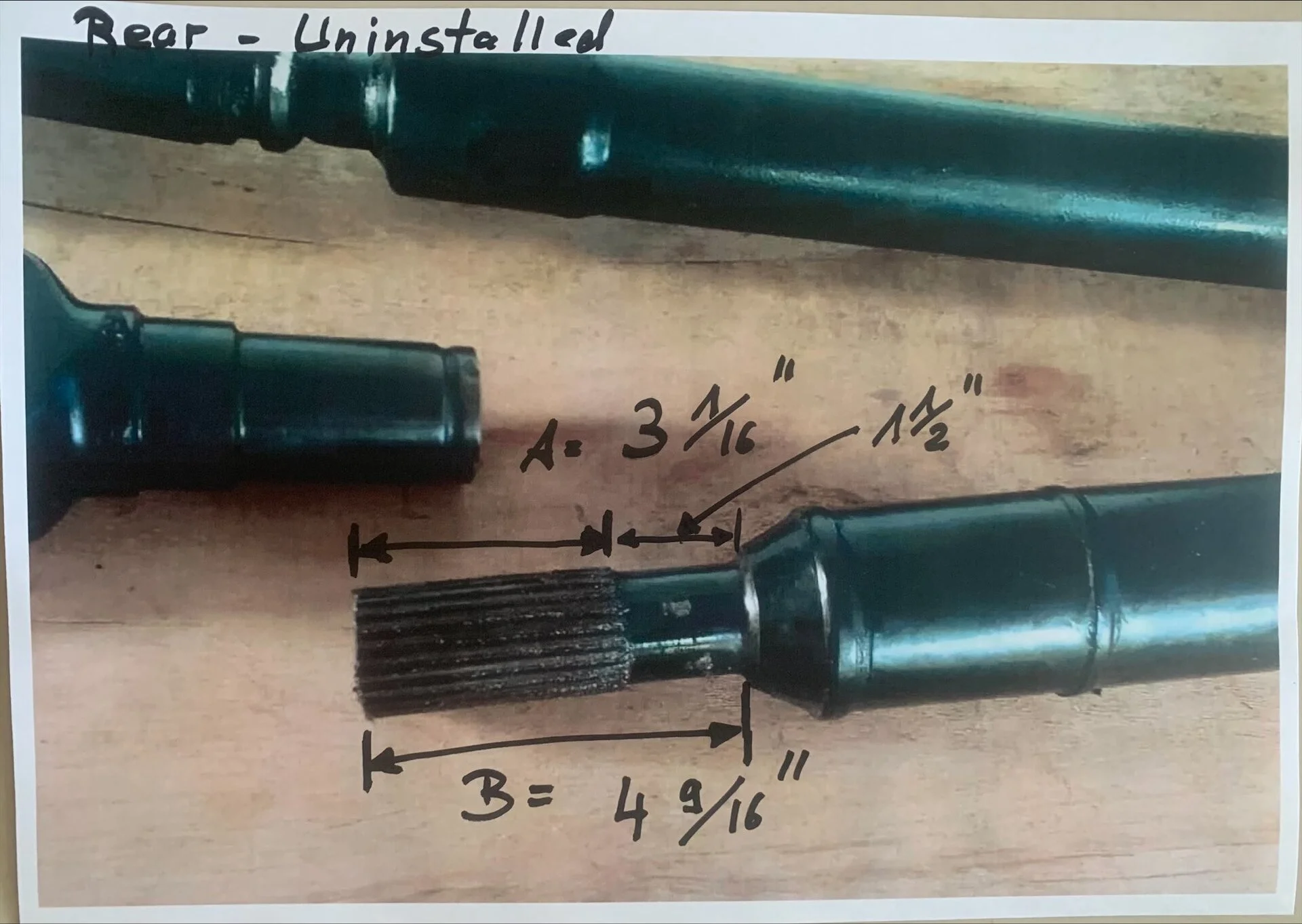

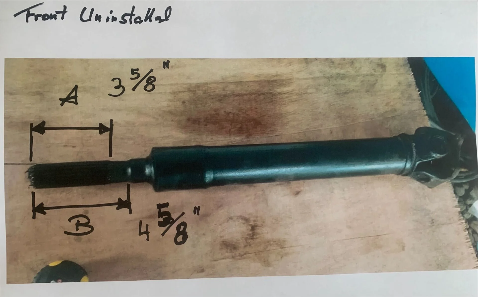

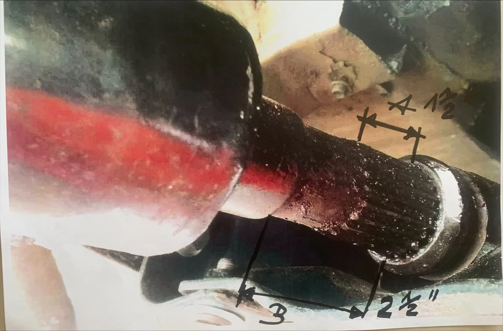

I have attached pictures of the front and rear driveshaft, with the unit with the wheels on level ground, plus the measurements of the splines and shaft ends uninstalled.
My current theory is that the spline should be completely in the other end of the slip yoke so that I would have 1-1/2" of possible "compression" in the rear and 1" of compression in the front before the slip yoke would bind.
