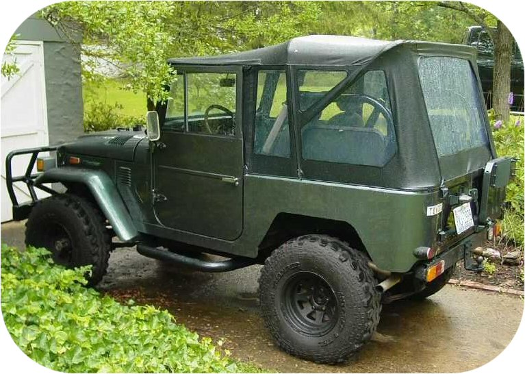

The only option for convertible bows is Bestop. OEM bows do not fold. To remove them, you will need to loosen bolts in 8 locations, remove the pieces over the doors and then lift the B and C pillar hoops as one off the truck. It's a real pain in the ass. I currently run a Trollhole trail cover and just throw it over the bows at night.

1. Rain and dust won't be a problem with either but noise that's another issue. Having owned Kline, Bestop and my tops they all make noise. Probably the least is the 3 ply I sell which has a lot of stretch and absorbs sound. But it's not cheap. Bows and ll will run more than 3k. All convertible 40 tops make noise. Your driving a brick down the road not a BMW.
2. "Top down in a few minutes" Stick with the Bestop. OEM tops were never designed to take on and off in a few minutes. Maybe off but on is a different story. I sell a zipout window model but it's not cheap.
3. If your looking for cost and convenience then there is only one option, Bestop. If your looking for something that makes your cruiser continue to look like a cruiser then go OEM.
