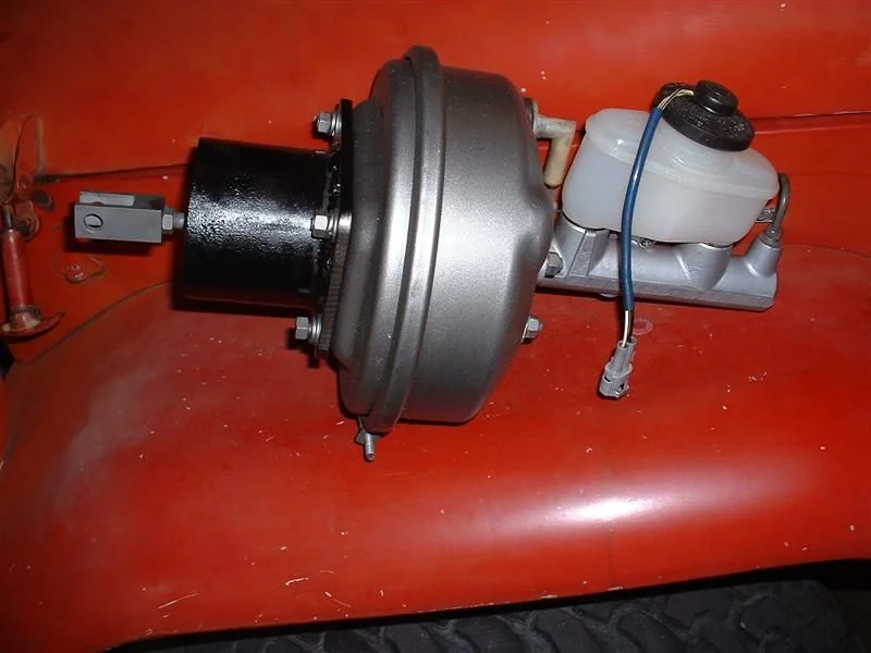

This is my set-up a booster from a 72 FJ40 and M/C from a 90's Toyota Celica Supra and a firewall spacer from JT off-road. Works great for over a year now.

...It seems that when doing 4 wheel disk brake mods there is no consensus on the best master/booster to use....
That is because there is no single BEST way, but MULTIPLE ways of skinning this cat. Or maybe everyone thinks their way is the best. Basd upon personal experience, my advice to you is to use a double diaphram booster and a 1" bore MC from a Toyota or Lexus vehicle with 4WDB. I found this combo from a 92-94 80-series.
There are a multitude of donors that will bolt right up with the required adapter for your firewall (minitruck, 4Runner, 60-series, 80-series, Celica, Supra,......) and many more that can be made to fit with minor to major fab.
Like asking 10 people what is the 'best' food, you will not get a single, definitive answer to your question, at least not here anyway.
I run the master cylinder from a FZJ80 on a booster from a FJ62, attached to a spacer from Mark's Off-road. The booster size could be a clearance problem for you. Run a booster that fits.
