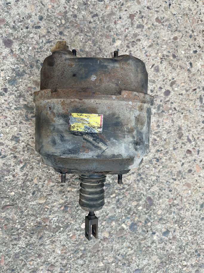

Looks like the generation or two before my old one. Are you running discs in front and drums in back or 4 discs? Either way, this RC Booster will work for you. (There is a different one if you have 4 drums). The bonus is it's more compact and you'll gain some space in your engine bay.
I'm not sure when that booster started. I know my 72 had a smaller one. I’ve seen that booster used from my 75(all drums) to a 78(disc/drum) that I parted out many yrs ago. I think it was used on later models too. I believe rebuild parts are no longer available for them.
thanks ... mine is disks in front and drums in back (The RC team is at CIMA thus closed for the week) So I wait appreciate everyone's help. I'll be back on this site more as I figure out this beast.
