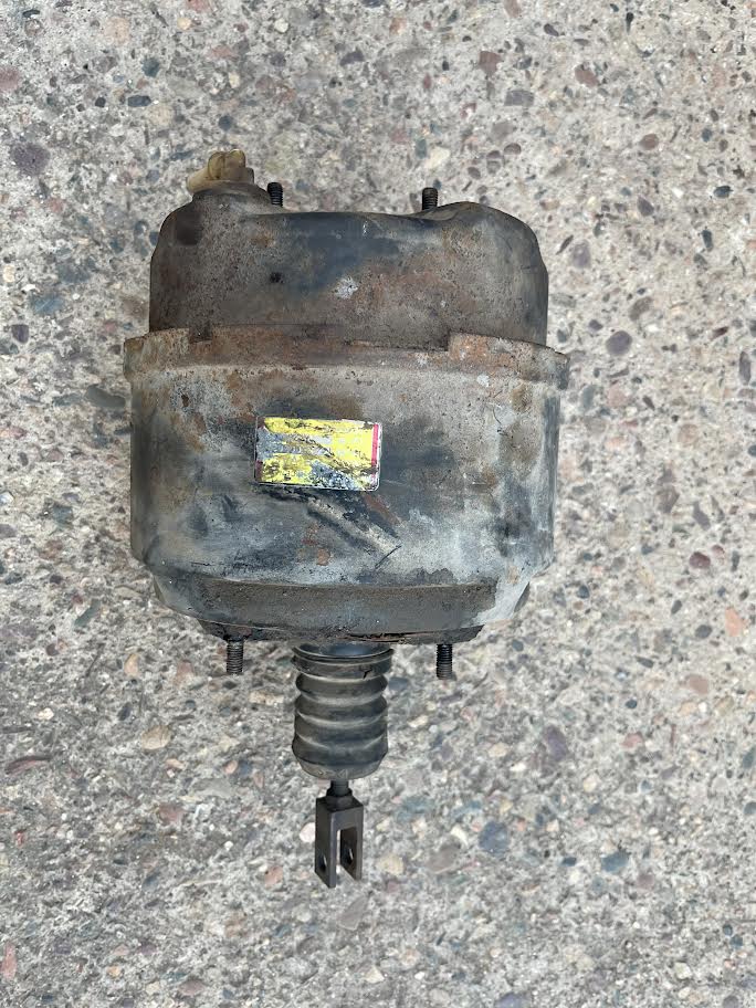

Your booster is nothing more than a really big vacuum canister, it's there to assist in pedal pressure. If it holds manifold vacuum it should be good. The PO of my May of 1975 40 had a stk disc brake frt axle installed and used the stk 1975 drum brake m/c. I drove it for a couple of summers b4 putting it in storage and the brakes worked perfectly. B4 the internet, I installed an FJ40 disc brake frt axle in my 72 40, I had the same result with the drum m/c and 1/2 my brake and bleeding issues went away. In my expeirence, the drum master has a 1" bore and residual valves, the 1976 and later m/c for frt discs have a 7/8" bore and 1 residual valve for the rear drums. I removed the residual valve and installed a proportioning valve when I went to rear disc's & all my brake and bleeding issues went away.

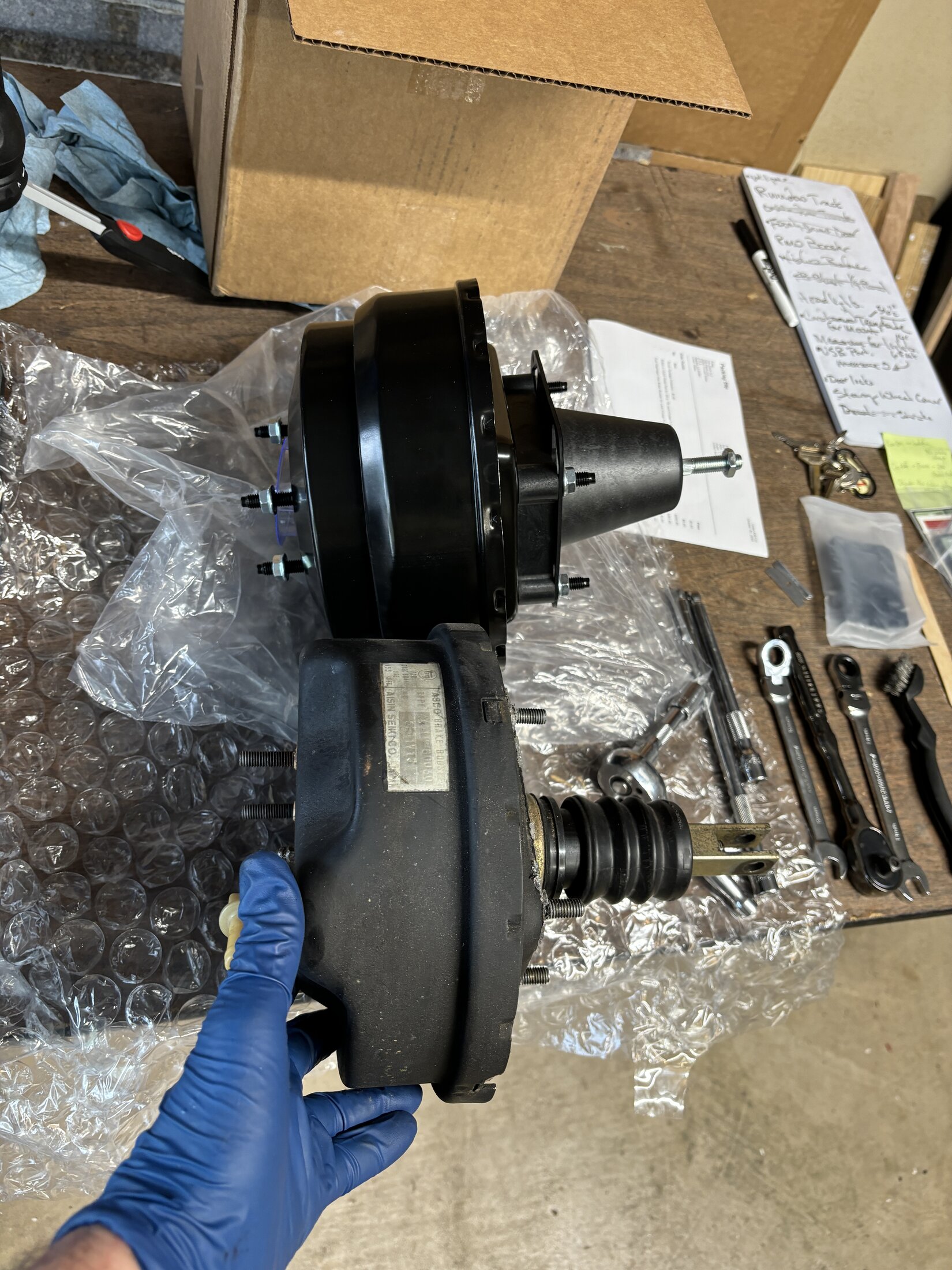

I got my new City Racer Booster and @cruisermatt Aisin Master Cylinder. The booster arrived on Saturday, So, being that I really wanted to know...I installed the new booster with the old Master Cylinder.
Nope. I mean the pedal feels SO MUCH Better, but it didn't solve the problem. (But now the booster passes all the booster tests...)
Bench bled and installed the new Master Cylinder and bled the whole system today. The pedal feels amazing, I could finally hear the rear brakes waking up. After adjusting them tight, pressing the brake pedal a few times, adjusting them tight again, pressing the brake pedal...etc. (Thanks @POTATO LAUNCHER) They grabbed and stopped the wheel!
Took it out for a road test and it stopped at all the right times. I plan to drive it a bit more tomorrow and then back up on jack stands to dial in the drum adjustment. The best part, if you followed me on "I can't drive 55" is the front hubs were still only warm to the touch after 20 minutes of driving 30-60 MPH!! So, the front brakes aren't dragging either!

Bad booster? It seems to hold vacuum. Did you step on the pedal? Usually a bad booster will effect how the engine runs. You said you fix the vacuum line and it idled and ran better.

If one does find a bad booster in a '78 FJ40 where does one find a replacement? I am being told I'll have to find a re-builder and send mine to them... and wait
