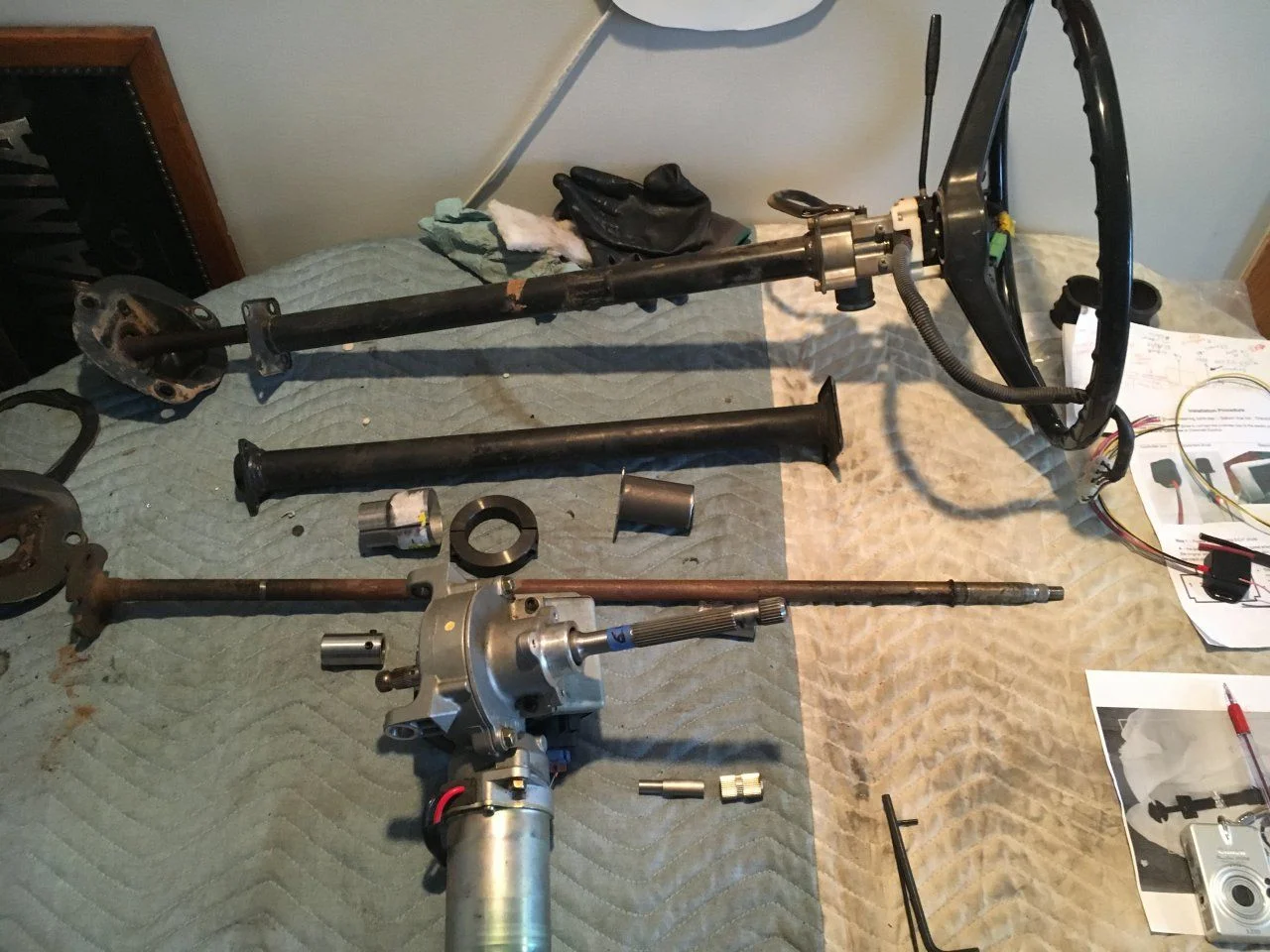

My vote for the electric power steering. I went with the Toyota Archives - Ez Electric Power Steering - https://www.ezpowersteering.com/car-brand/toyota-en-us/ kit with the speed sensitive potentiometer on my ‘75 FJ40.
Easy install and works awesome with existing steering setup.

I just went to the link to check out the electric steering. It looks like it is for '72 and up. Mine is a '71. Would it work? If it matters, instead of using the 3 on the tree I'm converting it to 4 on the floor.

I see that the EZ electric power steering conversion kit is only listed for 1972 and newer. With me changing the shifter to the floor, would the EZ kit work for my 1971 FJ40, or are there other things that would stop it from working?

The electric steering comes completely with a column the just replaced the OEM column. I’ll have to look at both my 65 and 75 fj40 to see if it would work for both older and later models.
Unlikely.....completely different steering column.
Ah! I think I found a solution in one of the threads someone mentioned above. They spoke VERY highly about Ken at ePowerSteering.com and looking at their website they even make kits for those with column shifters (even though I'm removing mine and putting it on the floor), and it's less than half the price.
