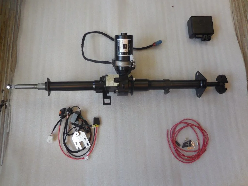

A complete kit to convert your Land Cruiser FJ40 to electric power steering. Developed by EZ Electric Power Steering using components produced by Koyo and NSK, both made in Japan and affiliated with Toyota.
Two kits are available. Both are specifically designed for the Toyota Land Cruiser FJ40. One is for '73 to 8/'80 model years. Another is for '81 to '84. Available for either 12V or 24V vehicles.
Benefits:
  1. Non-intrusive installation. Essentially you replace the steering column with the EZ unit. You retain everything from the manual steering box onward. Works with stock alternator and battery
  2. Complete, self-contained kit. No fabrication, no welding, no chasing down parts in junk yards
  3. Built in safety features
  4. ECU controlled, speed sensitive feedback. Quick response, never any hesitation
  5. Silent operation
  6. Adjust the level of assist with a potentiometer
  7. Proven reliability. No pump, no belt, no hoses, no leaks
  8. In the unlikely event you lose power, you revert back to your original manual steering. In contrast, when traditional hydraulic power steering fails, the car can be difficult to steer

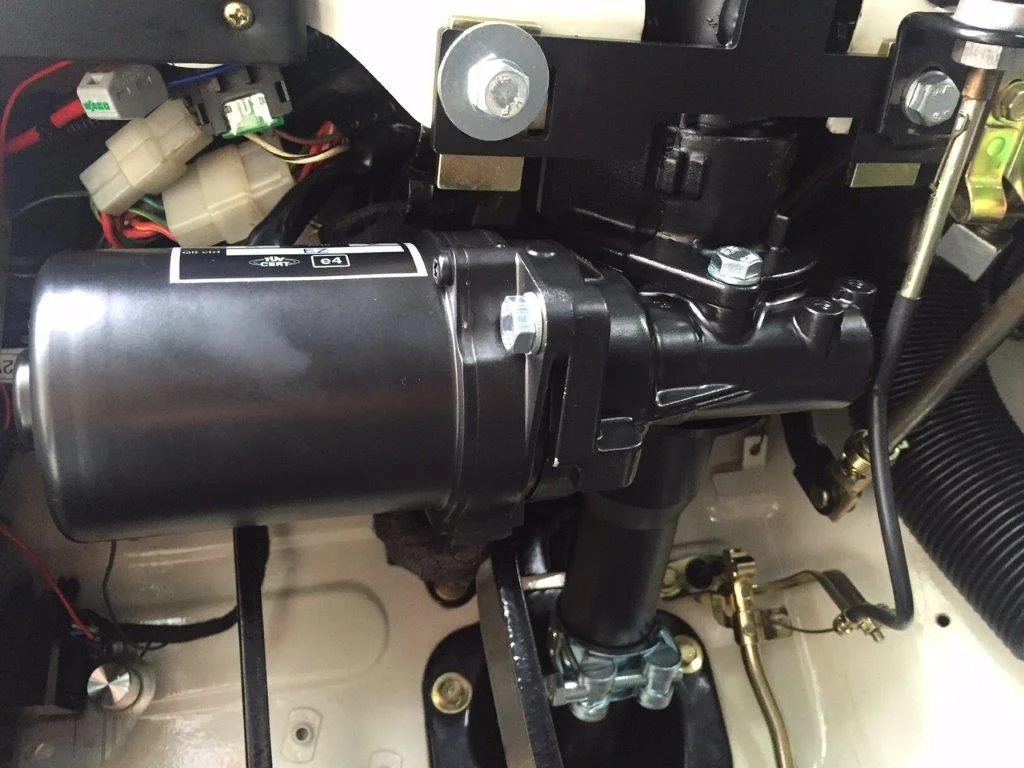

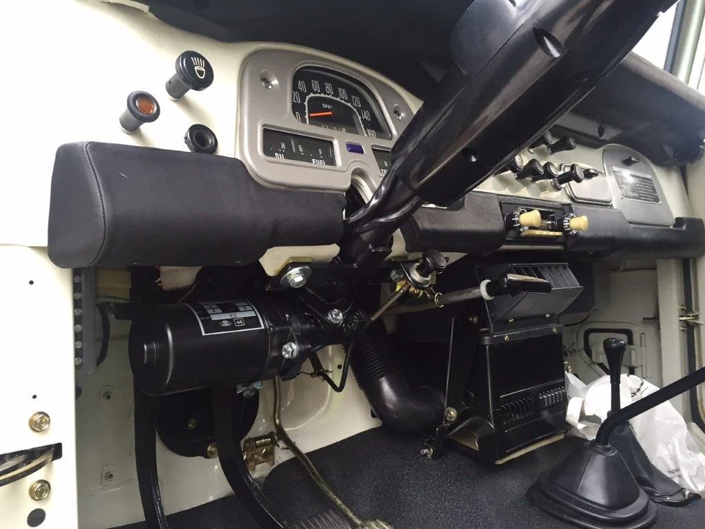

@Racer65, just got my 76 back from the shop and this thing is a game changer. Works like a dream! If anyone in the Bay Area is interested in doing this and doesn't want to do the install themselves, I'm happy to recommend the shop I went to. The tech said the only difficulty was that the instructions are for a non-California 40, meaning no emissions equipment, so working around that stuff was somewhat of a pain.
Super clean looking installation too!
