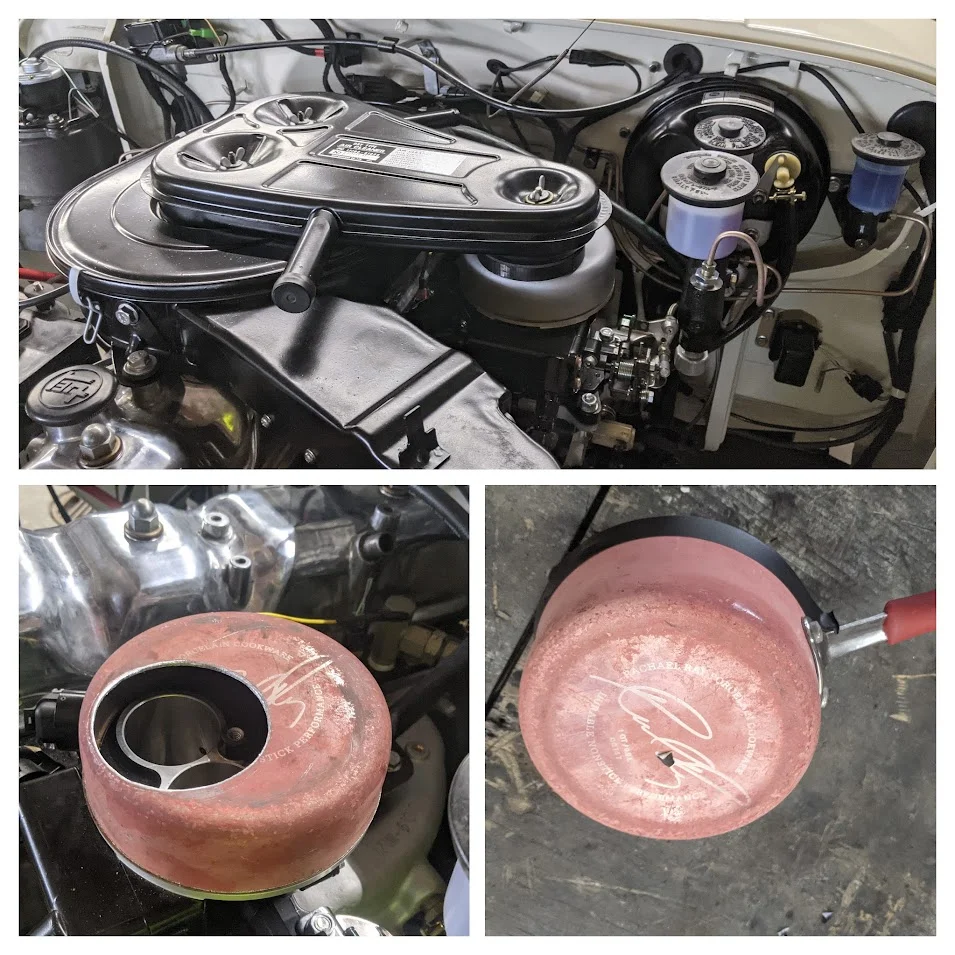

Are there adapters so you can still run the stock air cleaner?
@Aloha Jen Not that you’re asking but I have the Holley EFI from Mosley… I run the stock air cleaner in my 1975 2F. Great little adapter included in the package and every question I had was met with a near immediate reply. Of course,, there’s always @wngrog 😉
There's always a way. I made my Sniper-to-factory-air-cleaner adapter from a thrift shop cooking pot...intakes by Rachel Ray.:rofl:
