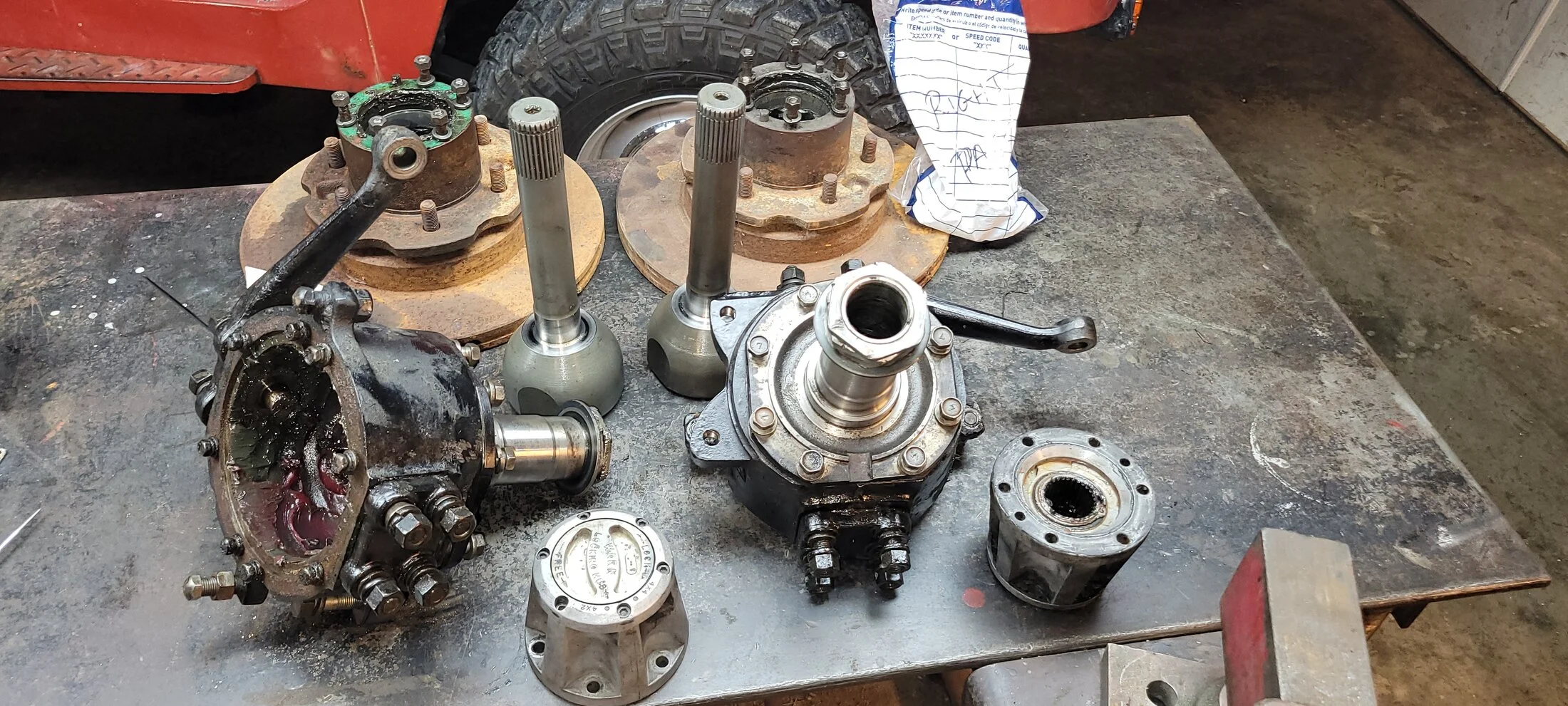

Yes, FJ40 disc brakes started in 76. 76 to 78 they used small pattern knuckles, 79 and later 40s, 60s and mini truck uses larger pattern knuckles. You'll want the fine spline birfs and lockouts too. Or a complete 40 disc frt end. Parts would be something like this.
Well those look very interesting! So, I need to find some of those.... Hmmm....
Even better with aisin locking hubs for 79 and later

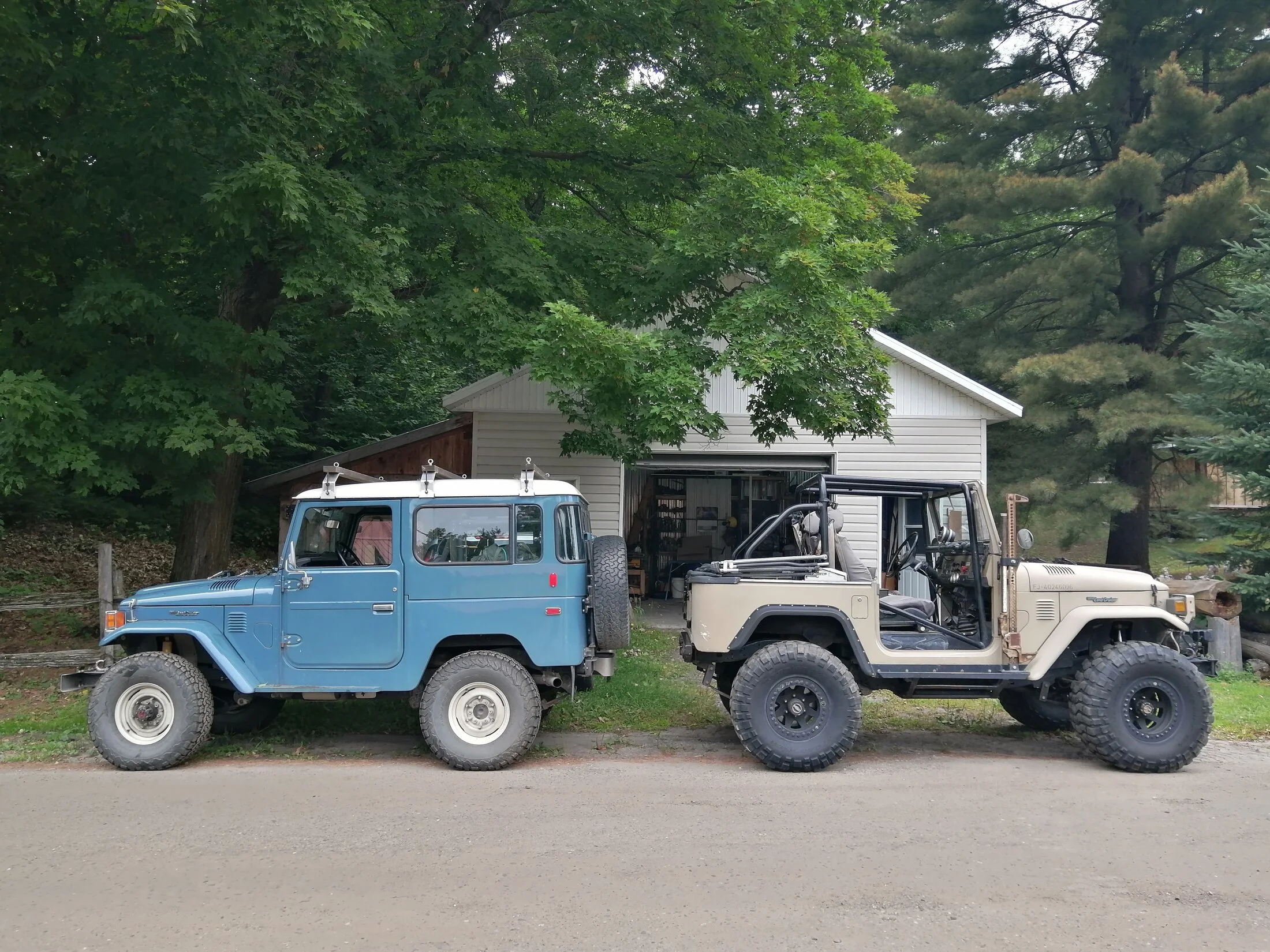

For street driving, closer to stock height is better. I put on the lowest Dobinson springs (Australian company with a distributor in Miami) and 33" tires. I went there from 31" tires. I'm happy with them and would do it again. No hills in FL. You can see the stance in my avatar. 33's are as big as you'd want to go with a mini-power steering setup, tho. Factory springs are NLA.
