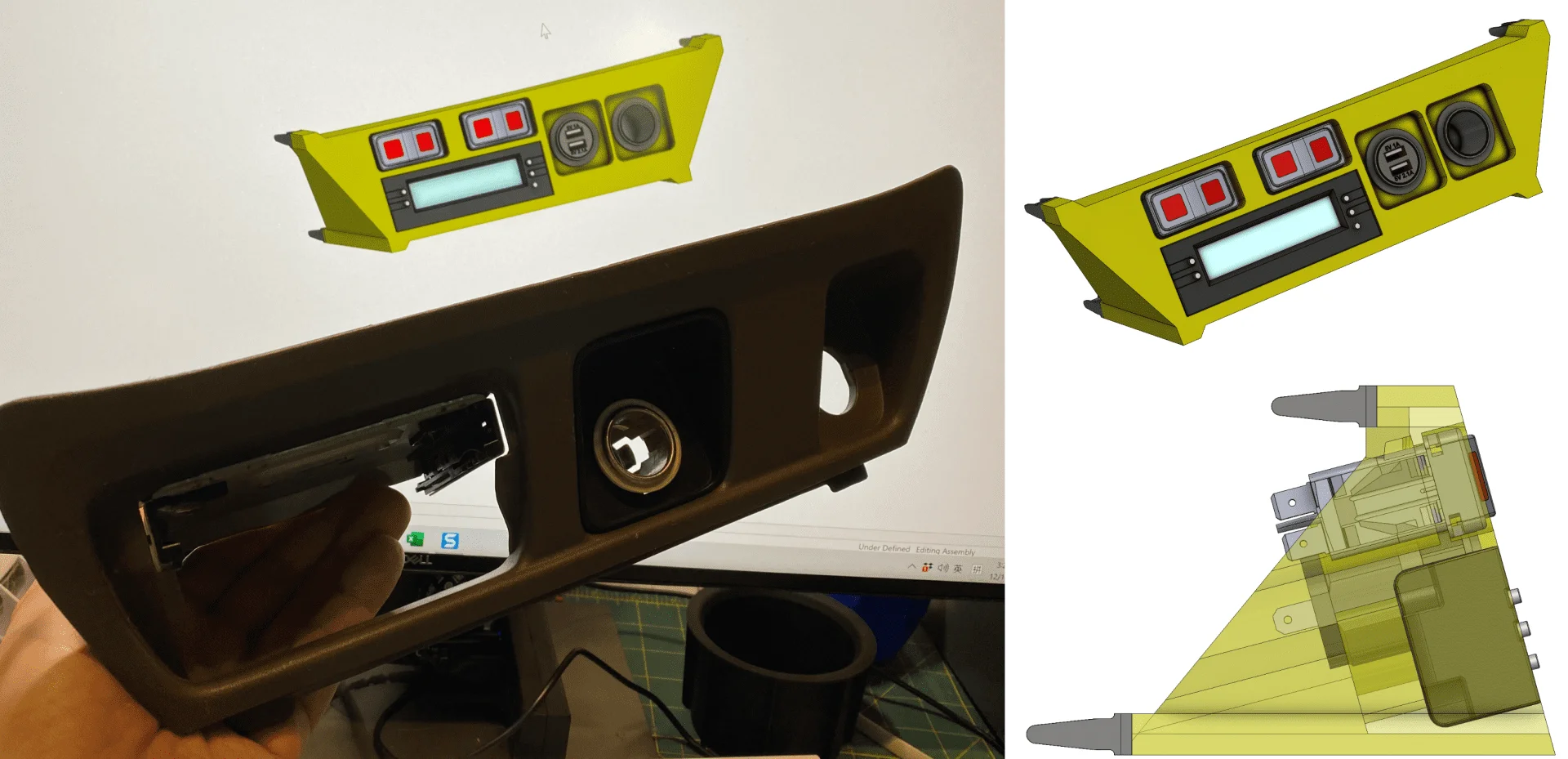

That was a very early prototype. I am open to comments and suggestions. Let me know what you think and what you want to put in there, like switches, gauges?

Could the Scangauge fit in the middle? I have m6v6 for the change pocket and the Ram mount arm would block the view of the Scanguage. Maybe Scanguage in the middle with 1 round socket on each side? Rocker switches could still go above, or below, the Scanguage?? I don't remember what there is for room behind there so it may not work.
Or omit the rocker switch cutouts for those that don't need them. Since the Scanguage is relatively shallow in depth, it could be mounted in any position. Not trying to make it harder, just throwing out ideas. I don't have a need for the rocker switch cutouts so the Scangauge in the middle with one socket on each side would be ideal.
I'd still prefer to see a relocation of the Center Diff and Hazard buttons in the ashtray location

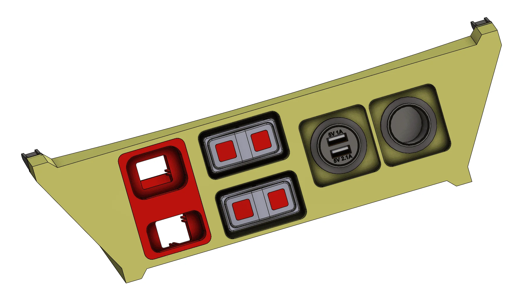

@BenCC I think this is one of those makes where flexibility is key. Personally, I'd like to see a main frame with one or two vertical supports and then a variety of snap-in inserts that can house different items. For me, I'd love the relocated CDL and Hazard switches and then just a series of switch blanks. I can see others wanting maybe a small GMRS radio, brake controller etc. That's kind of a tough spot for the ScanGauge, visibility-wise, IMO.
That looks great, Ben, I think the current design would be a significant upgrade for most folks, and that's a great spot for the scangauge. Is the plan to make it black?
The CAD is only to show the idea. We could have different configurations.
I agree with the modular design. We have two ways to do that. We can either make the part modular as you mentioned or make the CAD modular. I can config the CAD and print a solid and whole part.
Yes that place is also good for brake controller. I have folks requesting that.
A quick mockup to show relocation of CDL and Hazard
