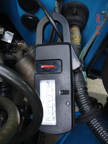

Meanwhile I've tried my clip-on (clamp-on) ammeter but the needle just twitches when my son turns on the glow circuit:
I didn't expect it to work because all the literature that was supplied with this meter related to testing AC circuits (not DC).

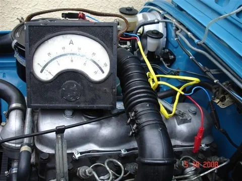

Just for amusement (and because it is dizzling outside and too wet to lift the rocker cover) I rummaged through my junk and found a few other interesting things. (I'm a hoarder from way-back and have always had a fetish for anything that has a "dial and pointer". So I have lots of old clocks, barometers, bla bla bla, and even a few ammeters.)
This ammeter jumped right across the scale:
Not surprising I guess cos I'm sure it's meant for AC only.
And this one did the same:

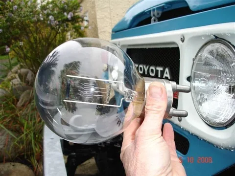

Hey - I bet I would have good headlights if I wired up this 1000 Watt globe!

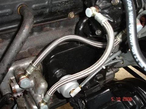

See this pretty braided stainless hose here : (The larger of the two)
It keeps dripping dirty black engine oil on top of my lovely oil filter housing like so:
And that hose is a bit like the "rogue taps" that another age-compromised colleague used to ramble on about. (A rogue tap is one that defies all attempts at stopping it from dripping and shows no sign of any wear /damage that may be causing the drip!)
I have had that hose immersed in water under air pressure and seen no sign whatsoever of bubbles! I've also swapped from copper washers to fibre ones at the banjos in yet another futile attempt at stemming the oil seepage.
So this last week (in desperation) I ordered a complete replacement hose at the huge expense of $61.59 NZ.
(The twisted hose is the old one -or old new-one - that I suspect of leaking.)
All my previous braided stainless hoses from this outfit were made up with teflon inner hose which is pretty stiff and unflexible really. (They reckoned it was the best material back then.)
This time I asked them to get the "same degree of twist" between inlet and outlet banjos (because I remember having quite some difficulty twisting the previous teflon hoses to get them to fit).
Anyway - Now they have mysteriously supplied me a "rubber Auto Flex" inner hose instead of teflon. (Actually feels much better because it flexes far more easily.) And they used the banjos from my sample hose (the original ex-factory Toyota ones) saying they couldn't obtain new ones in that sizing. (Strange! They obtained them OK before?)
Since they destroyed my sample hose - I no longer had a hose to compare the new one against to ensure they got the length and "banjo twist" correct. (Cunning bastards!)
And in case anyone wonders why I PAID to get a replacement hose for one that I suspect of being faulty (rather than asking for a replacement under warranty) - the reason is because I couldn't confirm the leak (with the immersion testing) and therefore I can't garantee that they supplied a faulty product. (Another way of saying this is that "I don't have full confidence in my opinion that their hose is leaking".)
So now the new new-hose is fitted and I've gone back to using copper washers on the banjos. And as I've been typing this - the cruiser's been running in the driveway (annoying the neighbours). - So far there's no sign of any oil weepage but it is very "early days" yet.
Fingers crossed. :D

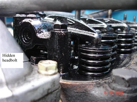

Oh.... By the way..... I forgot to mention that I did have a go at retorquing the 18 headbolts before doing the tappets. (Supposed to work diagonally outwards from the centre as you torque them.)
Trouble is, some of the headbolts are inaccessible without removing the rocker assembly:
So I just set my torque wrench on the max torque setting (120 Newton-metres) and tested those that were accessible:
(PS. - I had to use the other hand for the camera. Normally my other hand would actually sit on top of the torque wrench above the socket.)
Since none of them moved at that torque setting - I figured there was no need to remove my "rocker assembly" and retorque the hidden ones. (But I admit - Those bolts may all be refusing to move simply because they are locked/seized in their threads rather than because they are exerting the correct clamping force on the head.)

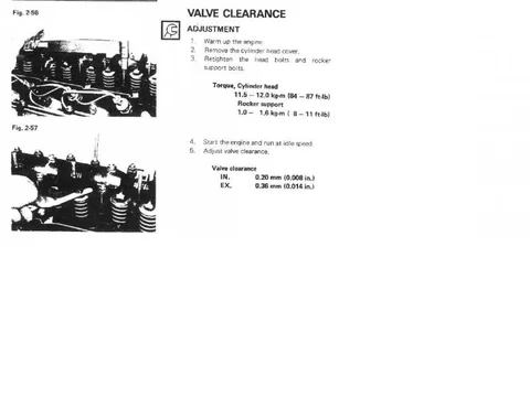

You are supposed to do it with the engine idling, it does not get oil everywhere, it is a hassle and eats up feeler gauges unless you have hardened blades. I did it this way once. Usually I do it like you do - engine warmbut shut off, watch the valves to see when you are on compression stroke and try to find a point where both cam followers seem to be on the bottom of the cam lobes. Doing this at 10,000km intervals seems to be overkill, I usually find nothing needs ot be adjusted. Mind you, I haven't done it for years (200,000km?) so I guess it is time.
I just looked at my 1986 FSM. it has an easier method, engine warmed but stopped. I will scan the page and post it here.
Here is the valve clearance checking page from the March 1986 FSM for B, 3B, 11B,13B, 13B-T engines. Hope this helps.
Wow. That's interesting - Thanks a lot Wayne.
I had actually seen similar stuff in my manual in the section that covers "reassembly" and there they used the word "tentatively".
Here - I'll show you:
So I had assumed (from that word "tentatively") that that method was just a preliminary way of getting the tappets adjusted "more-or-less right" after a head has been completely dismantled/overhauled. (Convenient because you only need to put the crank in two positions in order to set all 8 tappets!) I then thought that once you got the engine completely assembled and running (with the headbolts retorqued)- you adjusted them properly. (IE. using a more accurate method)
But your FSM version refers to "hot clearances" (and an engine isn't hot when it is on the workshop bench).:frown:
:hhmm::hhmm::hhmm:
So what I surmise from all of this is:
  • If my FSM says to adjust the tappets "at idle" then the position of the crank can't be vital. Because all you could do in that situation is see if a feeler gauge is able to slip into a gap "at some point during the camshaft's rotation".
  • All FSM data I've seen talks about setting the tappets on No. 1 cylinder while both its valves are closed and while its piston is at TDC - So this same procedure MUST then also be acceptable with any other cylinder. (The trouble being that you can't easily ascertain TDC in the other cylinders.)
  • I shouldn't really worry about the fact that I can fit a LARGER feeler gauge into a "tappet gap" at some point during the camshaft's rotation other than when both valves are closed on a compression stroke - because this is probably caused by camshaft wear (where a camfollower tends to hit hardest after coming off a lobe)
  • Bearing all of this in mind - the method I used MUST be acceptable. (In my way of thinking!)
Anyway - At present I am fairly confident I have all my tappets adjusted within 1 thou of the 0.008"(inlet) and 0.014"(exhaust) specification using "my chosen method".
PS. I used imperial (inches) because my best set of feeler gauges are calibrated in "old inches".
So if I can get around to it - I'll also try and see what size feelers are able to fit into the specified tappets in those 2 crank positions (as an experiment).
I'd also like to experiment with seeing the differences between "hot" and "cold" measurements (to see if there really is a difference).
And - thinking about it - I accept that if I were to adjust my tappets at idle - most of that dirty black oil should still run down into the crankcase rather that run elsewhere........ Except I'd have to park on more level ground and NOT in my sloping driveway. (But I'm still NOT going to do it.)

i have yet to see someone set the valves ona running engine.
you bring the engine up to operating temp, shut it down and adjust the valves...
