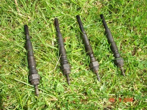

Here's all the ND plugs removed. One reason I wanted to replace them (apart from the "routine maintenance" reason) was because they were accidentally left energised for at least 20 minutes (probably way longer) while I had the steering column dismantled (which caused the ignition switch to stay in the glow position). I noticed my mistake only by smelling the burning smell coming from the baking of the dash paint around the glow controller! But they don't seem to have suffered any harm from their experience:

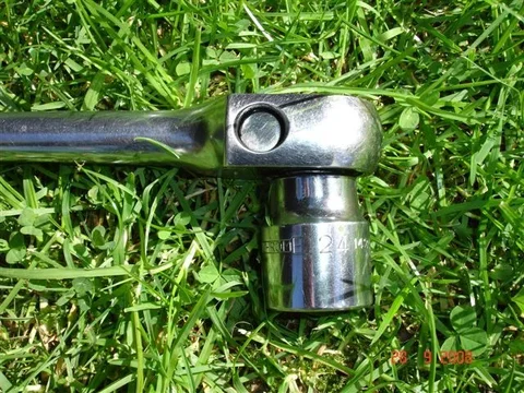

And here are the new plugs getting torqued down.
I couldn't find any torque specs in the FSM so 10 N-m (90 inch-lb) seemed reasonable - Accomplished with just one finger on this little torque wrench:

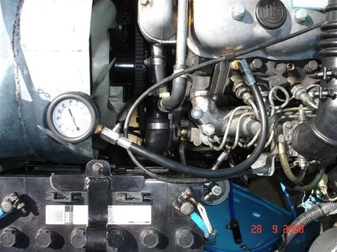

Well I did "compression testing" on all cylinders today too. And I looked at doing "leakage testing" - but predictably - I ran into problems there.

Right so all glowplugs are removed. And I've unplugged the EDIC here (to avoid the cylinder that I'm testing from "firing" and blowing my gauge to bits):
Note that the manual shows only one connector being opened. since I found 2 connectors I disconnected them both.

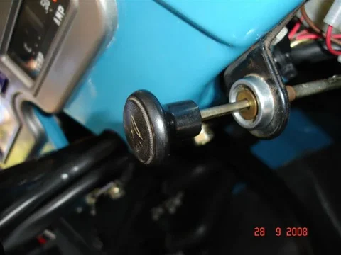

And here is the hand throttle being used to hold the intake manifold butterfly valve open:

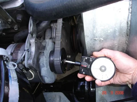

:hhmm: Now - I don't have a tacho so I gotta measure cranking rpm some other way. ---- Lucky I've got a lot of old gear.
Here's me measuring the cranking rpm of the alternator pulley:
Now the crank pulley rpm will be inversely proportional to the ratio of the PCDs (pitch circle diameters) of the alternator pulley and crank pulley.
And the PCD ratio is near-enough the same as the outside diameter ratio -- which I can easily measure with a super-large set of outside-callipers that I have.
Alternator pulley: 82mm Crank pulley: 145mm
Measured alternator rpm = 420
So my cranking rpm = 420 x 82 = 237.5 rpm
................................. 145
:hhmm:... I thought I might exceed 250 because my starter and battery are in good nick and without the glowplugs she sure whizzes over!
Right the engine is hot - after a good run, all glowplugs are removed, EDIC is immobilised, hand throttle is open, son sitting in driver's seat - key in hand (wishing he was back inside the house listening to "death metal" on his ipod or persecuting the neighbours with his drumming practice routine)................
Now the info sheet supplied with my compression gauge says that you record each reading after 8 revolutions (or something like that) ------- What a load of dribble IMO.
I recorded each readings after the gauge appeared to settle and looked like it wouldn't go higher (which was probably around 8 compression strokes on that cylinder):
My results were.....................

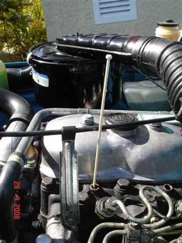

I subconsciously thought I could do what I've always done to get a piston at TDC (top dead centre)...... Put the plastic knitting needle in the sparkplug/glowplug hole trick to "feel" when the piston is at the top of a compression stroke. Like this:
While I turn the crankshaft (glowplugs removed and gearbox in neutral) using a ratchet and 24mm socket on the crank pulley nut:
But this FSM picture shows the precombustion chambers block the knitting needle's access.
(:hhmm:Wonder if Mum will notice her knitting needle is a bit scratched and greasy now?)

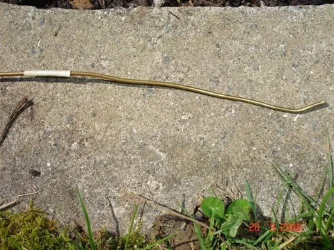

So the next brilliant idea was to introduce a "technical bend" to a bit of bronze welding wire so it is able to pass through the holes in the precups --- and thus allow me to "feel" the top of a piston:
But yep.......... Dismal failure also.:mad:

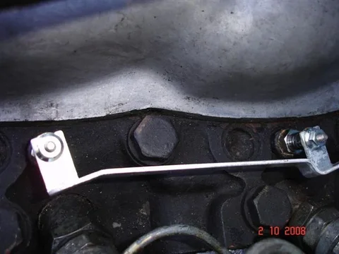

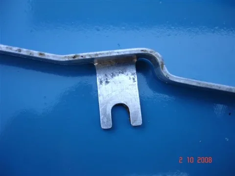

Here's a busbar connection:
And here it is after the busbar has been cleaned up:
And here is the whole busbar cleaned. (It is in perfect condition.):
This is how each of my HKT plugs are supplied:

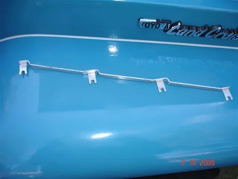

I decided to fit the "washered nuts" (inverted) from the old Nippondenso plugs to enlarge the electrical contact area for the connections - which I believe to be important because the terminals of the substitute plugs (that I am forced to buy now) have a smaller thread-size than the busbar was designed for:
And here is how the busbar sits now:
