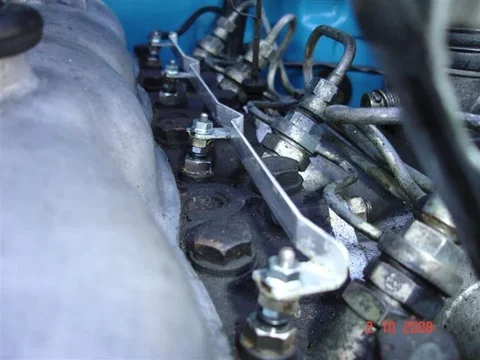

And here is the whole busbar reinstalled:

Now for the performance of the new plugs:
First the ambient temperature for this latest test was 1/2 oC warmer than before (13 1/2 oC or 56 oF instead of 13 oC). And these were the results (with the former figures for the old ND plugs in brackets):
It took 13 sec (15 sec) till I could see some sign of glow in the glow controller and 25 sec (30 sec) before "full glow" was achieved.------- Slightly shorter I think - but that could just be my imagination because my judgement of "glow" is entirely "subjective".
Voltage at G: 10.9V (10.4)
Between G and S: 2.3V (2.4)
At S: 8.6V (8.4)

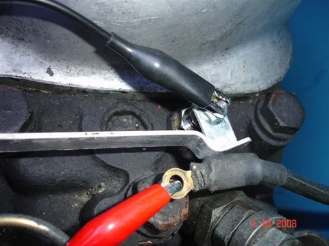

Here's how I connected the meter into the glow circuit:
And here is the meter itself:
I got my son to turn the key backwards and then I "briefly touched" the "final connection" to make the glow current flow.
Result ---------
Yep - The meter wants to go "way past full scale".
And my estimate - based on the sound of the spark and on the needle's rate of acceleration across the dial - is that we have probably around 30 A here.
(I did this little test twice - Each time making sure the connection duration was minimal (insufficient to damage the meter).
