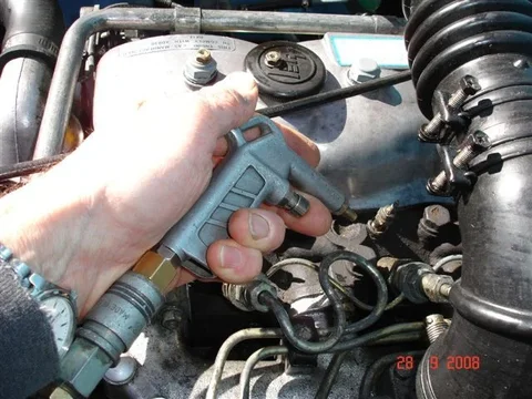

So I've started by getting the gear ready to do the compression and leakage testing.
I'd like to thank Amaurer for his thread that got me interested in the HarborFreight (made-in-China) stuff. I landed both their compression tester and leakage tester here in NZ (I seem to remember I ordered it from California) for just $150NZ while an inferior leakage testing set by itself (which appears to be made by the same Chinese manufacturer but without a branding name) retails here for $300!
The HarborFreight gear is not anywhere near the standard of the "Snap-On" brand but I could never justify buying that. (About $800NZ for the leakage tester alone?) And I believe the HF gear will be entirely adequate (read "accurate enough") for the limited use it will get from me and probably better than the average standard of most tools/equipment sold in this country (where you have to really search to find quality). Crikey - I'll probably use it only this once!

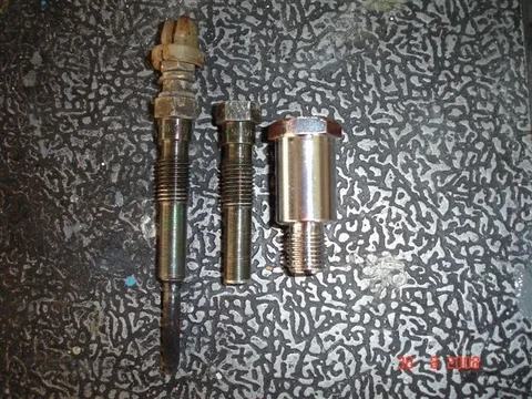

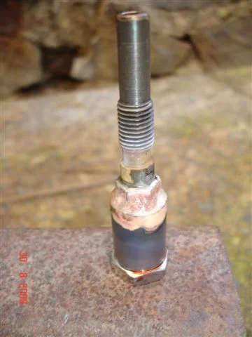

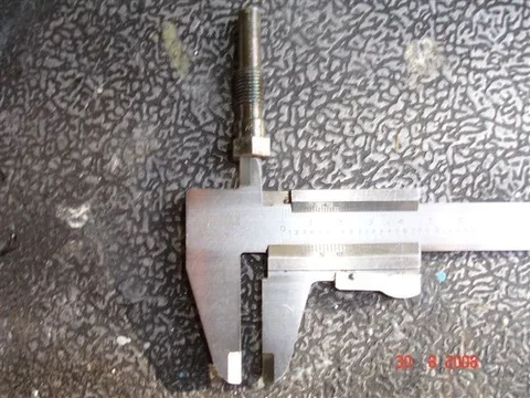

And here is the compression tester (The fitting with the blue zip-tie is the one that matches my glowplug sizing):

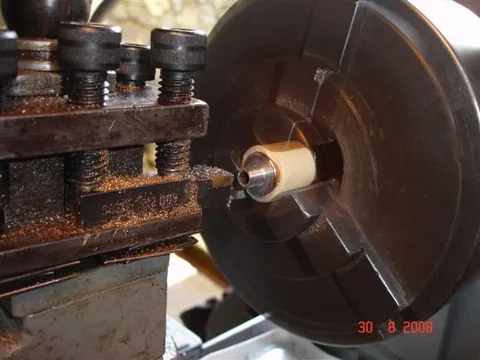

's car. (Hey - I wonder when I last changed those plugs?) This enabled me to choose the smaller fitting on the left (with the O-ring removed) for "bastardisation". (It is not really logical though - because I doubt I'll ever bother doing a leakage test on her car with the other fitting

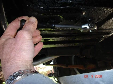

. So I've been meaning to remove the drain plug on the fuel tank (which I do periodically) to drain any cr#p out.
